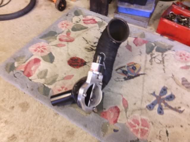

U guys make this exhaust stuff too complicated. 3 feet of 4" pipe, 4" cutout, 2" kickout. Done! Even with no muffler the 2" restriction makes the whole 4: DP work as a muffler. Quiet enough to talk on the phone with dump closed. I added a 2" tractor muffler just for kicks. It sounds like factory exhaust.

Force does the cut-out seal-up good? They kinda pricey and I'd be pissed if if wouldnt close up tight and sound like an exhaust leak.

A lot depends on how well you take care of it, but so far so good. They seal up pretty well. That ones about a year old. BadlanzeHPE is the brand. I’ve had good luck with them over the years. You can buy replacement motors and the owner is great about warranty work.
Here’s a sound clip on my DD turbo Lexus. 3” DP to 4” cutout. Then to factory 4 muffler cat back system. OEM noise levels with the dump closed.
