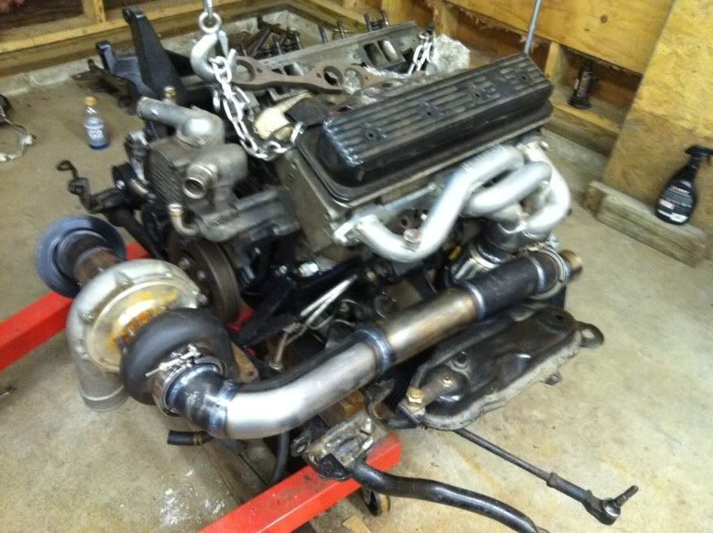

Its tough cause of the packaging.
I am thinking its that stupid *** flex joint cause the downpipe is a solid pipe and its def making noise from that sector.
Old Apr 27, 2015 | 11:06 AM
mistafosta's Avatar
iTrader: (9)
Joined: Sep 2008
Posts: 176
As I was looking at that picture I was thinking the same exact thing in my head. Sometimes if its been leaking a little while you can see soot around the leak on those
