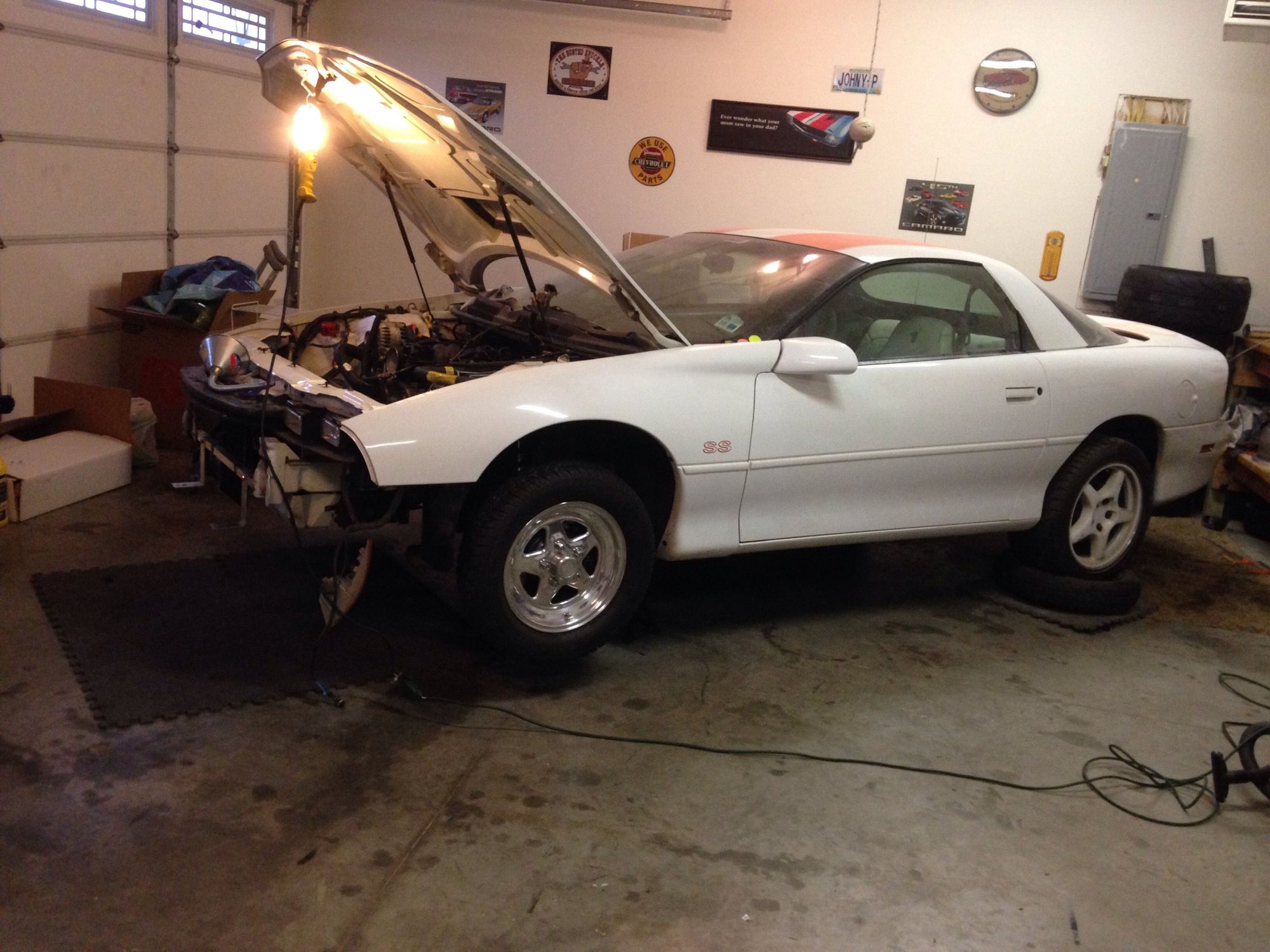

I'll start it tomorrow after I wire in the wideband. I cranked the engine without spark to prime the turbo tonight and found my return to be leaking a little. It's my fault because I had the welder put the fitting in a bad place where the 90' fitting hits the MWC k member. At least the gauges look okay! Ill post a video tomorrow.

I started the car tonight. It fired up on the first try. I wired my wideband gauge to the light cluster and forgot to turn them on for the first video, so I made a 2nd. I don't have the charge piping/intercooler on, but I did cut it to fit before pulling everything so it should go back on without any issues. I really wanted to see if my oil return line was going to leak and it appears to be leak free, although the oil didn't get very hot yet. I also don't have any of my vacuum lines ran so my vacuum block is acting as another intake....lol.
The downpipe is only 15" long or so because it hits my MWC k-member. Ill drive it to the exhaust shop on friday for a quote to run it up to my catback.
I'm very happy it started up and seemed to idle okay!!
