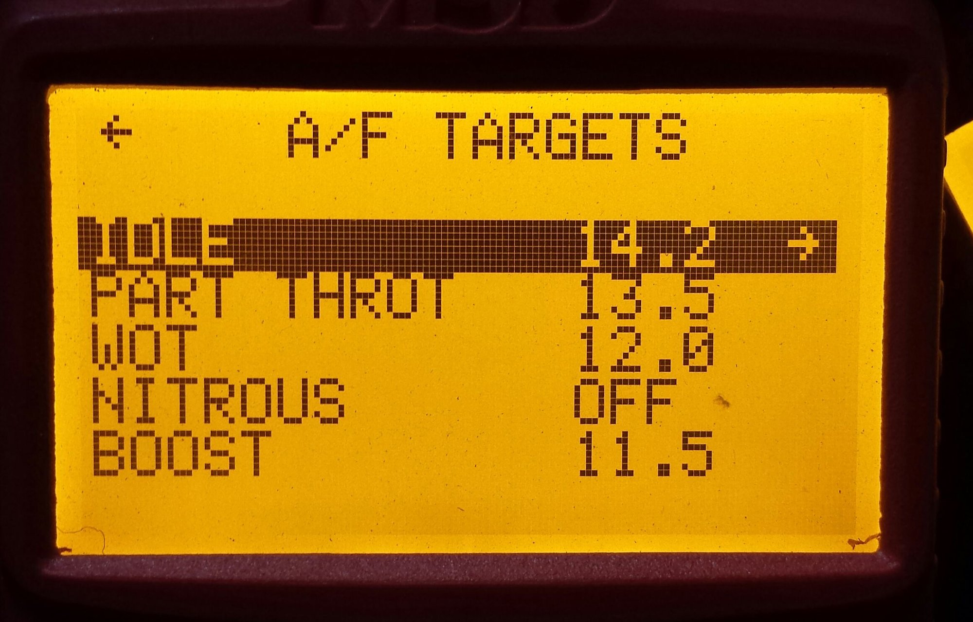

My AFR settings....

Gasoline. Don't idle alot, just a warm up and go. Those were new. Probably 25-30 miles. Cruising, wot pulls, pretty much everything. AFR on wideband is dead on for whats being commanded. I figured with a cruise of 13.5-7 it woulda been more tan.

I cruise my car at 15:1. Why are you running yours so rich?
Richer= safer while i get this new combo sorted out.
Not the case with low load situations. (cruise/idle) 14.7 should give you the most complete burn and should always be targeted. Some find slightly leaner nets better MPG. Either way you won't hurt it.

OK, I'll change it to 14.7 idle 14.5 cruise sound good?

With some setups (usually CARB stuff) you may not get some popping and misfire at 14.7ish idle. So you’ll have to run it slightly richer. You want it as close to 14.7 as you can get while still maintaining a decent idle. Same with cruise IMO. You can go even leaner at cruise, bottom line is you won’t hurt it.
Some claim 15-16:1 is better at cruise. While that sounds better, usually it results in less power being extracted from each ignition event. IMO There’s a reason OEM stuff targets 14.7 all the time. Just have to play with it and see what works best for you. Leaner the AFR the less “soot” you’ll have on your base ring though. You’ll probably see your brownish plugs then.
