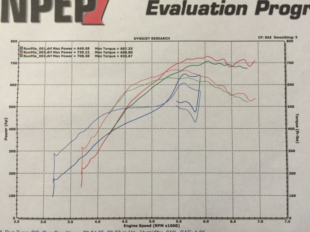

Posted in my build thread but I figured Id put it on here too
Went to a dyno day and made 3 pulls on a local dynojet
At 18 psi it made 730/669
Unlocked converter with the shitty China airfilters on
The first pull I made at 14psi and the tires spun pretty bad and the graph looks terrible...lol
The next pull was at 17psi and it made 708/632
On the third pull I bumped the duty cycle up quite a bit, but it only made 1 more psi and hit 730/669
There were quite a few turbo cars there that we're having trouble getting enough load to the turbos, it usually make 19+ psi on the street and made less than that at more duty cycle.
A friends forged 6.0 billet s480 fox body made 830 at 20psi and a locked converter right after I got off. It's made over 900 on another dyno here so I know this one isn't too optimistic lol
I'm pretty happy with the numbers considering how simple my setup is.
After looking at the graph you can see what I think is the filters start to choke the turbos, I'm planning on yanking them off at the track this weekend and seeing how big of an improvement it is.
