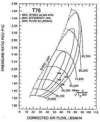

Anyone know the max lb/hr this turbo will do? I can't find a flow chart

That's what I figured but no chance of finding a cfm?

I spoke with the guys at forcedinductions.com about this years ago and they basically said you could ballpark it if you took a standard 76mm turbo compressor map and shifted the graph 10lb/min to the right since it flowed more.

Any rough idea on what it may flow?
Just trying to compare its potential to an F1a
Take the below image from their site and move the island 10 lb/min to the right. Then you'll have an idea based on how much boost you want to run and your NA air consumption.

So basically max 103 lbs/min, or about 1400 cfm.
Looks like an f1a will out do me
