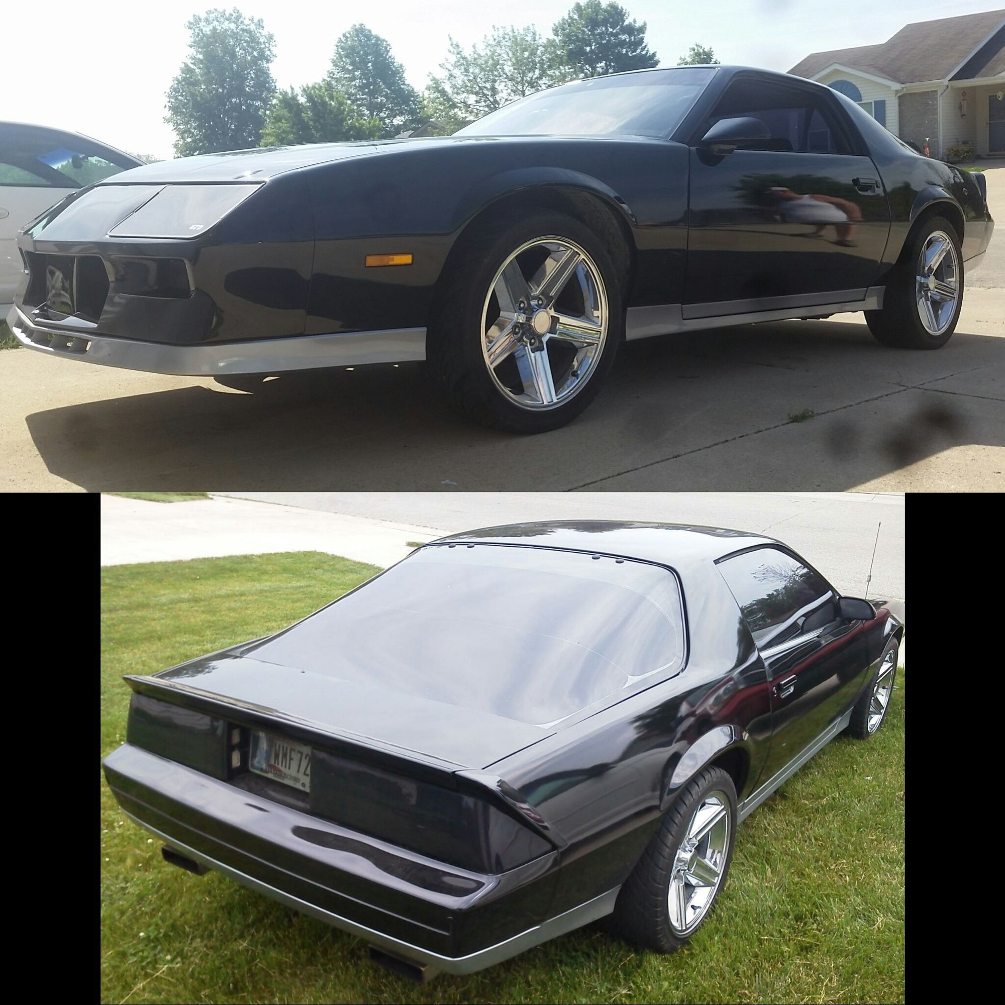

It can be done. I have maybe 7k into mine but went overkill on some things plus $1500 of that is in gauges etc.
2005 5.3L (wired myself stock PCM, borrowed efilive)
Corvette accessories
LS6 cam
BTR dual springs
LS1 intake
LS1 oil pan
80# seimens
walbro 450 pump
Fresh rebuilt 4l80e
HD2 shift kit
Billet triple disk converter and tci flexplate
Turbo setup built myself
Flipped and modified truck manifolds
2.25" 14awg mild steel (twin scroll)
2- Tial 38mm MV-S gates
Ebay GT45
Jodar 50mm BOV (race parts solutions)
Ebay 4" intercooler
Ebay Intercooler Piping

Thanks for your help man. What did you do exhaust and o2 sensors wise? ? I have a set of lq4 manifolds would that be better? I got so many questions for you haha nice car btw!
