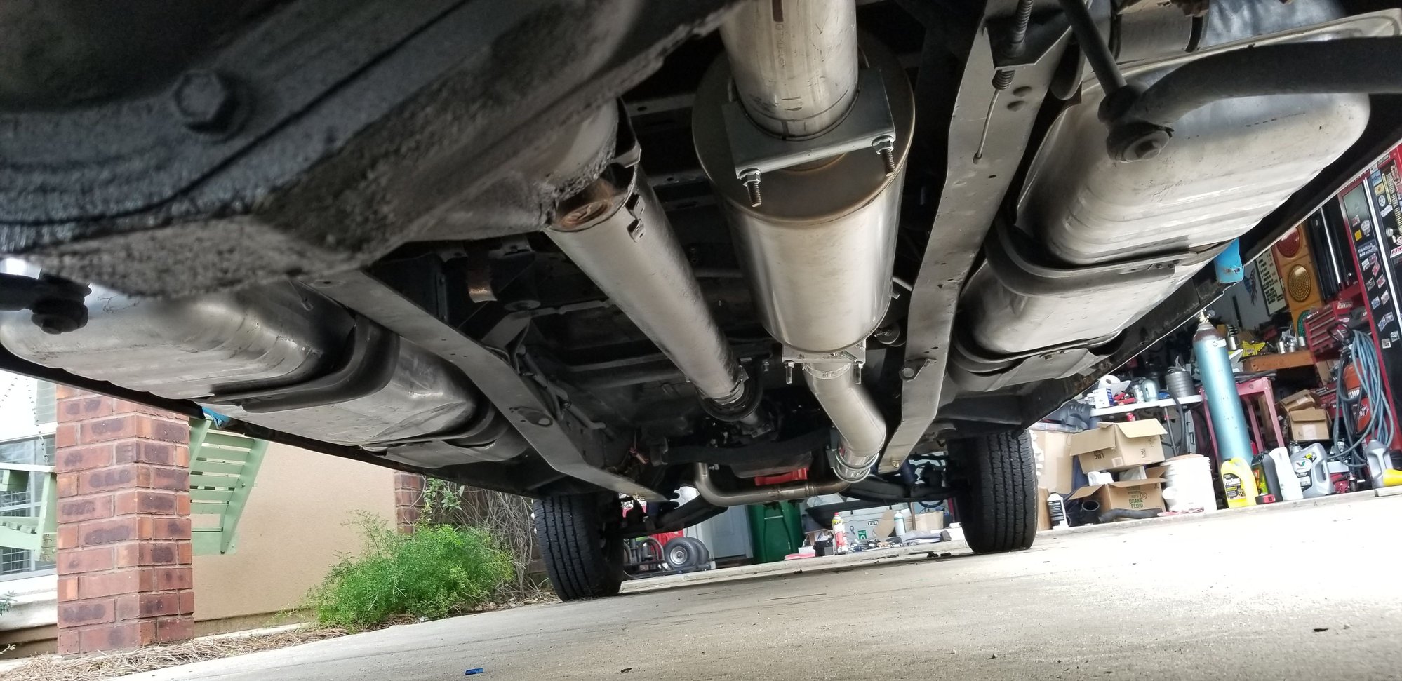

I'll post what I have. It's an On3 performance kit originally for a '99-06 Silverado. Using Tejas Steelworks mounts moved the motor up and forward enough that the crossover flange on the PS cleared the frame. I fabbed the crossover and downpipe.
Thats the DP that comes with the On3 performance kit. Obviously I cut it up.
4" SS exhaust (originally for a 1st Gen Cummins Dodge)
4" DP" />
3" --> 4" DP

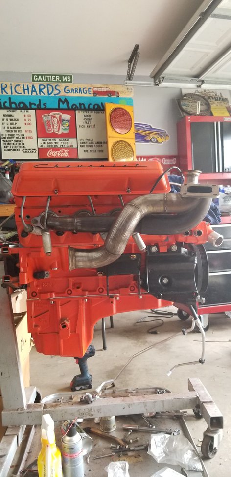

You can see the WG piping in this pic.
