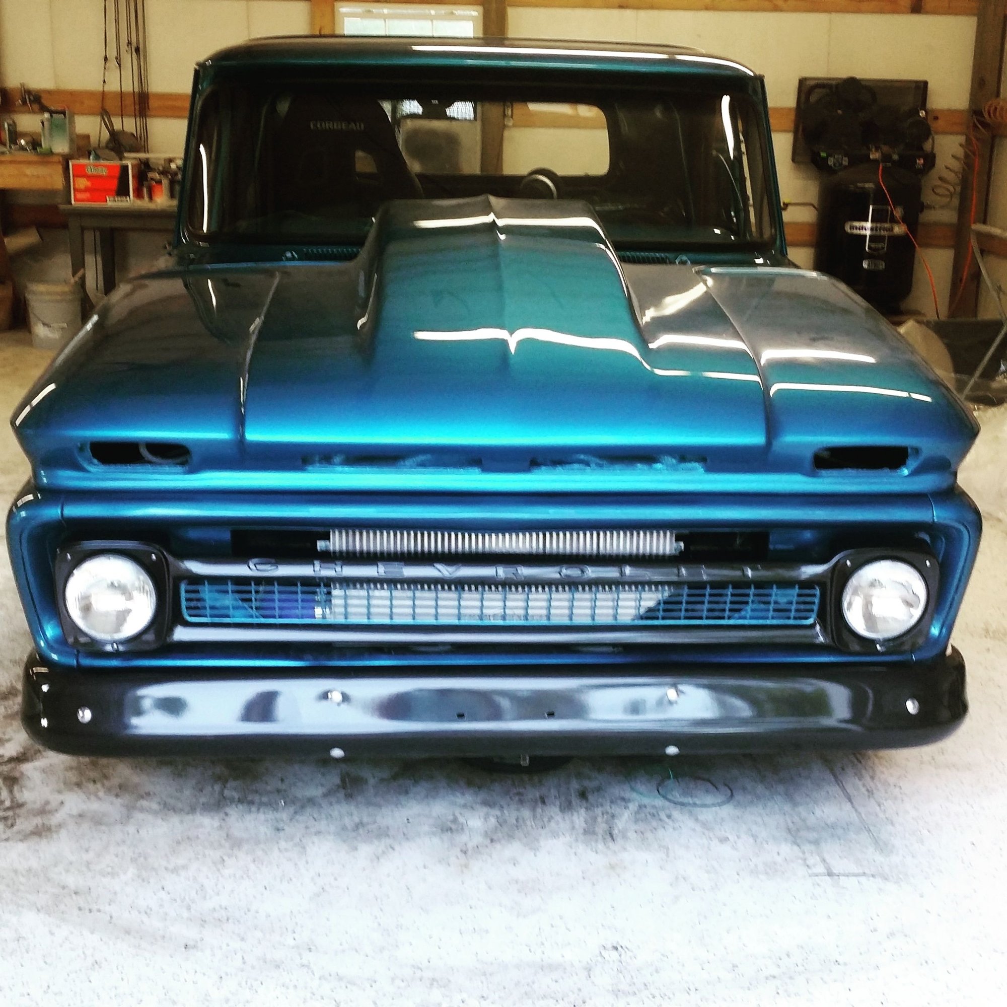

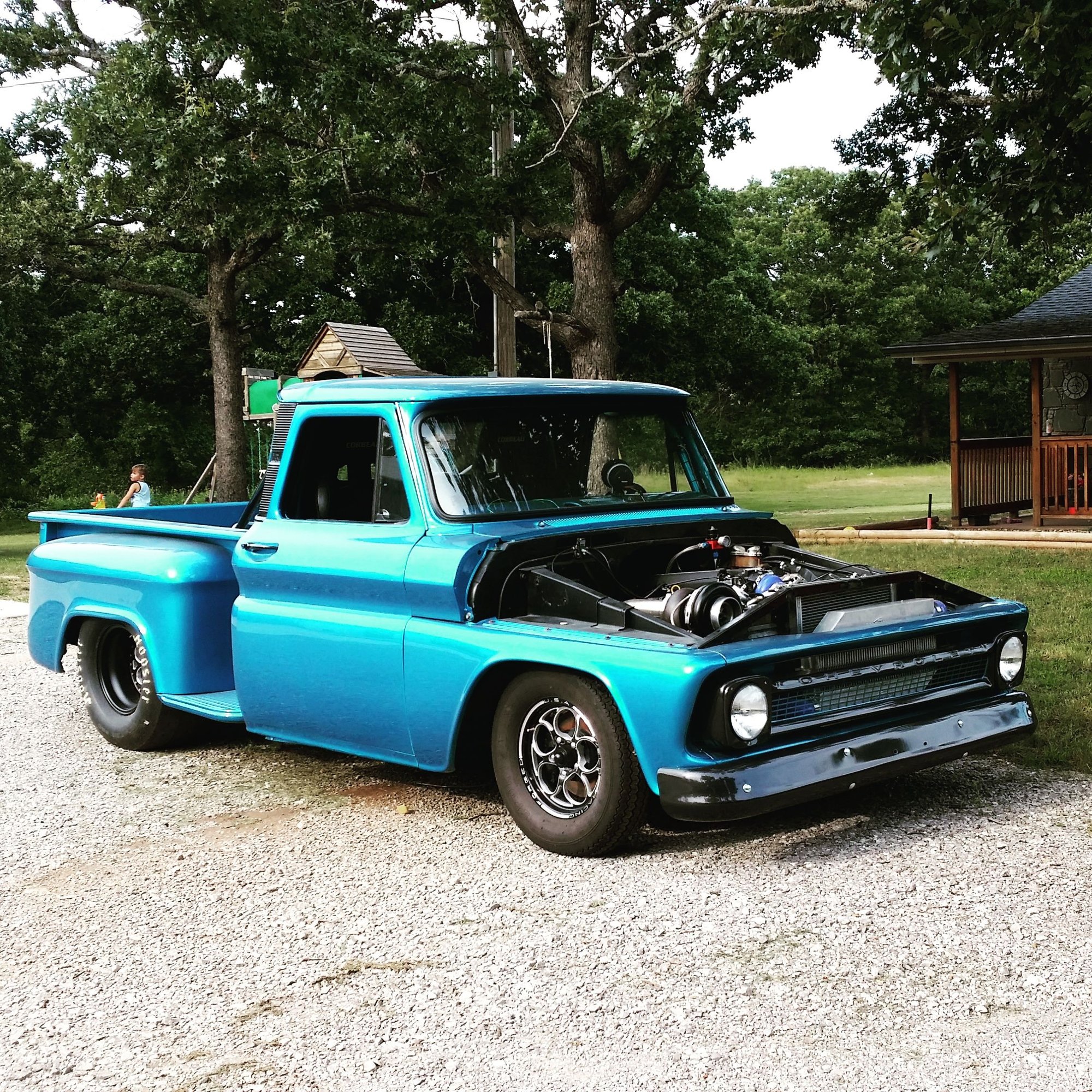

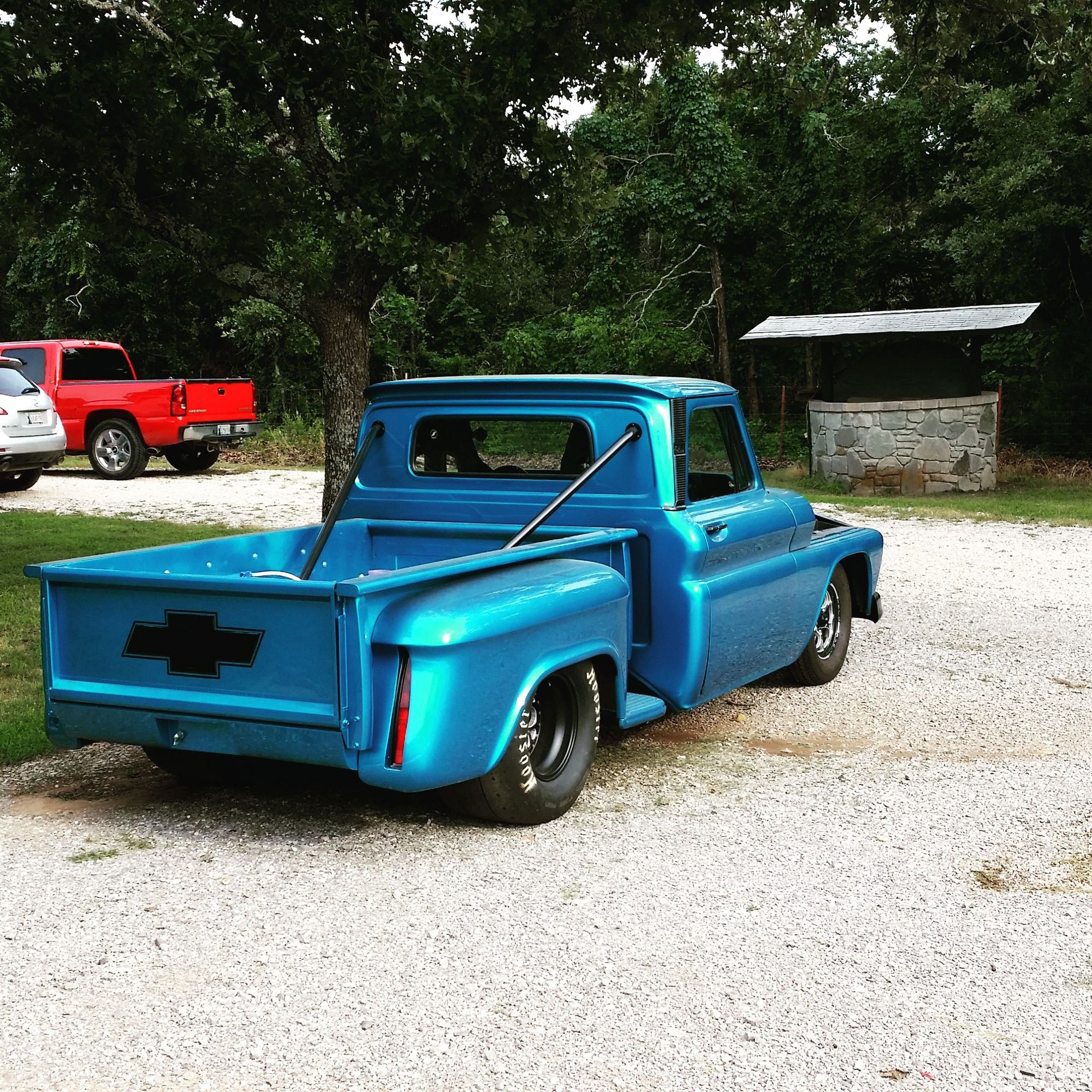

Old Jul 7, 2015 | 12:55 PM
IronBlocked's Avatar
Joined: Jul 2014
Posts: 560
Fine looking truck

Old Jul 7, 2015 | 10:26 PM
BUDGETRAT's Avatar
Joined: May 2013
Posts: 29
Awesome looking truck!! Sounds good too!!
