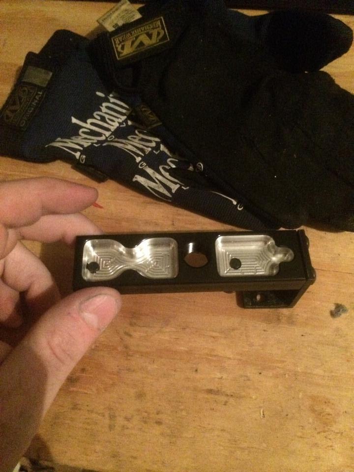

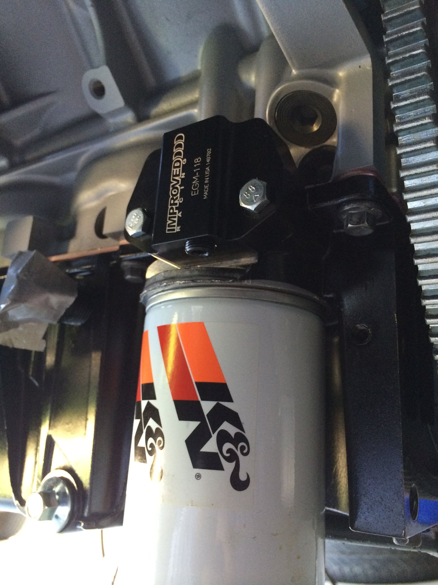

I figured it was time to start a build thread. We will be cranking up the new setup this weekend, so I figured I would post the new setup and pictures.
Previously, car had a SBE ls1, ls6 cam, e85, kytp kit with pt7675. We went a best of 10.20 off the footbrake with zero boost. Just loading the converter and letting it eat. Car is backed with a built th400 and s60.
New setup has taken a little over a year to build.
Motor:
LS1 block
Callies Crank
Callies Rods
Wiseco Pistons
Main Girdle/ARP studded
TFS 220 as cast with a little touch up from Brian Tooley
BTR Springs
10:1 compression
BTR/Lil john stg 3 cam
ls9 head gaskets
Stock rockers with trunion upgrade
Schumann oil pump/pick up
Improved Racing Baffle
Katech c5r timing chain
Moroso Valve covers
LS6 intake
Stock throttle body
Trans:
Built th400 w/pro brake
JW Bellhousing
Rmvb
Deep pan
Kevlar Blanket
Circle D custom converter/flywheel
Fuel:
In tank:
Walbro 255 with hotwire kit
External:
Magnafuel 4303 on 1lb hobbs switch (will have a manual override switch in a few weeks)
Feed: 8 an fittings/hose Y to 10 an to front of the car.
Return: 8 an
Holley fuel rails
ID2000 injectors
Magnafuel boost reference regulator
e85
Turbo/kit:
Huron Speed t6 kit
BorgWarner s484 t6 (doesn't actually fit with the turbo kit. Had to modify the cold side a little)
Tial Blowoff and twin wastegates
3.5 inch cold side
5 inch downpipe
Attached Thumbnails T6: S484 Alum 346 Build Thread-old-kit.jpg   T6: S484 Alum 346 Build Thread-old-kit-2-.jpg   T6: S484 Alum 346 Build Thread-bmr-turbo-k-member.jpg

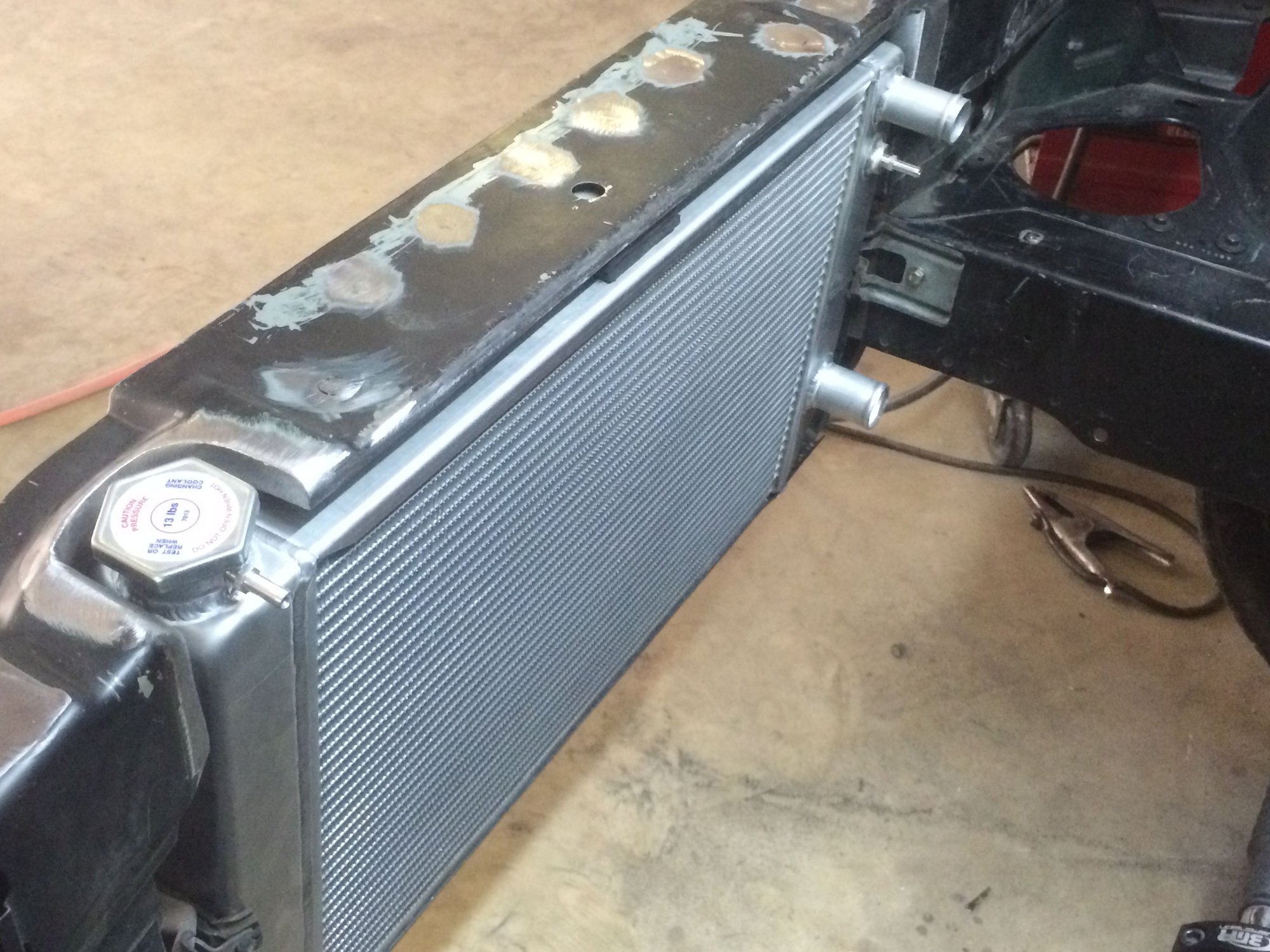

Car cranked up about a week ago. Here are a few pics if the engine bay finished. Got to finish up the front bumper and a few other small items.
