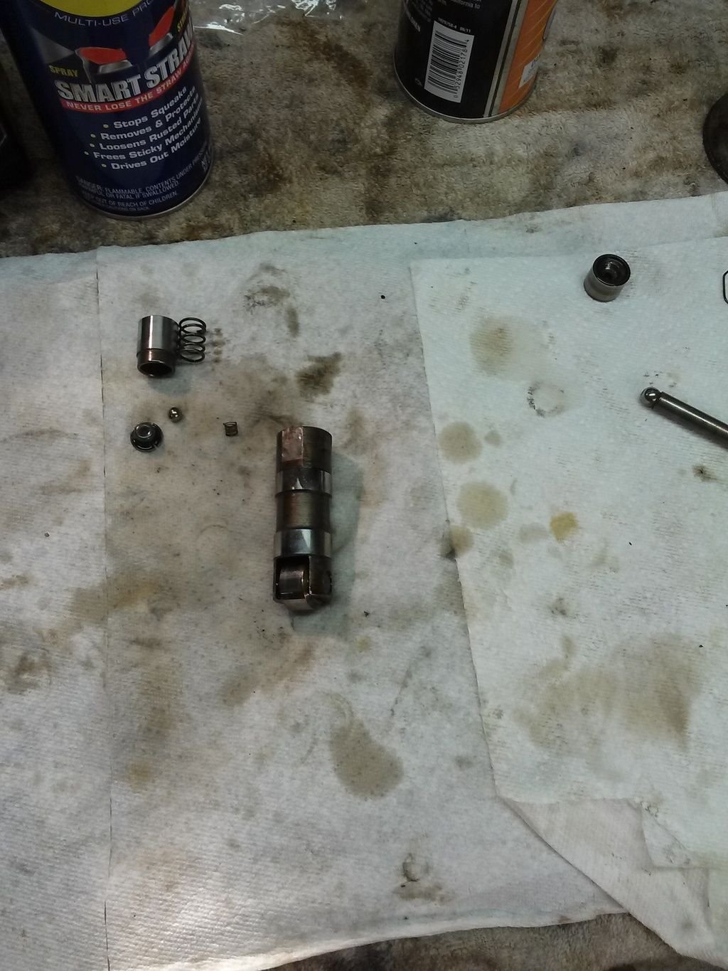

I keep the lifters and upgrade the pushrods. I have bent stock pushrods but have not personally had a lifter go.
Yeah maybe ill run some degreaser through them and clean them up a bit.

What’s your time/money worth to you. If the lifters look good, it’s fairley easy to pull them apart and clean them. Soak in gas/diesel. Small piece of safety wire with a 90 bend on the end to poke down the hole and depress ball valve, Then work the cup back and forth until it pulls out. Took me about 3 hours to do 16. Not hard just time consuming. I also used some red scotch bright and cleaned up the exterior. Try to keep them in the same hole they came out of.
That said, you can get a new set of the gen4 design lifters for $99 shipped. On Ebay. I wouldn’t bother with a used set. Again your parts are mated to each other and “happy”. Anytime you install new used parts they aren’t “mated”. Better off with new IMO.
http://www.ebay.com/itm/LS7-Hydraulic-Lifters-GM-LS1-LS2-LS3-LS6-4-8L-5-3L-5-7L-6-0L-6-2L-/271848012412?hash=item3f4b677a7c&vxp=mtr
LS7 Hydraulic Lifters GM LS1 LS2 LS3 LS6 4 8L 5 3L 5 7L 6 0L 6 2L | eBay
I soaked them in industrial degreaser yesterday and they look ok.. Spending 3 hrs to clean them up sounds less than appealing to me.. Especially with a 6 month old and a wife that thinks my garage is where the devil was conceived. Ill agree that buying used internal engine components is far from a good idea.. Probably just easier to buy the lifters than listen to my wife complain.
