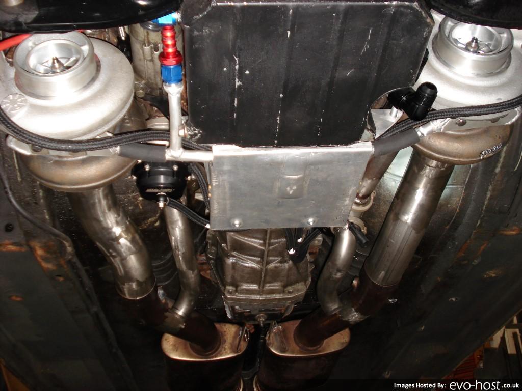

Stevie, I understand that picture probably wasn't taken specifically to illustrate the turbo drain system you are using, but I bet we could have seen all of it perfectly if your nifty skid plate wasn't covering it all. But what a creative configuration you have worked out, in there, I love the wastegate(s) mounting and dump pipes for said wastegate(s). Very cool set-up.

The plate hides where the boost control solenoids are mounted. There isnt anything to see regarding the oil drain, it's basically just an alloy pipe linking the two turbos.
From front side. I did add a crappy non return valve where the barbed fitting is in the photo to prevent some oil runback from the pump after shutdown. But the valve itself is so ****, I doubt it stops much.

Do have room for air filters on those, at all?

That's the biggest compromise of the entire setup
These were the smallest decent quality filters I could find and they fit quite well and are easy to get on/off, also the foam is replaceable. Or it could probably be cleaned too.
I wouldnt say their ability to filter is superb though, but IMO it's the best and freest flowing of any filter that sort of size. I couldnt find a K&N that would fit, but even if I did it would have such little actual filtration area it would be pointless using it

@ Stevie, anything is better than nothing. Even a screen to catch the big impeller-eating debris out is better than an open mouth turbo. Glad you found a solution.

I'd never run a mesh screen, as they filter absolutely nothing, and flow like crap too. The Greddy filters are actually very good in how the mount too compared to the likes of HKS etc
Much better and easier and the foam is also thicker although there are different layers of the foam.
Either way it's working find.
