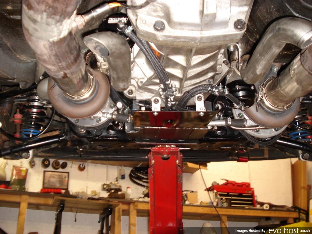

Bottom of compressor is only a fraction higher than the base of the oil pan. So pretty much as low as they could be on my vehicle
I have no downward travel on the drains at all, I had to make a small chamber from 3/4"x1.5" aluminium box section create a drain of sorts. There is no gravity drop whatsoever because there is no ground clearance.
The 3/4" is on the vertical plane. I wouldnt have had room for a AN style fitting or elbow on the turbo

Steve can you post some pics of your setup? I'm pretty sure similar thing has been done on a corvette so might give the OP some ideas.

You can just see the drains. Small alloy box below turbo, linked to 5/8" rubber hose into a 5/8" OD alloy tube which links both turbos.
I tee another 5/8" alloy pipe out of this just directly beside the oil pan on the right side of the vehicle, and the scavenge pulls from this low location.
Doesnt look pretty, space is absolutely non existent but it works perfectly.
But aside from right side turbo compressor, almost nothing sits lower than the base of the oil pan itself.
