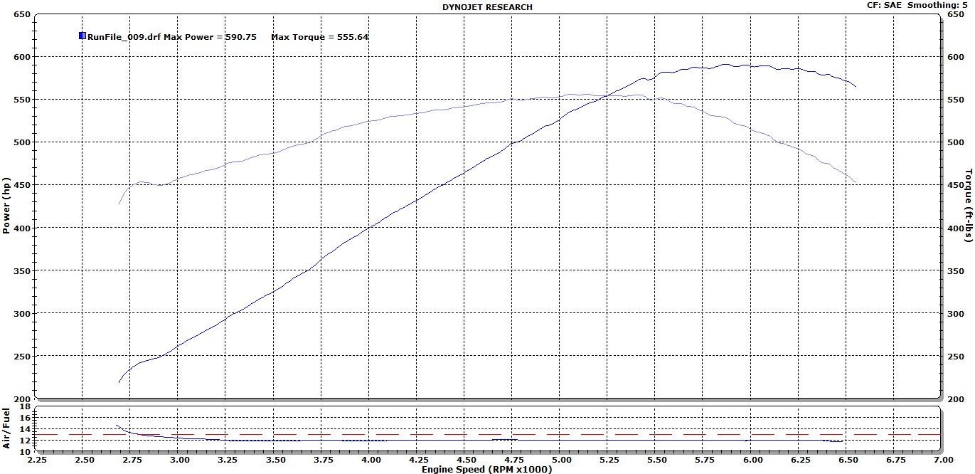

So I just got my D1SC Procharged Camaro back from the dyno tune and was very underwhelmed. 590rwhp just won't cut it with a maxed out D1SC blower. I was hoping for closer to 700 on this combo which seems to be a very realistic number. The tuner thinks it's all in the compression which turns out to be only about 9:1 on my 408 forged motor (lq9 72cc heads).
The dyno graph shows the car almost running out of steam around 6k which doesn't make any sense to me since the blower is maxing out right around 6500. The midrange power suggests this car should be at least around 650rwhp. The car makes about 8-9 lbs of boost at the boost gauge.
My question is do you think I have a boost leak (no signs of belt slippage)? Any easy way to check?
Should I get a set of milled heads and a thinner gasket? Should take me to 10.1:1 maybe as high as 10.3:1? Would that be enough to make better use out of the D1?
Or should I keep the compression low for an F1A/F1R? I plan on upgrading to an F1 soon. The low power levels are definitely making me want to do it sooner then later. Would I be better off 9:1 with an F1 blower or would I still benefit with around 10:1 compression.

This is what I was afraid off, as it seems like it can be a handful of problems. At 590rwhp we weren't running lean at all on the 60lb injectors. They are 3bar 60lb injectors so they should be fine for now (planning on swapping them with the head unit). It is a 8 rib set up with the factory Procharger bracket 7.65 crank pulley and a 3.8? blower pully. I originally thought belt slippage but the pulleys are clean. It is however running the factory twin intercooler set up. I thought this would hold me back somewhat but I have seen guys running 650+ on them. My tuner also said timing was not an issue. I'm guessing it's probably a combination of a few things. Maybe the compression being to low and the crappy intercooler set up? What front mounts do you guys recommend/run?
Also, the engine is a brand new 408 iron block set up built by Livernois. The heads are Patriot CNC'd 317's with dual valve springs and the whole 9, topped with an LS6 intake. I really doubt the issue is internal as the car runs real strong. The exhaust should be fine. 1 7/8" long tubes, no cats with an SLP Powerflo catback and a cut out that was open for tuning.
I believe the dyno would suggest this car makes better power when looking at the mid range. Comparing it to my buddies 612rwhp Vette (A&A kit). It makes better low end and midrange power up to around 5500 where mine falls off.
That squiggly line in the upper rpm range is a sign of belt slippage, as the belt slips, then grabs. With the ProCharger J Bracket you have to run the blower belt much tighter than what you are use to with other belts. It basically needs to be as tight as a guitar string. Anytime a new belt is installed, break it in by taking it easy on it for an hour. After an hour, readjust it as it will have stretched. Now it's ready to go wide open throttle. Bob

Your problem appears to be how much air is getting into the blower, then how much is getting to the motor. What inlet do you have on the blower? Try removing it on the dyno to see if the boost psi goes up.
Like Bob said, it looks like belt slip up top, and those twin intercoolers aren't helping either.
The problem with the static tensioner is as the rpms and load goes up, the belt stretches, now, the tension on the belt goes down when you need it the most. This is why you are losing 2, 3, 4 maybe 5psi of boost up top.
Go to a FMIC setup, get Aster's bracket setup from Bob, and I bet you'll se a good 700-750rwhp. FYI, with your pulley setup, you're still leaving some room to spin the blower harder. A 3.40" pulley is what you need.
