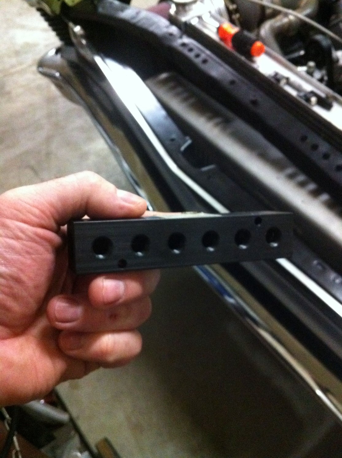

Anyone ever run a log for all things requiring a vacuum signal? I was thinking of using the large connection at the back of my truck intake and go to this log.
Since it's a closed system, I was thinking I use this for the FPR, BOV, boost/vac gauge, and MAP sensor. The other question, would I need a check valve in the line to the BOV so it doesn't see boost? Any experiences would be great. Thanks in advance.

Works fine. I use it for everything minus MAP because it wasn't convenient. Run a big line (1/2" min) to it and you'll be fine. Also no check valve is needed.

Thanks. The supply line to it was planned to be 1/2". Thanks again

I made my own out of some fuel rail stock. Works great.
Tried to find some better pics, but I don't have any. You can see it mounted on the motor plate.

I run some hobbs switches and my BOV off one.... No issues at all.

I have the fore innovations one

Never thought of putting the Hobbs switches in it!
