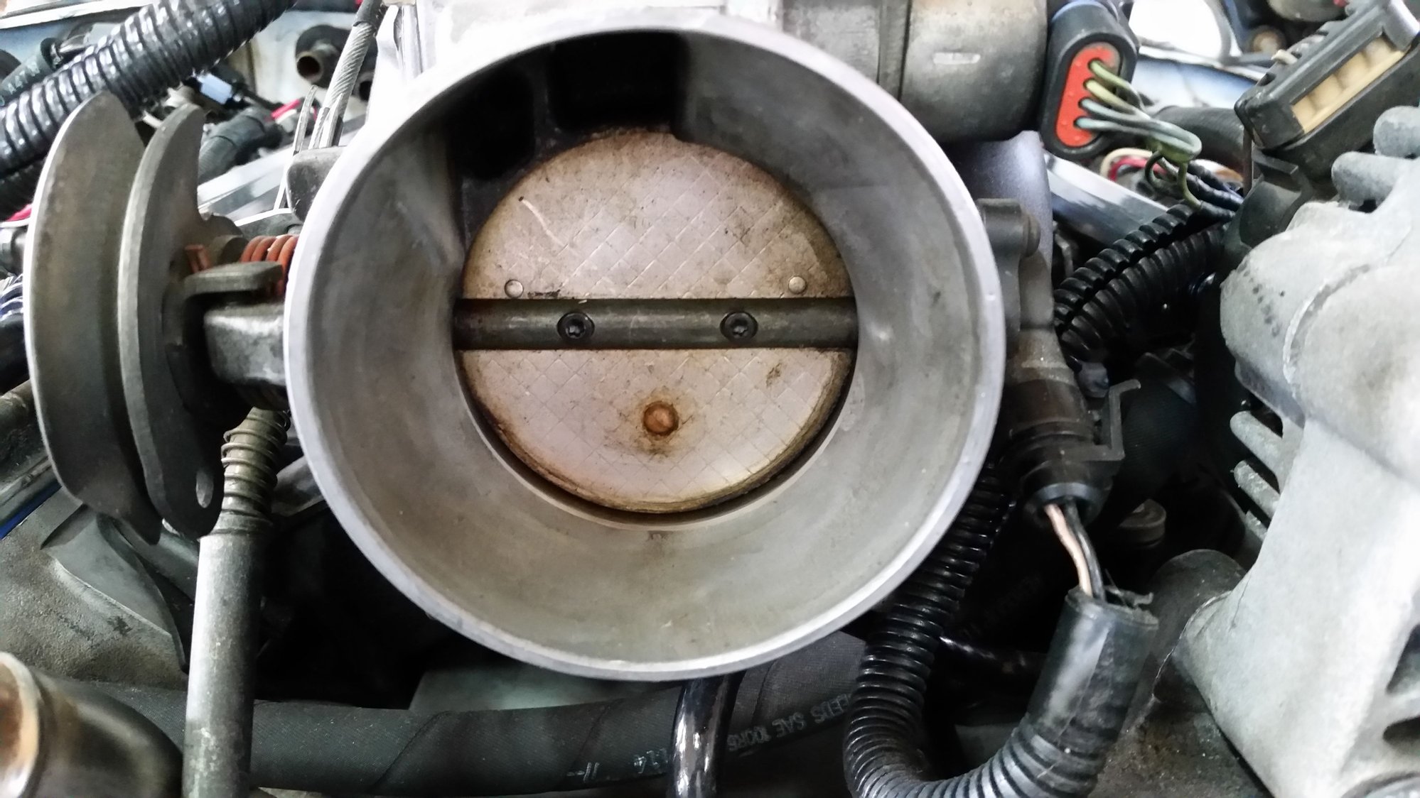

Cold side is coming together slowly, but surely.
Something caught my eye about the throttle body. There's a plug filling what must be a hole in the TB blade. Is the plug supposed to be there. A quick search found a lot of guys actually enlarging the hole, but I believe those were patches for poorly tuned idle situations. Having said that, Last time I had this thing running, it wouldn't start unless I cracked the throttle. It would idle, but barely. I've been told that the MS3 IAC schematic shows the wrong wiring for the IAC. I've never used one so I figured if simply unplugging this hole would help and is a normal thing why not. Can anyone shed some light on this?

That little guy on the lower part of the blade. Does anyone run without it? Will the throttle body set screw open the blade enough by itself?

Interesting-I recently had a problem starting, to rich-it had been fine, but when I changed my PCV system around, it caused the starting problem, less air (PCV is a controlled vac leak) I noticed my IAC was pretty high at idle, so it was trying to comp. the over rich problem, keep the engine running-I opened up the throttle blade, did a TPS reset (Holley HP) and cured the problem
I have the Edelbrock 90MM TB, and they have a screw that can let in more air, which I played with, just not enough, prob eq. to that hole in the blade.
I had been running on last years tune, if I had paid more att. to where the IAC was at idle, I prob could have fixed it sooner, lol

I'll run the set screw in a little before messing with it. Once I get it idling on it's own I'll repin the wires to see if that gets the IAC to respond correctly.
