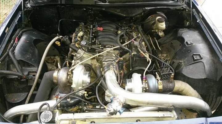

SORRY i forgot to add this in,,, boost was only at around 4 to 6 psi

had a issue with wastegates, so hoping when i get new ones i can turn up the boost

Lotsa torque, but funky curve uptop, what valvesprings?
Old Jan 10, 2016 | 03:14 PM
BoostedLS1CrownVic's Avatar
Joined: Dec 2015
Posts: 65
As far as i know , stock springs. Motor was brought off craiglist for $1500 came with 4l60e trans

Do you have each turbo running off its own bank or did you split the exhaust as they tie together & run the accumulative exhaust to both?
Old Jan 10, 2016 | 05:05 PM
Joined: Dec 2015
Posts: 65
Off there own bank

How about a log for each side showing back pressure to fill us in on how the motor is viewing those turbos as a pair.
& why do the HP power curves end but the torque keeps going.
Not enough info in the pic to ascertain a definitive performance based on torque/RPM.
& what if it's not just waste gates?
Looks like that was an aborted run ( would assuem the boost was on its way to a spike by looking at the curve). The other run looks like it was a full pull.
Are they the same gates? Do they have the same springs?
Old Jan 10, 2016 | 09:27 PM
Joined: Dec 2015
Posts: 65
Both 38mm. Ones a 6lb and one is a 8lb.
So another error i made and have to correct.
And yes the boost spiked up i was told and he had to pull off
Man you certainly took the long road with this one!!! Live and learn I guess.
oh ya cameronvic, good man, helped me with my build,
You should have asked how he felt 2 different size turbos with 2 different gate springs would work.
Glad to see the project finally getting on track!
