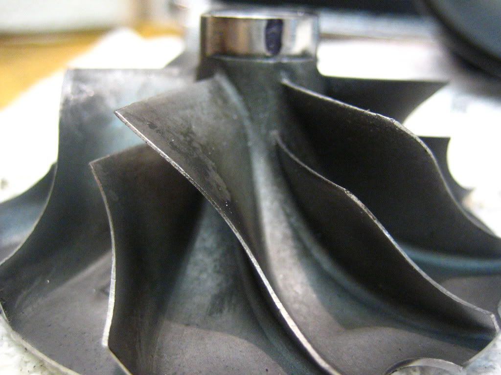

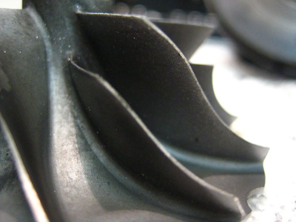

I think you need to step away from the internet a while and go put some of these great ideas of yours yo use. Let us know how the super heated forced induction setup works.
It would be really nice if you would share your pictures of a compressor wheel you have run for 50k~miles while injecting a liquid into it. You would be the first source for such information I have ever found across 30 forums and 15 years of data collecting who has attempted this. I am sure it works etc... I am simply interested in the shape of the wheel itself, does it show anything besides normal wear. I love injecting water/meth but I have always been afraid to do it pre-turbo. I am curious what kind of nozzle you are using, if any, what sort of atomization precautions you are taking, etc..
Old Jan 20, 2016 | 07:40 PM

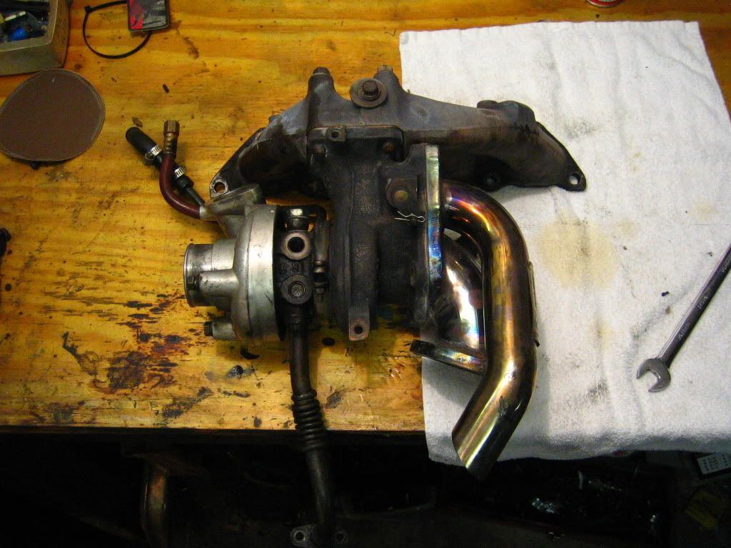

I'm 35 and have probably owned 30 "toy cars" or so over the years. I've never put 50k on any of them, turbo or not. If I get 2-3 race seasons of drag racing/street duty out of a JY motor I count myself lucky. The reason you haven't found information about compressor erosion is because it doesn't exist when used in an application like this. Which I explained already.
I literally sprayed tons of cars pre-compressor and never had an issue. I've done so on my current LS turbo for 3 seasons or so. It's billet and a little tougher than a cast wheel, but it still looks like new.
The worst application I can think of was my 93 talon. I used about 3gph of water pre-turbo at about 250 psi. This was on a tiny 16g mitsu turbo I put a "special" port job on with the gate basically pinned shut. It would spike to 35lbs of boost and settle to 25 or so by 7k. Easily cranking out over 100k RPM on that poor little turbo I'm sure. Ran it this way for about a year before the motor let go. Then sold the same turbo to Kevin Jewer, who set the record (which I believe still stands) for a 16g turbo. Using it. The blades were just fine near as I could tell. I rebuilt it before I sent it to him.
http://vid17.photobucket.com/albums/...DEO/dual75.mp4
Tiny little guy....
