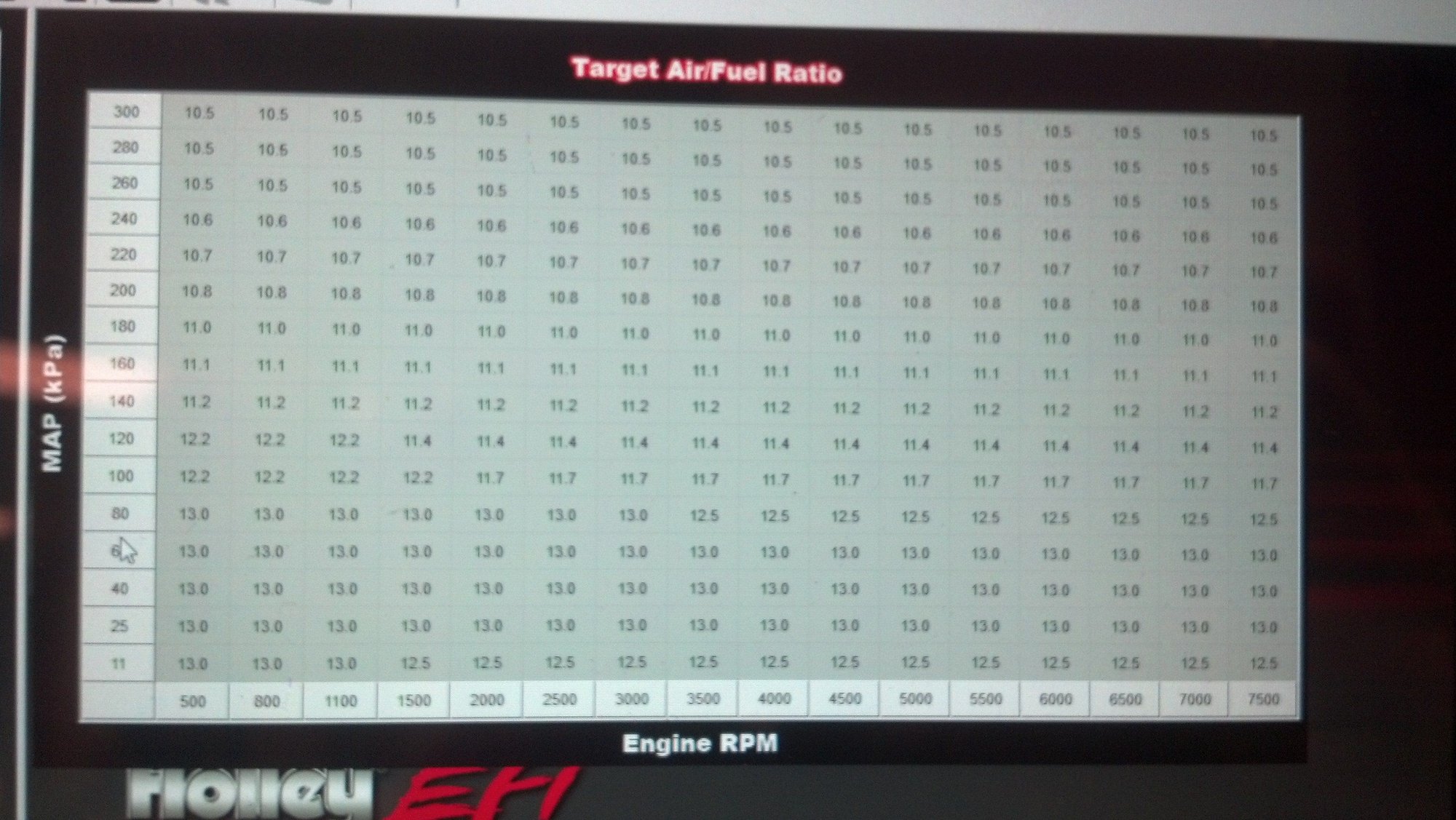

also.... using the gas scale.... is this a good target for my afr running e98 ?

at minimum... can anyone at least verify this is a good target goal for ethanol on the gas scale..... holley doesnt have any preconfigured ethanol graphs and i want to eat at least one gtr that saturday
