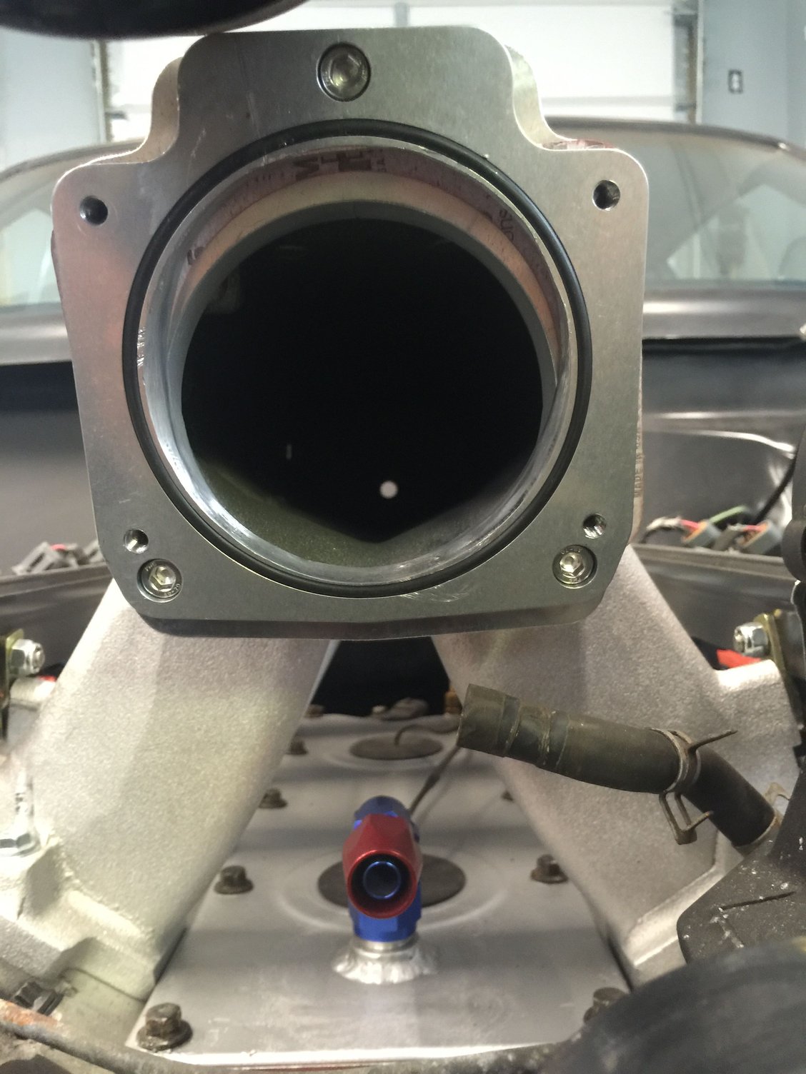

i have it bolted up currently its still bigger then the factory 76mm 3 bolt ill pull it apart and get some pictures for you guys in a bit. mocking my exhaust up now. thanks for the replies fellas.

That's it with it bottled up and then you'll see the inside of the adapter with the intake blockage.
That makes it clear. Would bug me too.
Enough material there to port it?
Just seems like the adapter is not centered at all.
I guess a solution would be to remove the bolts and have that adapter tig welded to the manifold.
Or just mark the manifold where your TB would like to bolt up and re-drill.
Do you have a TB yet?
I have the same 7139 but am using the small DBC GM tb. The adapter simply is there to match up the IAC port. It's just a gasketed plate.

LOL looks worse than I remember from last night... Dont grind the intake just get something to fit

Why not grind the top of the intake so it's a smooth transition? I'm running a 78mm TB well into the 8's and doubt you'd need teh extra diameter. But having that shelf on the top would annoy me.
