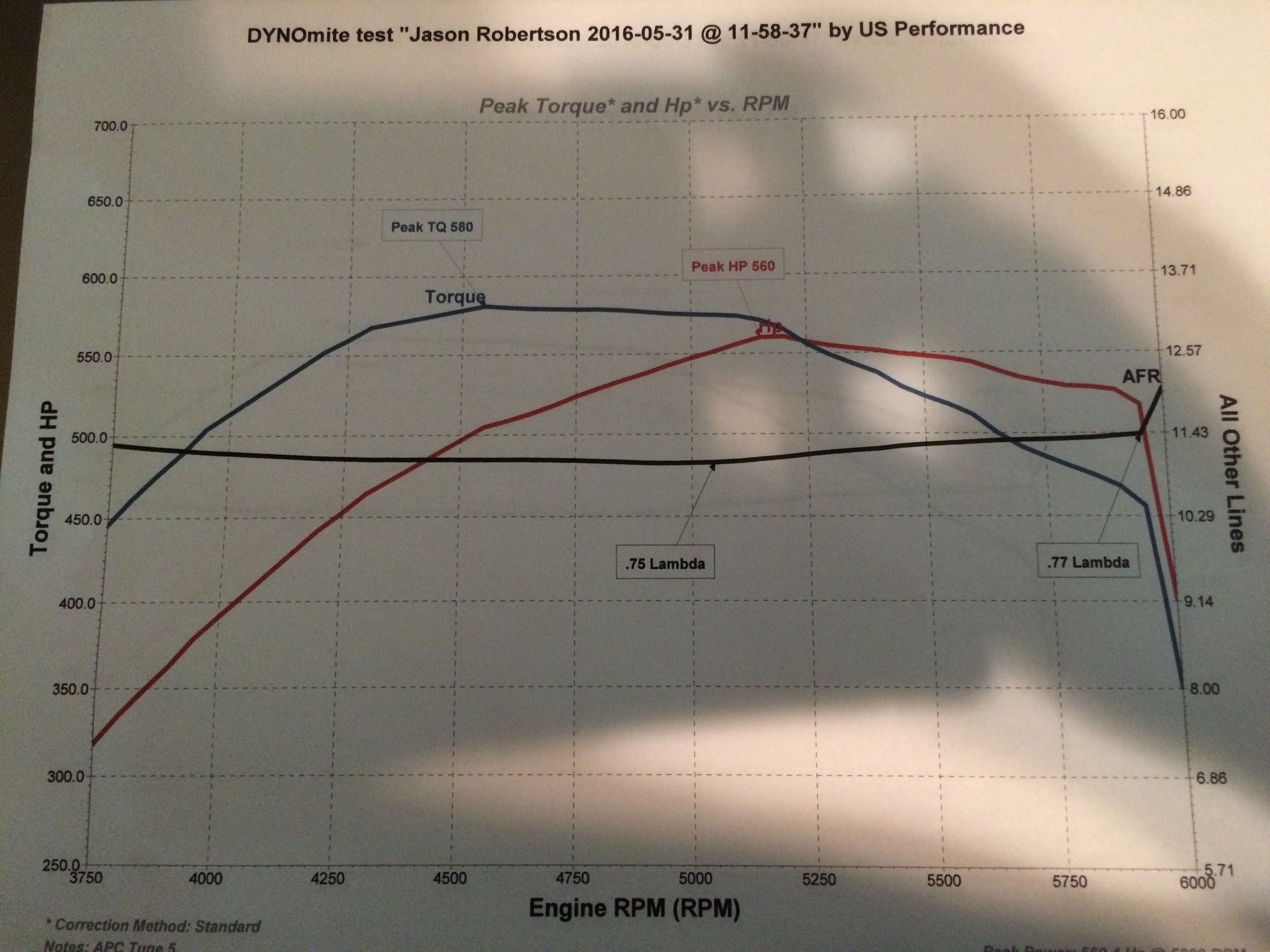

This is the sheet from where its turned down to. 560/580 at 8# and 15*
8# run

Good torque from 4000-5500

Man that torque curve is fat! Over 500 ft.lbs. from just under 4K up to 5,500 peaking at 580! That's that small turbine putting in work, I'd rather have that fat *** torque in a street car then a hero hp number up high. God I wish we had E85 more readily available where I live. Nice numbers bud!

Thats the 8# pull, i didnt print the hero pull where it almost went 600/600. I originally had planned to run the car at 8#. I purt two more pounds and another degree in it since then. Id bet good money its a good bit over 600 torque now.
