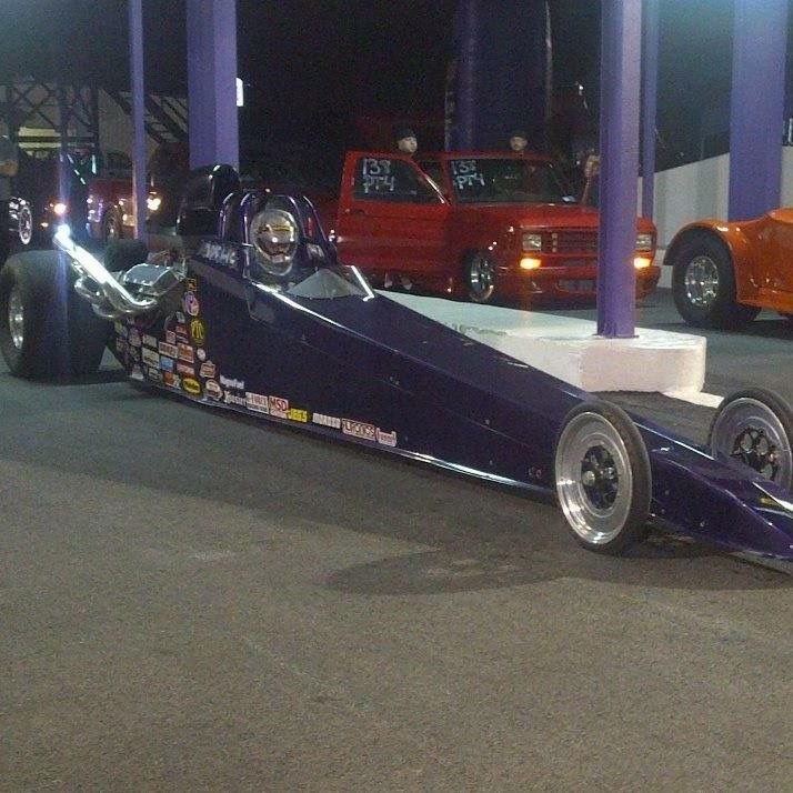

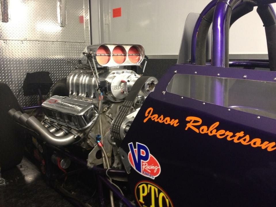

Ran 7.30s with the injected motor and 6.90s super soft on the blower motor
I dont have a legible timeslip anymore...sorry
Sold the dragster and big trailer a little over a year ago.
Old Aug 16, 2016 | 09:34 PM
  #68
NitroFumesAteMyBrain's Avatar
Joined: Jan 2011
Posts: 184
From: Texas Hill Country
Both were 555 bbc, car was alot of fun. Ultimatly it was too much of a hassel once we moved to colorado away from family. A blown alky 555 in a long car is just too much for a one an crew with his wife and 8 yr old, lol. So now i have this street car project.

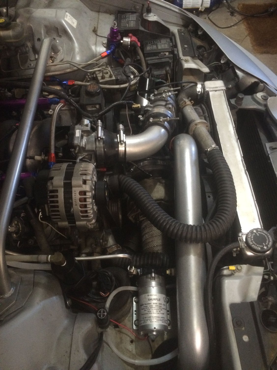

Sweeeet! I'll take those pics, but I really wanted to see how you shoe horned that borg into that tiny 4th gen engine bay and kept the stock fans and radiator. I'm curious because I just put a T7875 in mine and had to move some stuff around. I hope I didn't give the vibe you weren't being honest.

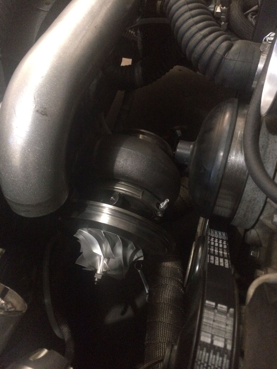

I got ya. When i get in today ill shoot a few pics of the 480 in place. Ive been driving it for a few days now without any issues so placement should be good to go.

One s480 front mount, stock puller fans, stand up griffin
Old Aug 17, 2016 | 03:59 PM
  #73
Joined: Jan 2011
Posts: 184

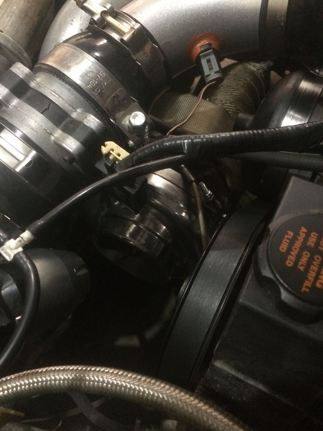

Offset the fans a touch to have the turbo discharge and charge pipe basically split the fan motors. If i do anything ill cut my charge pipe and put a coupler in it to adjust the inlet angle a bit. Its fine as it sits now, just a bit tough getting the housing and piping lined up but it goes.

Ah so you did stand up the radiator. Ditch that stupid PS cooler before it fails and pumps oil into your cooling system and destroys all your hoses...ask me how I know lol. Did you have to modify the down pipe at all when going from the 7868 to the S480?
