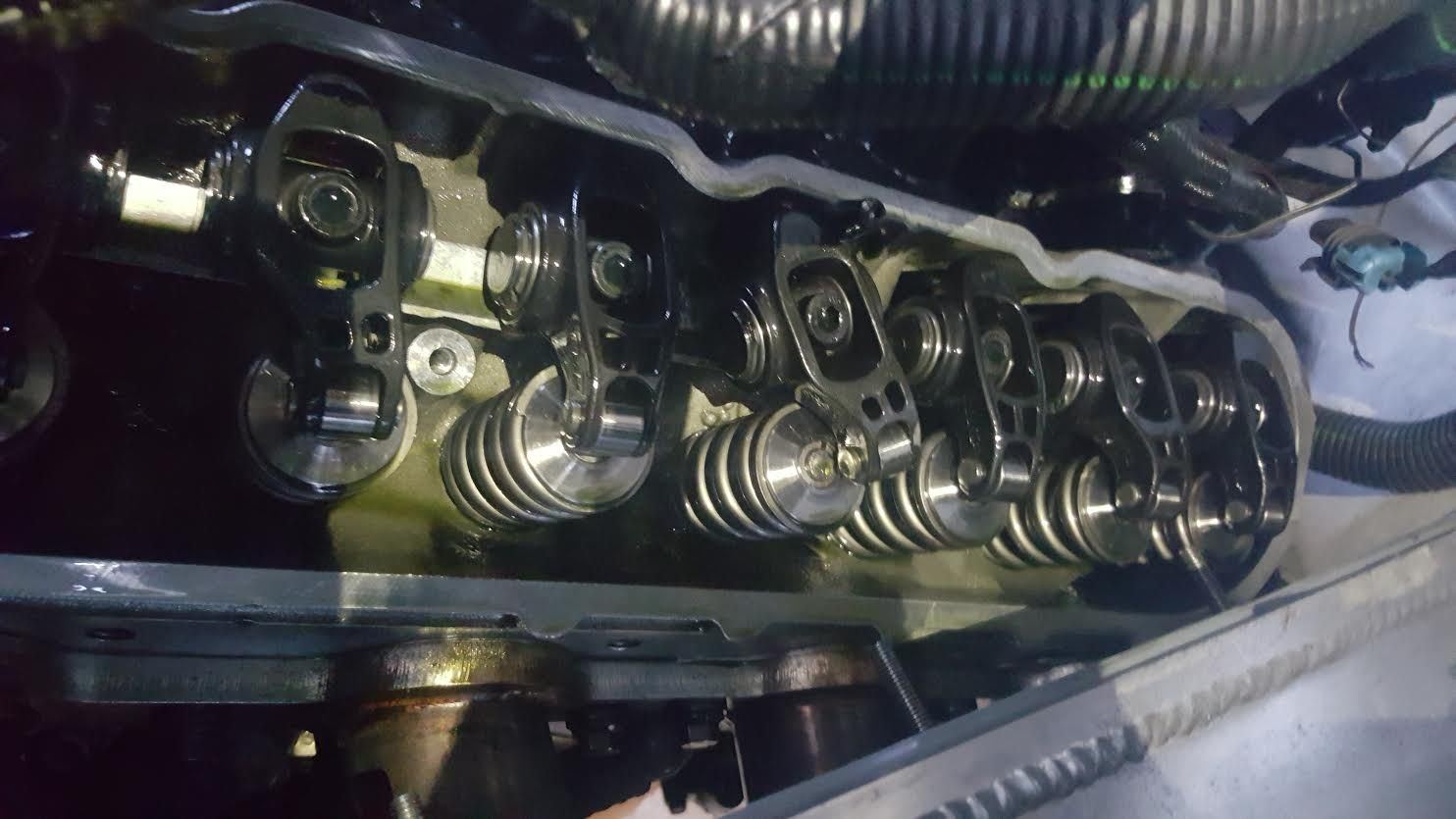

did the same thing to me after a 7800rpm pull just started miss firing a little bolted back in fine bolt felt slightly bent gonna order a new bolt probably go shaft mount

Happend again cylinder 3 this time intake rocker as well

What spring pressures are you running? Did you confirm no spring bind, piston/valve interference, rocker/retainer clearance etc etc.

There pac 1208x springs right around 500lbs open springs have plenty of coil bind clearance, had a great wipe on the valve when installed ,ptv there's plenty checked it multiple times. I've parked it found some metal shavings in the oil so I'm gonna pull the pan and inspect and order shaft mounts.
