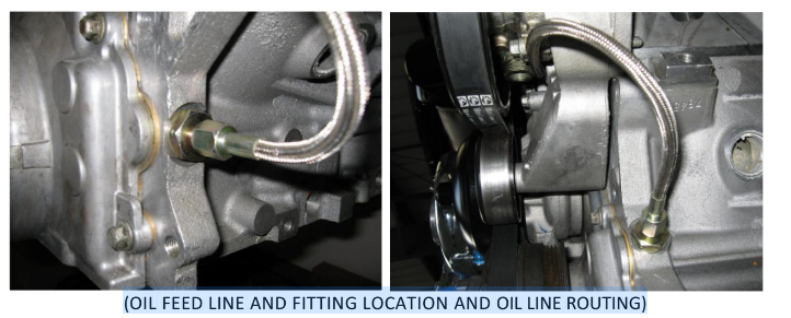

fun Pain's Avatar
Posts: 34
From: Crestline Ohio
A&A Corvette option
http://www.aacorvette.com/supercharg...roducts_id=306
This is used on the front of the block.

Originally Posted by fun Pain
A&A Corvette option
For the above or teeing into the oil pressure sensor, I think one of the concerns I saw was over "fresh filtered" oil vs "dirty" oil thus people were using the replacement oil cooler block.
