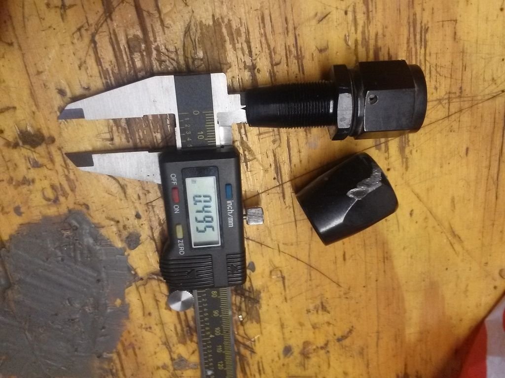

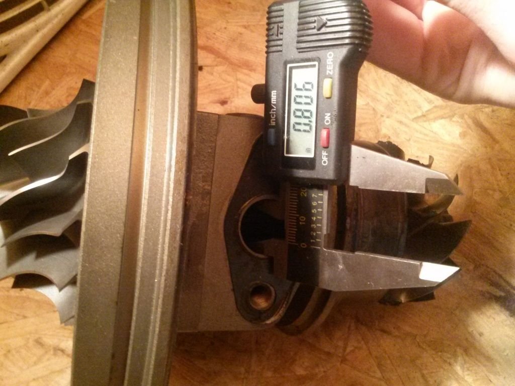

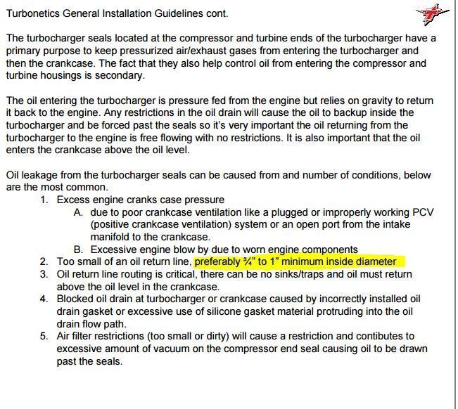

Pics of drain setup? What did you use for fitting on both sides? Measure the ID of fittings?
Soundsd like it may be a turbo problem, but your feed and drain is less than optimal as well. Esp if you have any sharp bends or use cheap china fittings with small ID's.
3/4 to 1" drains are whats optimal. Not that some don't get away with smaller.
ID of an S400 based turbo drain
ID of a -10 AN fitting.
Straight from Turbonetics... and their drain diameters aren't as large as the BW.

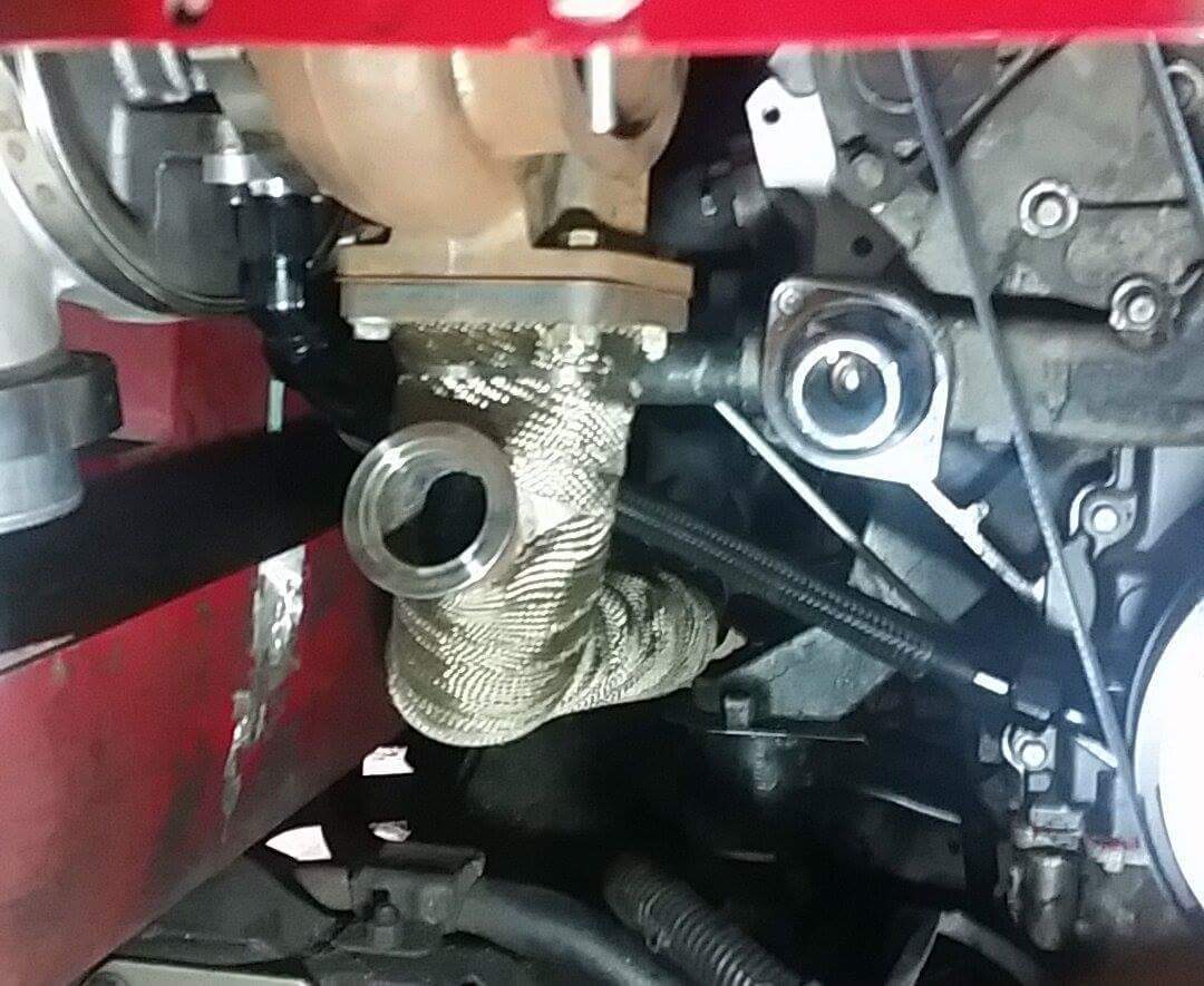

I'll have to find a picture, I know I have one. It's all -10 Fragola fittings. 2 45s coming out of the turbo to snake around the merge then a 90 into timing cover.
I should be fine with the setup. There are multiple setups I've seen with even worse angle having no issues. I shouldn't even need the restrictor. I don't think it's a drain issue, it's a serious amount of oil, not just puffs of smoke.

I called Forced Induction yesterday and we went over my setup and issues, they assured me the high pressure oil pump is no issue and I should be running the Borg without a restrictor.
They are adamant that my oiling issue is my drain, especially with the 90 degree fitting at my timing cover, and the 45 coming off the turbo.
I have seen the same setup everywhere, but not on a Borg. Maybe they are special and have more drainage than most, I don't know. But I went ahead and took the easy way out and have a Turbowerx Nano scavenge pump on order. I've been doing this build for over a year and just want it done already.
I found the pic of my drain finally. You can see how there's really no other way I could run it with this turbo orientation, at least to the timing cover.

No room to reduce the angle at the timing cover at all?
Old May 4, 2016 | 08:26 AM
Metallifan's Avatar
Joined: Jan 2013
Posts: 119
From: Ohio
I might be able to fit a 70 degree fitting there, definitely not a 45. It's pretty tight with the belt there. It doesn't matter now, Turbowerx pump will take care of everything.

Maybe run it straight out of the turbo and into the pan along the side. You'd have to remove the pan to install the fitting, but that may be what it takes.
Old May 4, 2016 | 10:39 AM
jrpimp00's Avatar
iTrader: (17)
Joined: Jan 2004
Posts: 1,082
From: Fayetteville, NC
You could try another 90* into the cover. Your looks like a sharp 90 (like a "L") a radius 90 may help, if it is the drain.

¾ hard line of some sort would have fixed it I’d be money. Using a pump on a simple setup like that seems crazy to me.

Yeah I tried running it with the drain disconnected and with the restrictor there was just a trickle of oil, FI said it's because I have that 45 right off the turbo with no chance to let it drop straight down. I'm going to run it without the restrictor and see what I see. It really seems like the drain hose is clogged or something but I haven't taken the fitting off the turbo yet, I will tonight. I can always sell that Turbowerx pump, but I think I'm going to need it. There is no other way to run this drain gravity style with my merge curving up where it is, it's already resting against the merge and I don't want to burn up the hose even though the merge is wrapped in DEI and I have heat tape on the drain hose, I'm still worried about it.

Ditch the restrictor. Get yourself some steel drain flanges super cheap off ebay and hog them out to ¾”. Then weld some ¾ steal tubing oil drains on the angle you need. Make the drains as long as you need to clear the hotside, then start with the rubber tubing. Something similar to this with longer steel tubing section.
If that doesn't drain properly with no help from a pump, it's the turbo.
