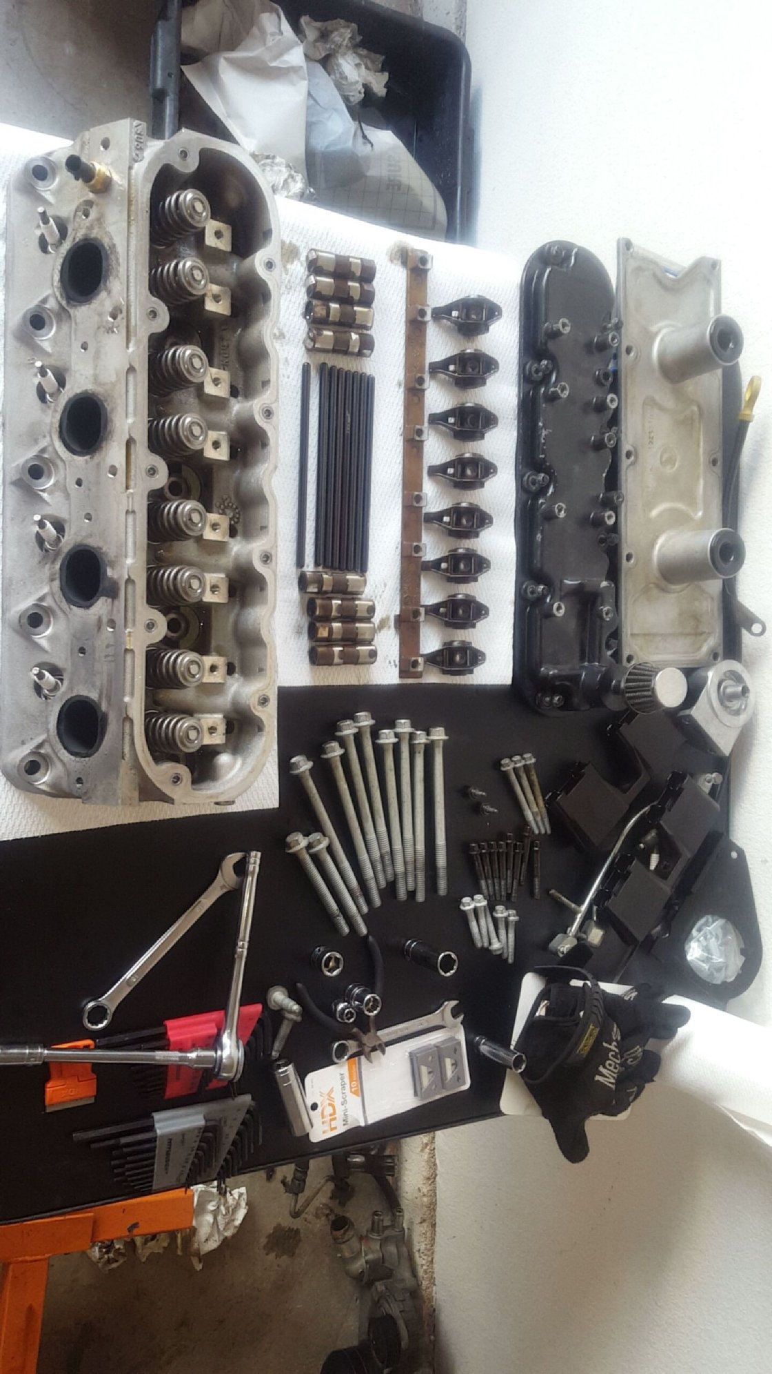

Im building a Turbo V8 LS1 Aluminum block. I was wondering how much boost i could run without having any issues.
Engine is going on a drift car.
mods
Camshaft
Push rods
Lightweight double springs
retainers
LS7 Lifters
Thanks guys
