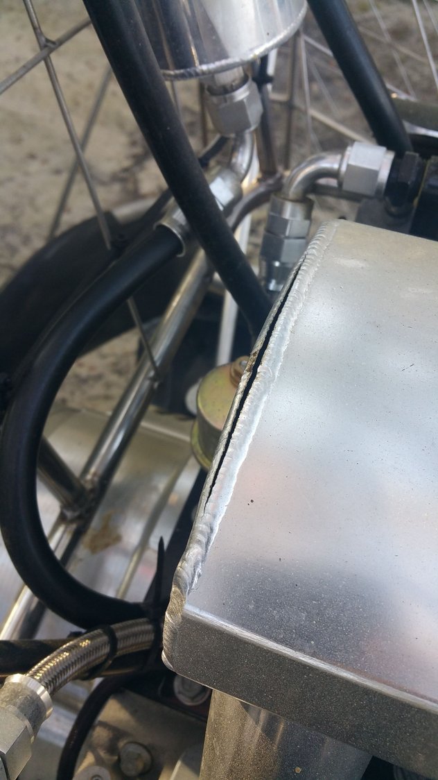

back of intake blown out
That was at 11 lbs of boost??

Loud Mouse's Avatar
Joined: Jul 2016
Posts: 61
Yup. Only tuned for 11#. I have tig welded it back but it pisses me off cause I had the intake clear coated to keep it looking new.
They're already anodised when new....makes it a bit of a ****** to weld.
