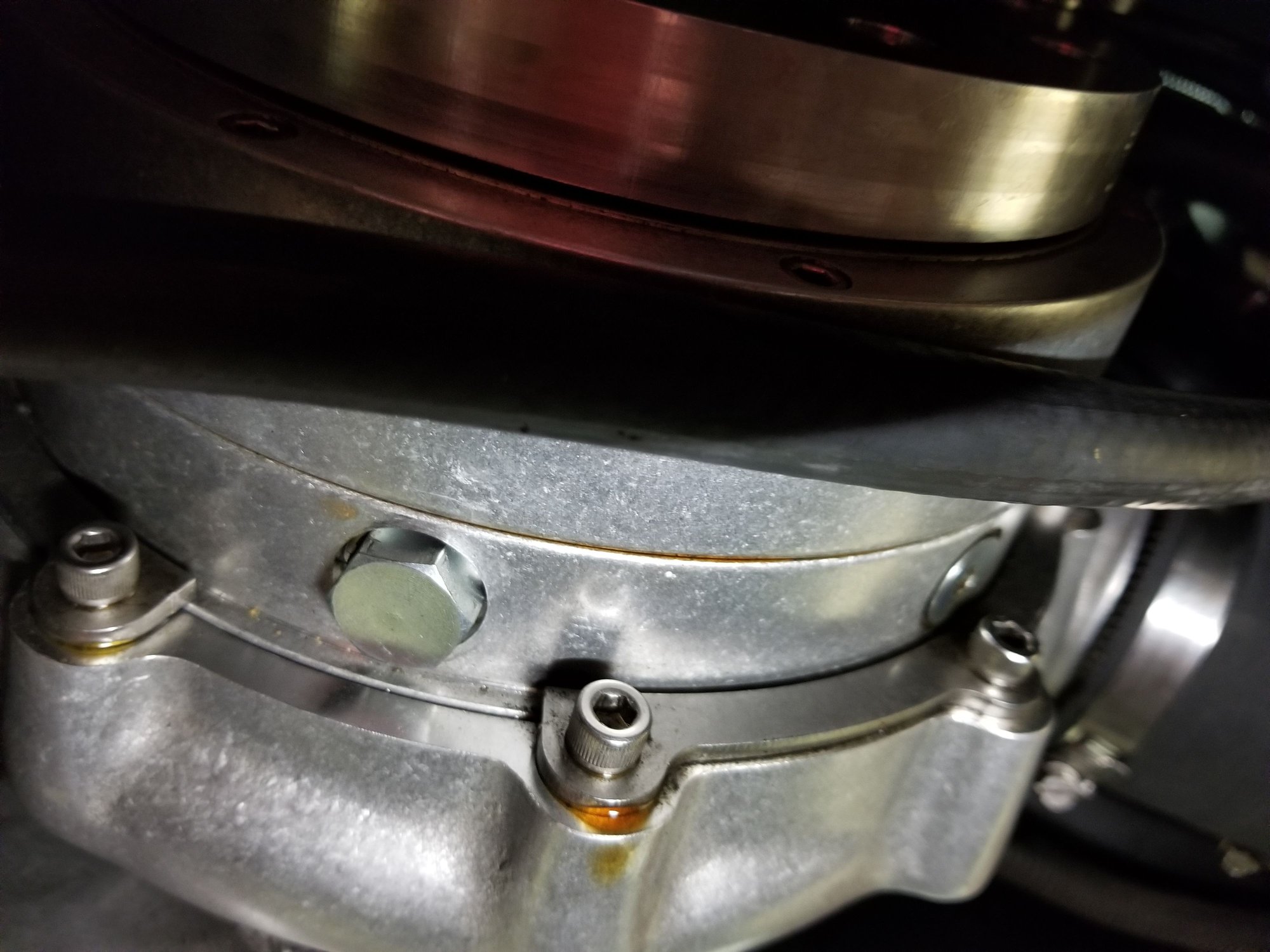

I put the air filter back on after cleaning and re-oiling it, then installed the pipe off the front of the head unit and ran the hose up to the PVC.
That finished the install.
I started re-looking over everything, making sure I didn't forget anything.
Upon doing so, I noticed (2) things:
1 - there was oil pooled at the bottom of the head unit. About 1 drop. As I mentioned earlier, I changed the oil in the head unit since I had it completely out of the car. I also wiped it down really good before re-installing it. I went ahead and checked the allen head bolts on the head unit and tightened them down further (the ones not to install the head unit to the mounting bracket, but the smaller ones against what appears to be a metal ring/gasket). They didn't feel loose at all which makes me wonder why oil was there...

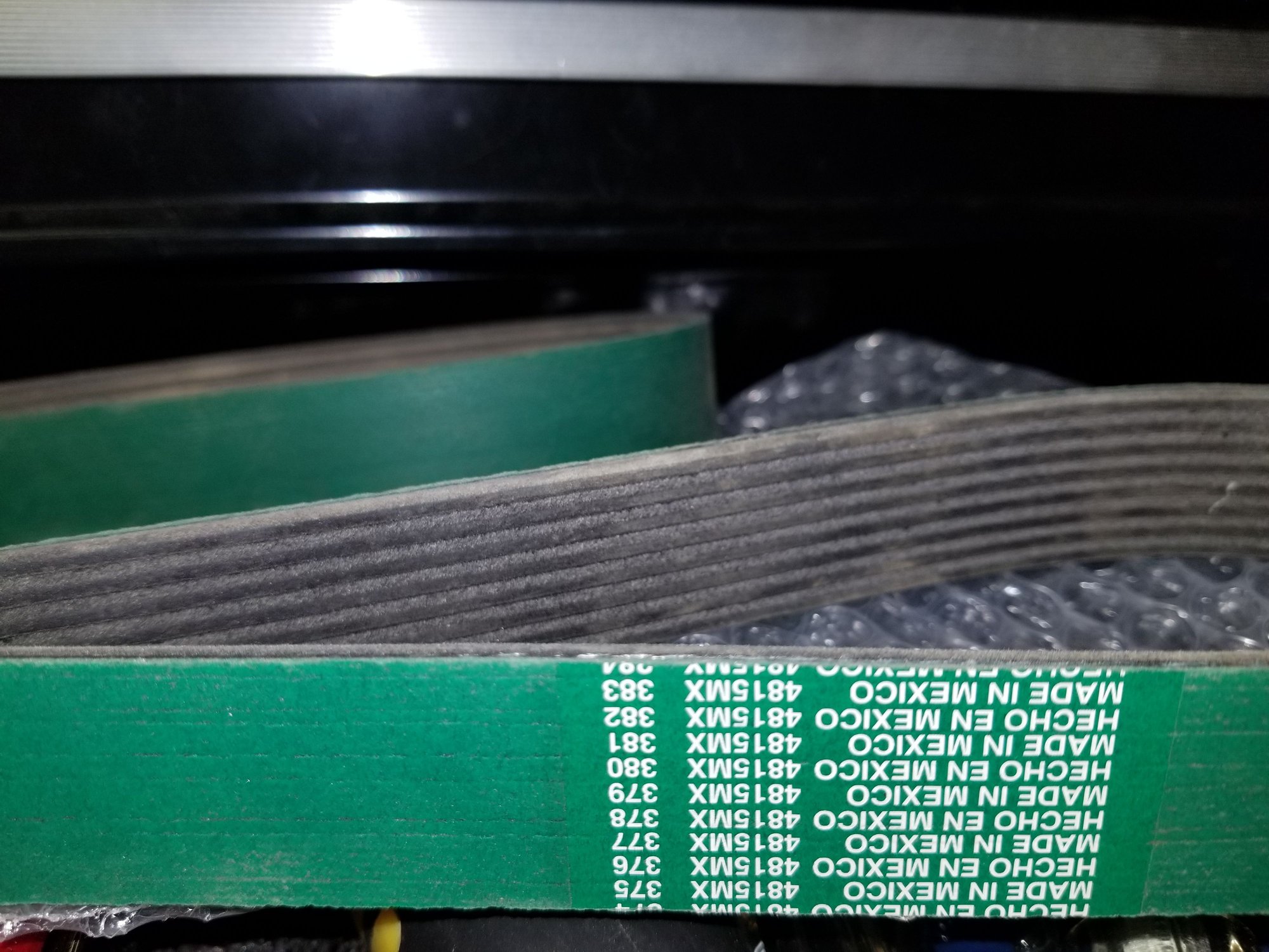

2 - the pulley coming off the head unit (4.38) comes REALLY close to the large pulley that mounts to the J-bracket. Now I have to ask - what position should this pulley be installed at? In which of the (3) holes? It was originally installed in the hole closest to the head unit (furthest from the crank pulley). It has always been in this location since day 1. I did not move it since that pulley was not damaged.
Maybe it is OK for these two pulleys to be so close to one another, but it leaves me a bit uneasy after already having to replace several pulleys last summer when the pulley let loose.
If the pulley needs to move to the middle hole, or hole closest to the crank, what does that do to the belt I have on the car currently? Here is the belt. I believe it's 53.5", but don't quote me on that. It's been a long day.

A drop of oil on the bottom of the head unit is nothing to worry about.
Giving more specific info like an actual measurement may give a better response instead of "really close". Plenty of people run their pulleys close enough to barely get a finger tip in and dont have issues.
I cannot physically get anything up there to take a measurement or I would have stated the spacing. With the belt on, it looks even closer, but the belt makes it difficult to see the pulley. If I had to take an educated guess, it is about the thickness of the belt itself since I was able to squeeze the belt between the pulleys. Maybe 1/16"? Could be a ch more, give or take.
I'd run it and just watch for belt dust. 1/16" doesn't bother me.
I agree, that is fairly common. Bob
