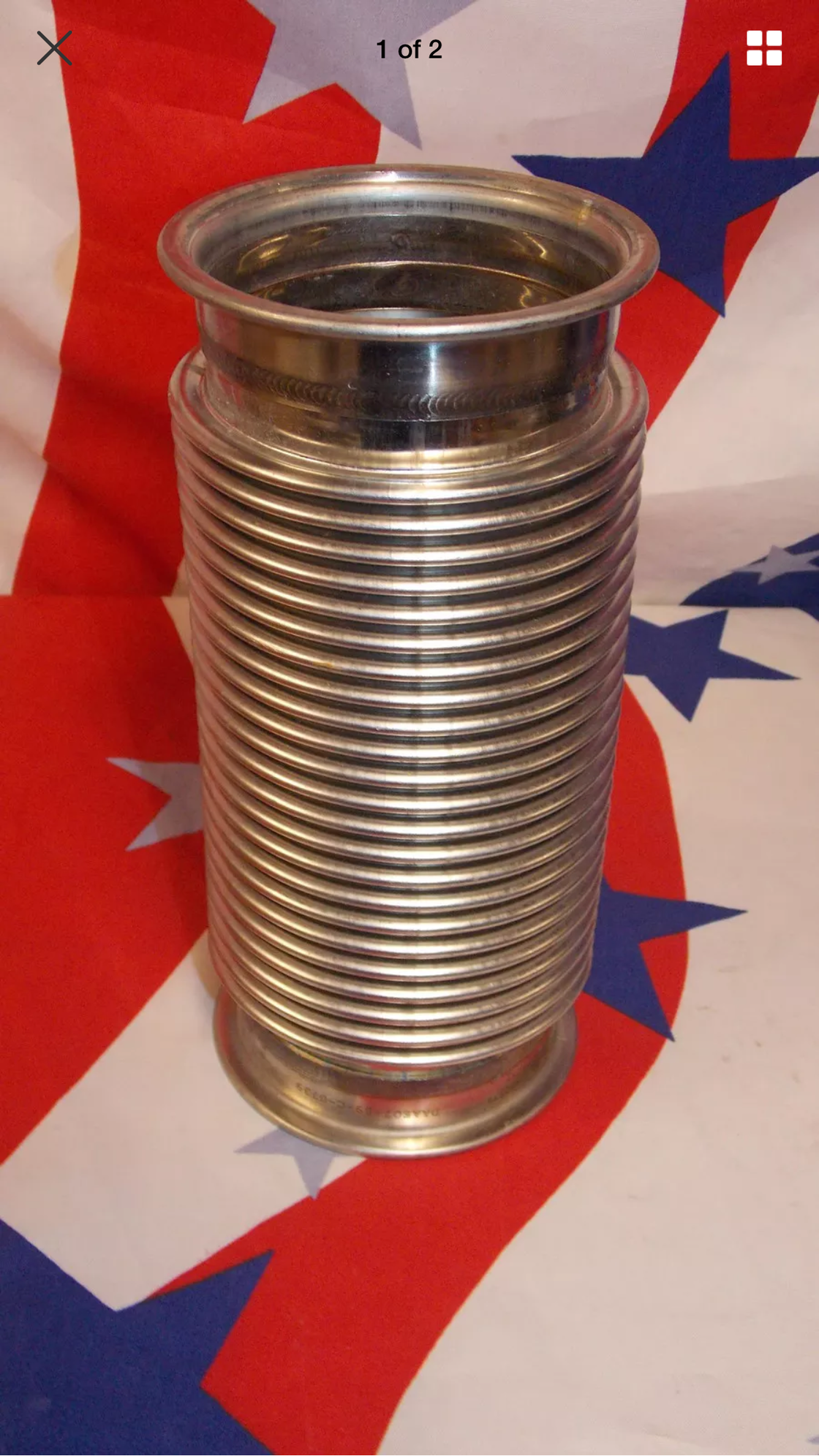

Gtfoxy: what's wrong with the slip fit , I was just going to weld it . I'm in missing anything ?
Brandon: you read my mind , would this work ?

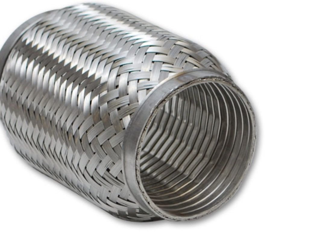

Or is this one better ?

The top one will work. The bad ones have a inner mesh that looks like the outer mesh. I have used them with the inner mesh and just cut it out. Been working so far.

BTW the top flex you showed I have used. i try to find the ones that have a pre-installed pipe.
Here is one like the bottom but shorter.

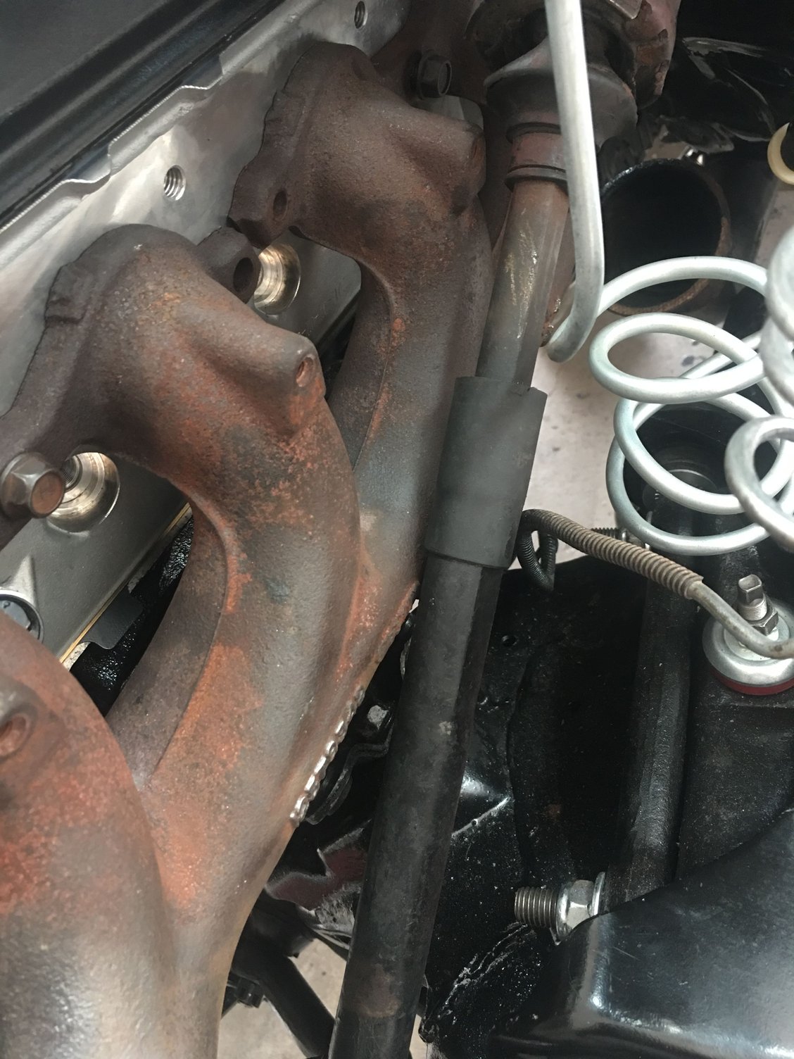

Well I ran into and issue , the truck manifolds facing toward won't clear my steering shaft in my 1st gen s10 , I should if checked before welding the pipes . I wonder if the camaro manifolds would give me more clearance.

Not sure about the Camaro manifolds. How much clearance do you need? You could take a little off the manifold & not hurt it.

About 3/4" .. I wonder if the hooker headers hug the engine more

Cut it in that arear and weld half a pipe in it to gain clearance. Or shave it some there and thin have the manifold milled down where they bolt to heads.

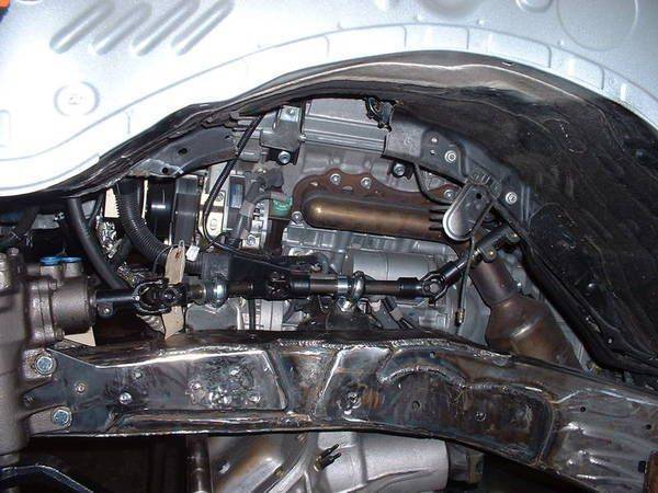

Get some of those steering shaft relocation kit deals...
Old Dec 1, 2016 | 07:37 PM
  #59
Ogoz23's Avatar
Joined: Oct 2016
Posts: 248
Order all the parts today to relocate the shaft .. fingers crossed.

Lol, I was going to say double joint the shaft, didn't realize there are kits.
Awesome.
