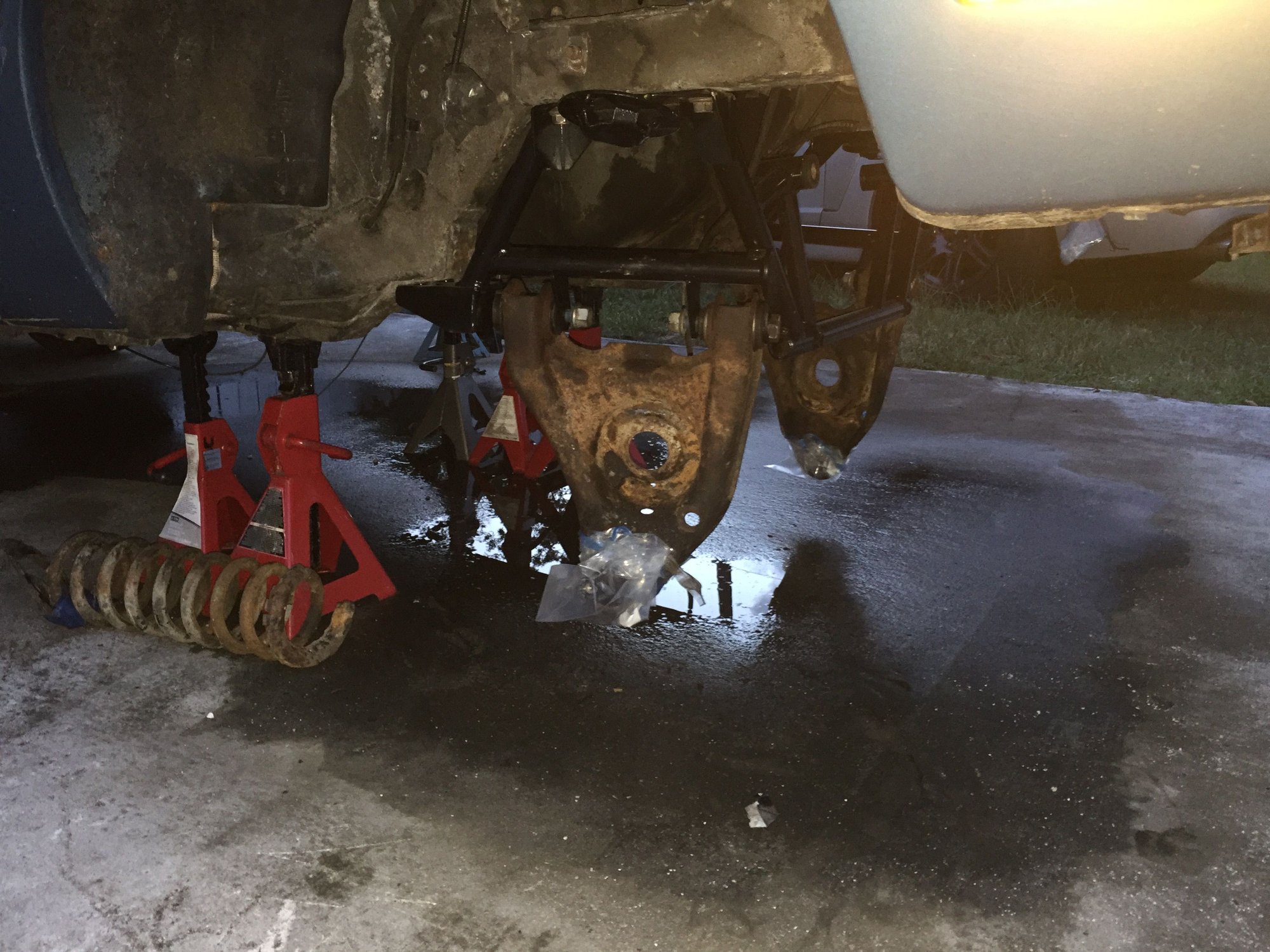

Control arms with the 80s fox patina
$6-7k I could definelty do it for cheaper, but I'm buying a lot of new parts. Rear is all done and on the ground now. Hopefully I'll get the stock springs back in this weekend and we'll have a full roller again.

Front springs and shocks are in the car (all stock suspension) I've just got to bolt the brake calipers on and I'll tow the car to my buddy's house for the fun part. Subframe connectors and motor and transmission install next.

Back on the ground, suspension is all done. I ran into the same problem others had with the AJE k member the steering shaft is 1 in too short . Looks like we'll have to weld a collar to make it fit..

The one strange issue is the front end is sitting pretty high with the motor in the car. I used stock fairmont springs with the AJE adapters to use coil springs instead of coilovers. (gotta keep the budget!). Not sure if anyone else ran into this issue. Guess They've gotta come out again and chop em up!
also, you put the car on the ground before tigthen ing the lower arms right?
