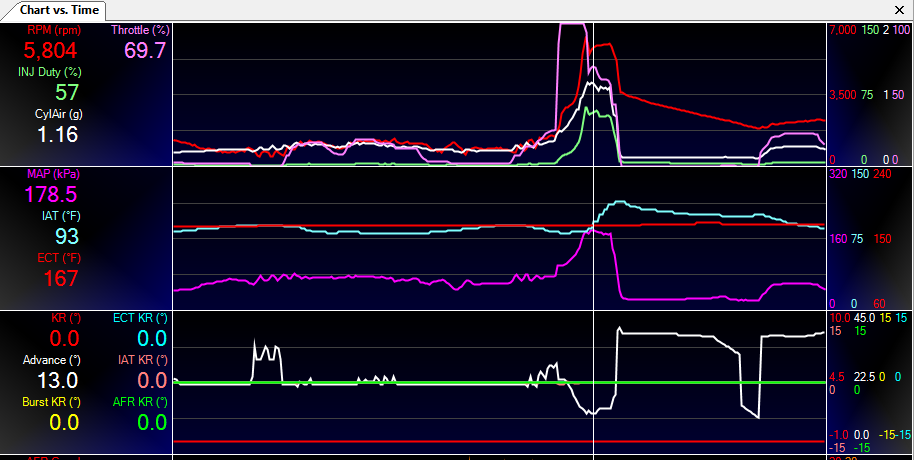

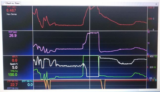

I started with Denmah's 2500 HD tune from the sloppy tune cabinet, and changed a few small things to work with my car (no trans etc). The car runs well enough, but when I get into boost, the timing falls off to 5 degrees until I get out of it. The timing will mirror the boost curve through a run.
My Cylinder air mass vs. RPM timing chart has a minimum of 13 degrees in the cells that I'm running in, so I thought it was an IAT or ECT related retard. I changed those tables to not affect timing until it saw temperatures that are well out of my operating range, and it still went to 5 degrees last night.
Is there another table that is affecting my timing? The car pulls well as it is, but I feel like I'm missing a lot of power, especially because I read where you lose ~25 hp/degree on these boosted LS motors. When I get home from work I can post my tune file, but here is a log from the track where you can see boost and timing.
Thanks in advance.

You need to log ECT and IAT, as those are the 2 most likely culprits (there are a couple of tables that could be effecting this).
You should also change the MAP to read in kPa since that is how the tables are laid out and it makes it easier to reference from, might as well throw in cylinder airmass too.
In the table section, you can log various timing PIDs such as commanded timing, etc. Go ahead and insert any that seem relevant.

I have added those to my logs since this screen capture, just don't have a pic on my work computer. ECTs were 168 at start of run and 177 at end of run. My ECT table doesn't come into play at those temperatures. Driving around last night I made a few pulls and IATs stayed below 105, so I don't think that is affecting the timing either.

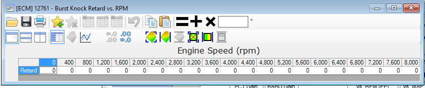

What do you're burst knock tables look like?

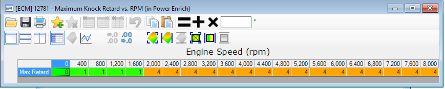

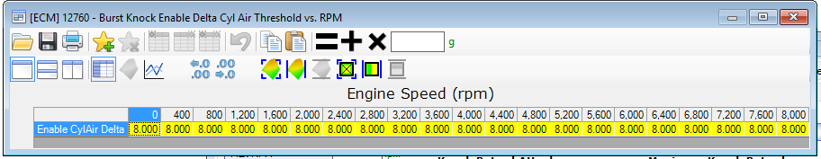

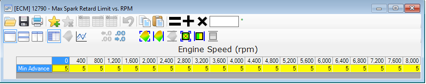

It looks like my minimum timing of 5 degrees is coming from that second table. What exactly is the "Enable cyl air delta" vs rpm table? I see someone elses tune has that all set to 0

Your Knock Decay Rate table is maxed out. I'm wondering if it's knocking but you can't see it.
Your table above with all the 5's in it is the lowest your timing will drop to in the event of knock.
Quick test would be to set that table to all 10's and see if the timing follows.

Also, your burst knock is disabled

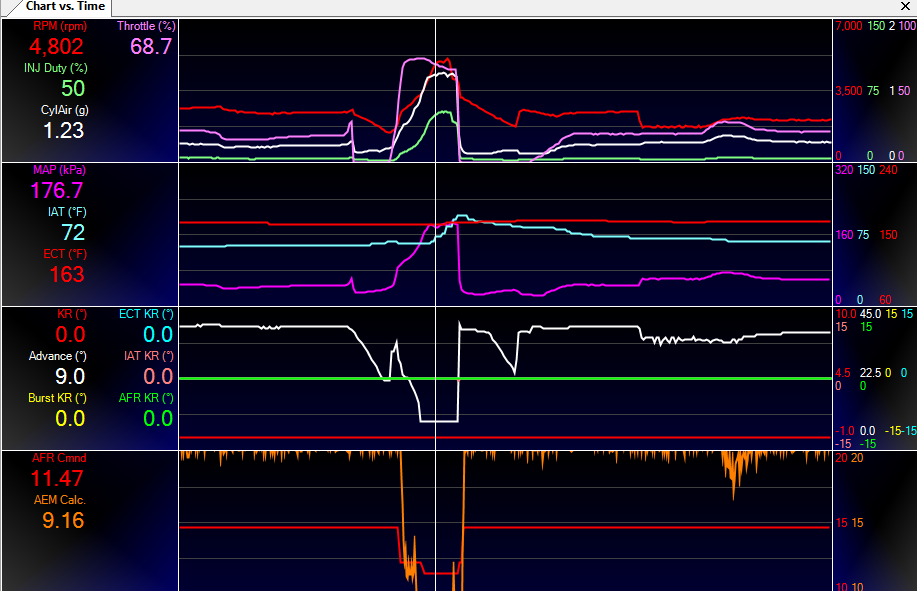

In my log posted above, I was monitoring Knock Retard, I figured that would spike if something was happening. But across all 8 runs, it never moved. Maybe I'm monitoring the wrong "Knock Retard" in VCM Scanner?
It's my understanding that burst knock pulls timing in anticipation of knock during large throttle position swings (starting line), for fuel economy mostly. Wouldn't it be OK to have it basically eliminated from a street/strip car that I don't care about fuel economy on hard pulls?
Since the previous track day I've switched to Denmah's log file that logs a lot more stuff. Next time I log something (hopefully tonight if it doesn't rain) I'll post a new screencap.

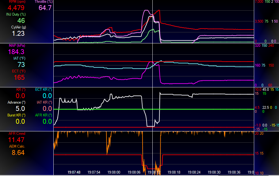

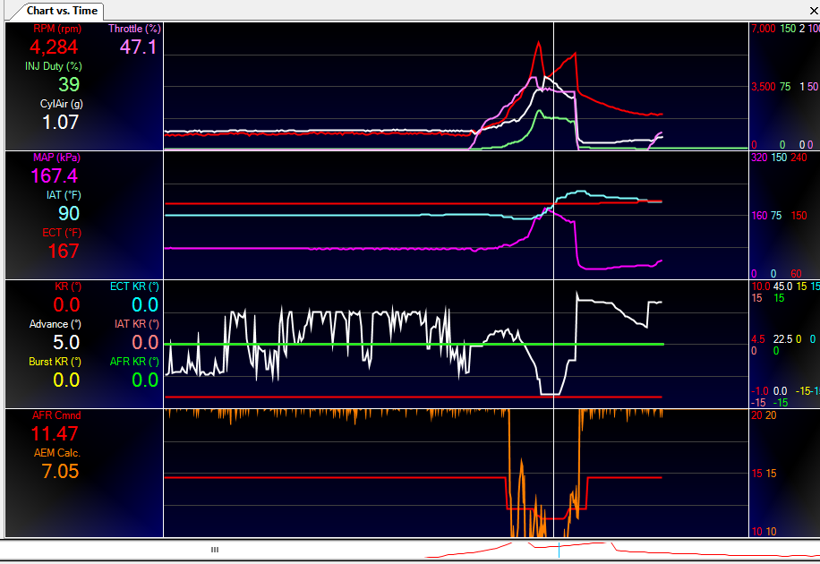

Here's 3 different test pulls tonight. On the 3rd run I forced the minimum timing to 9 degrees instead of 5. Other than that, I can't figure out what is pulling timing down so low... Any help would be greatly appreciated

The 0's in your Burst Knock Retard vs RPM have it disabled.

That's what I thought. So if it's not Burst Knock, IAT Knock, ECT Knock, AFR Knock, or Knock from the sensors, what is killing timing?
