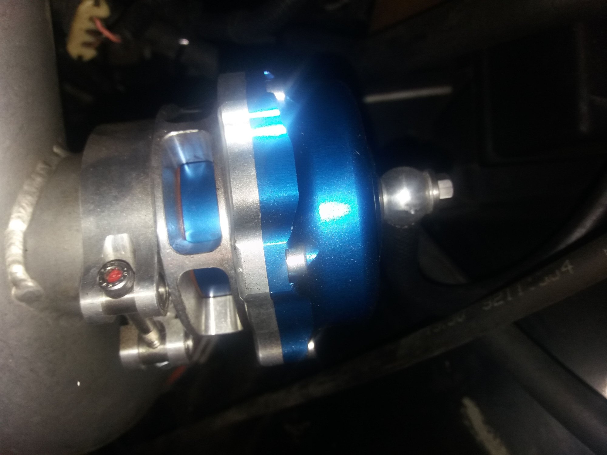

This is my first turbo car. Is the BOV supposed to be able to turn by hand? I can turn mine either way with minimal force. Is this normal? Also if I tighten it down so it doesnt turn with this have any effect on anything?
Also are there any adverse affects on it turning/rotating?

What kind of bov do you have. Any links or pics? There is a lot on the market

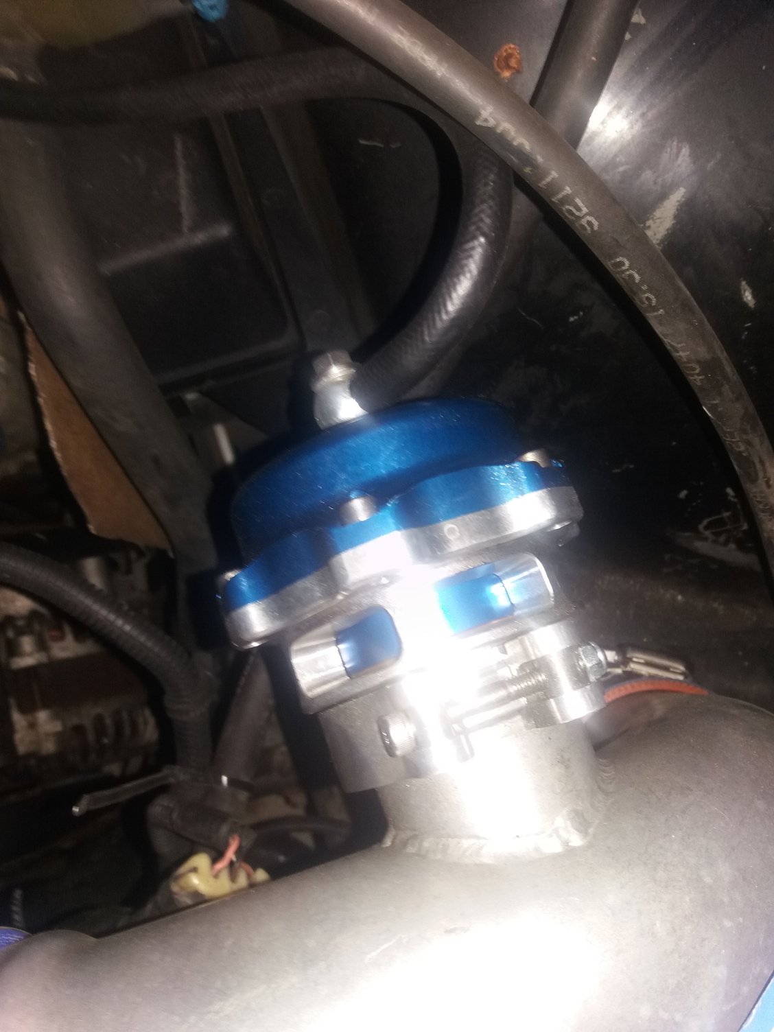

Its a TIAL and if you notice in the pics I can either rotate just the bov or the entire thing including the clap area.

Typically they don't spin. Have you tried tightening the clamp? Take it apart and maybe it's missing a sealing ring or an oring
I havent tried yet but if I tighten it yet, would it spinning like it does possibly cause a boost loss?

yeah tighten it up dude. it has an o-ring seal, but you gotta compress it pretty good

I'm willing to bet the o ring is not in there.
