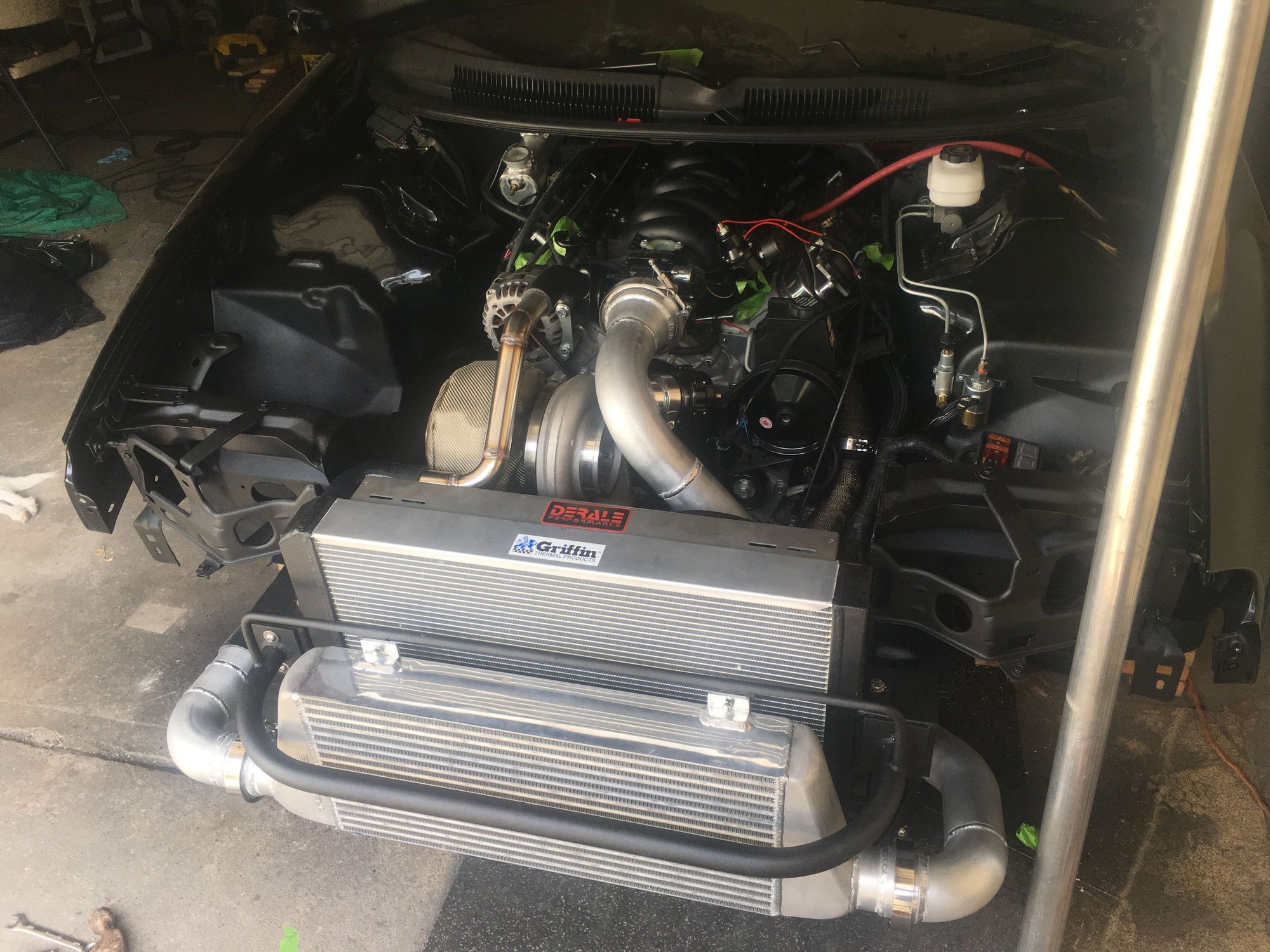

Just some shots of my baby about to be done soon!
5.3 Bored to 5.7
LJMS Cam
S475
8.8 housing is complete just need to press carrier and pinion bearings and redo clutch packs plus order axles.

do u have any pics of 8.8 housing? Did u fab it yourself?

i will take some for you tonight, yes fabbed myself with 9" ends using a truing jig from mittler bros. shortened 3" each side. Used hiltsy mount for TA.

Man that is a clean looking set up. Are you planning to detail the rest of the car I would love to see. If it is half as clean as the engine bay looks itll be a killer ride

Thank you! Yes the rest of the car is very clean and will be detailed. Once she's ready and on her feet ill roller out and have the paint cut.
I ordered axles from strange an hour ago once the 8.8 isnpainted and axles in I'll take pics ... she's not pic worthy right now.
Here is the finished downpipe:
