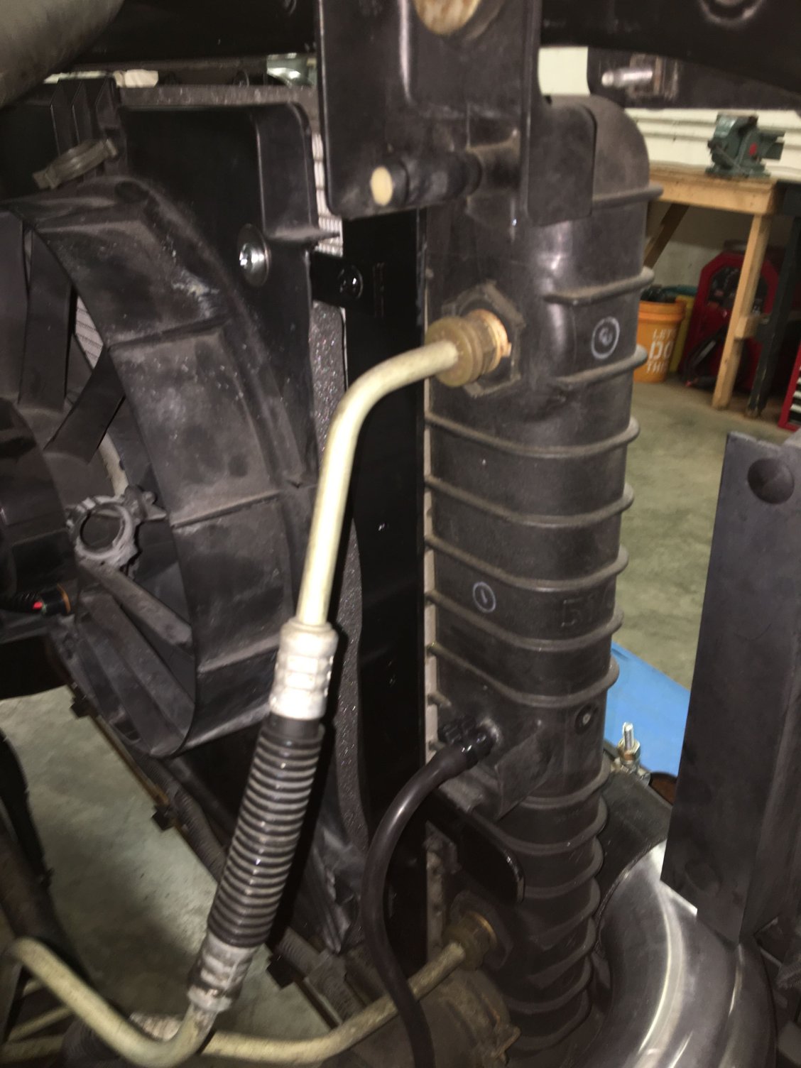

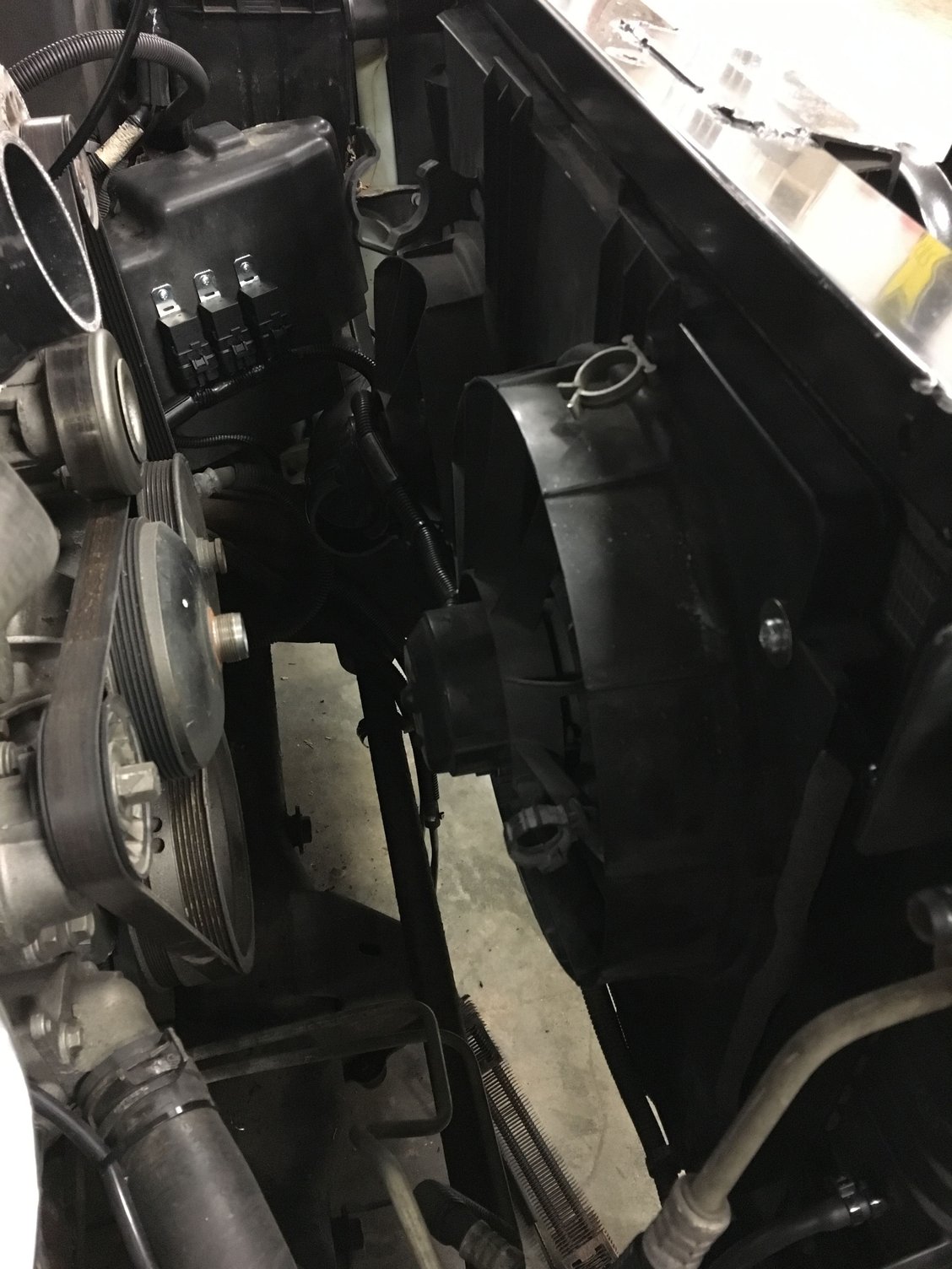

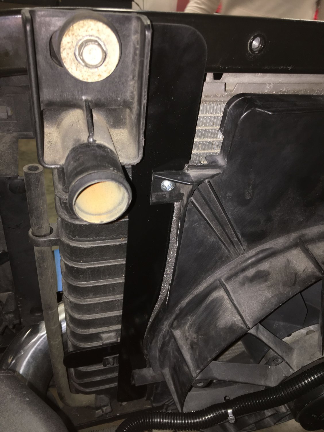

Default Electric Fan Conversion
I got a used set of e-fans on ebay for like $100 shipped out of an Ls1 f-body and the Nelson swap harness. Great customer service and good instructions from Nelson performance. To mount the fans to the radiator, I have a friend who happens to have a CNC plasma table, so he cut out steel brackets that sit in the radiator tabs and bolt to the fan shroud. Came out pretty nice
one bracket
other side
Attached Thumbnails BlueChuChu Silverado Build Thread-img_0408.jpg   BlueChuChu Silverado Build Thread-img_0410.jpg   BlueChuChu Silverado Build Thread-img_0407.jpg
