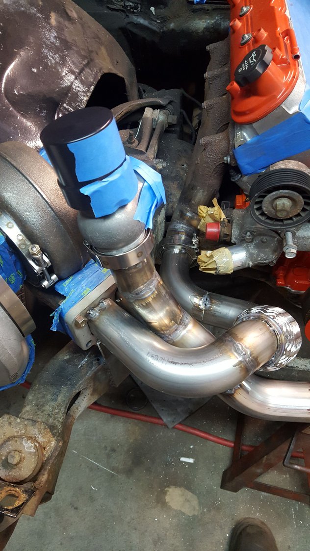

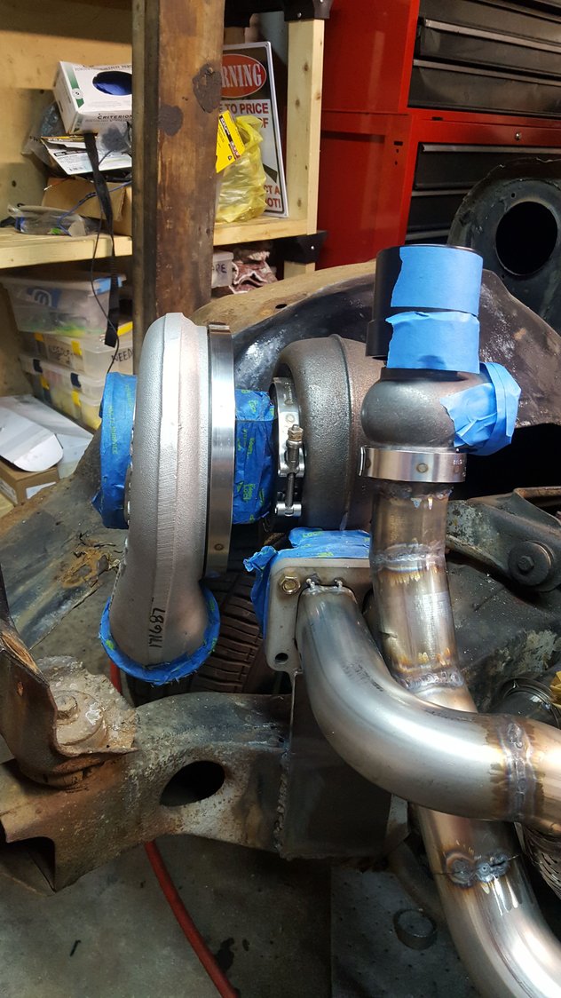

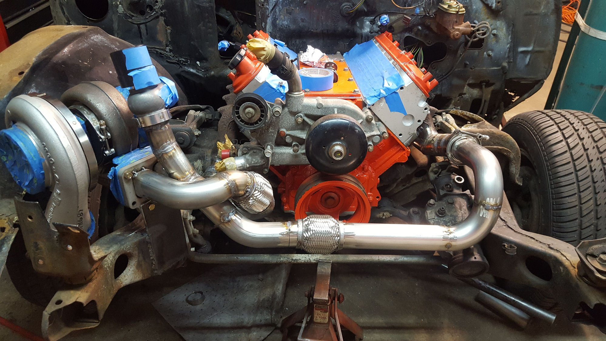

hi everyone,not much of a poster do a lot of lurking and searching but could find anything about this with a definitive answer.
im doing this lq4 wit a s475 twin scroll and was wondering if my 50mm wasegate placement and size would be able to control boost properly.
do i need another? or should i join the other hotside?

If you want proper boost control, you have to gate both banks, not just 1.

i figured that,should i get another gate or will the one 50mm handle both?

50mm will handle both.

On my setup 44mm gate on only 1 bank. I have had it on 2.5 psi with no creep issues at all, its an lq4 with on3 7875. So only venting 1 bank will work for most, YRMV.
However if i were you i simply add another pipe to the other bank and Y it in. Seems like that would be the best option for you and should nearly guarantee smooth boost control

thank you for the response i will "y" it in so i have nothing else to worry about
