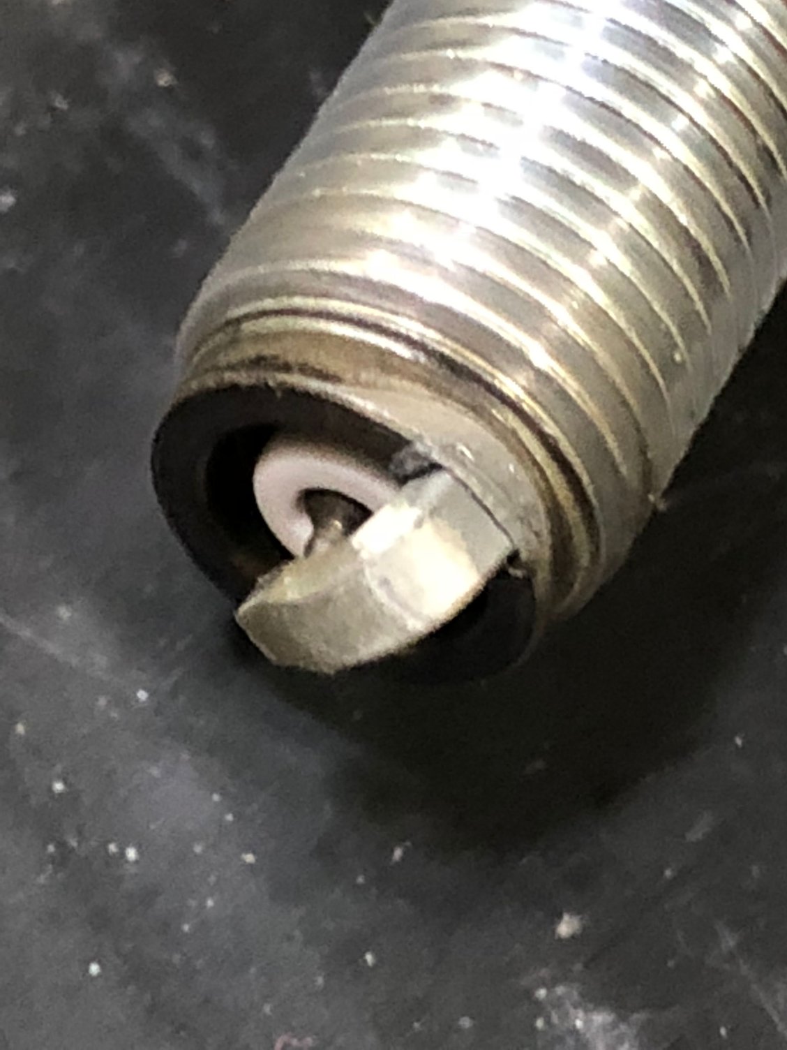

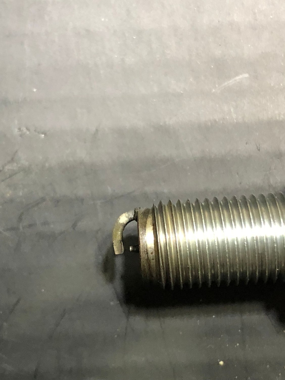

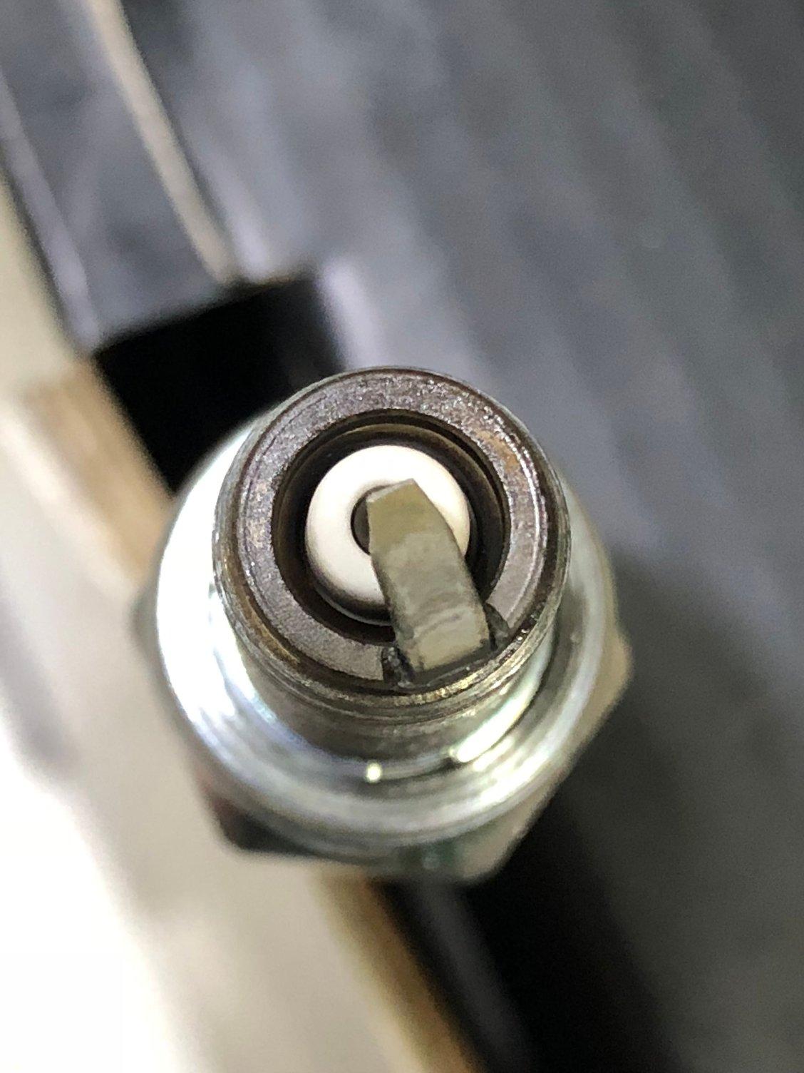

Installed a water meth kit and threw in a new set of plugs to get some extra insight as to what’s going on in the CC.
First question, the timing mark on the strap. Is it where the color change is from the tip to the first line or the line closer to the base? See pic
second, heat in the cylinder. Is it measured from looking at the dark area and how far it moves down the side of the plug?

Timing mark looks good. How many pulls on it?
I usually cut the threads off to look at the porcelain. I can never really gauge heat right from the threads.

I agree on the timing mark. Wouldn’t go any farther though (that’s just me). Heat should be into the second thread. E85 can be hard to see at the base of the porcelain. I’d go hotter plug and pull some timing back out to start. Get the heat onto at least the first thread, if not the second and then put your timing back in it. Again, all just my opinion.

Heat looks good. General - You want the coldest plug that doesn't foul. Timing looks good, at the mid point of bend of strap.
How much timing will you pull at 40psi before you sneak back up? Are you using mph to monitor gains?
Why remove IC? Not working? Water/meth great to reduce CC temp but not much for air temp. Every 50F drop in IAT increases air density 10% (add supporting fuel = more hp) and helps drop CC temp.
