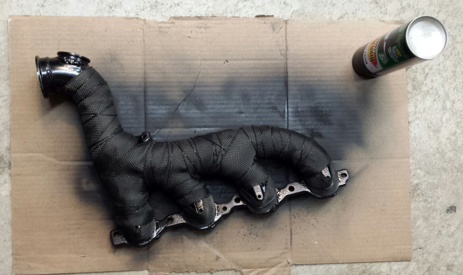

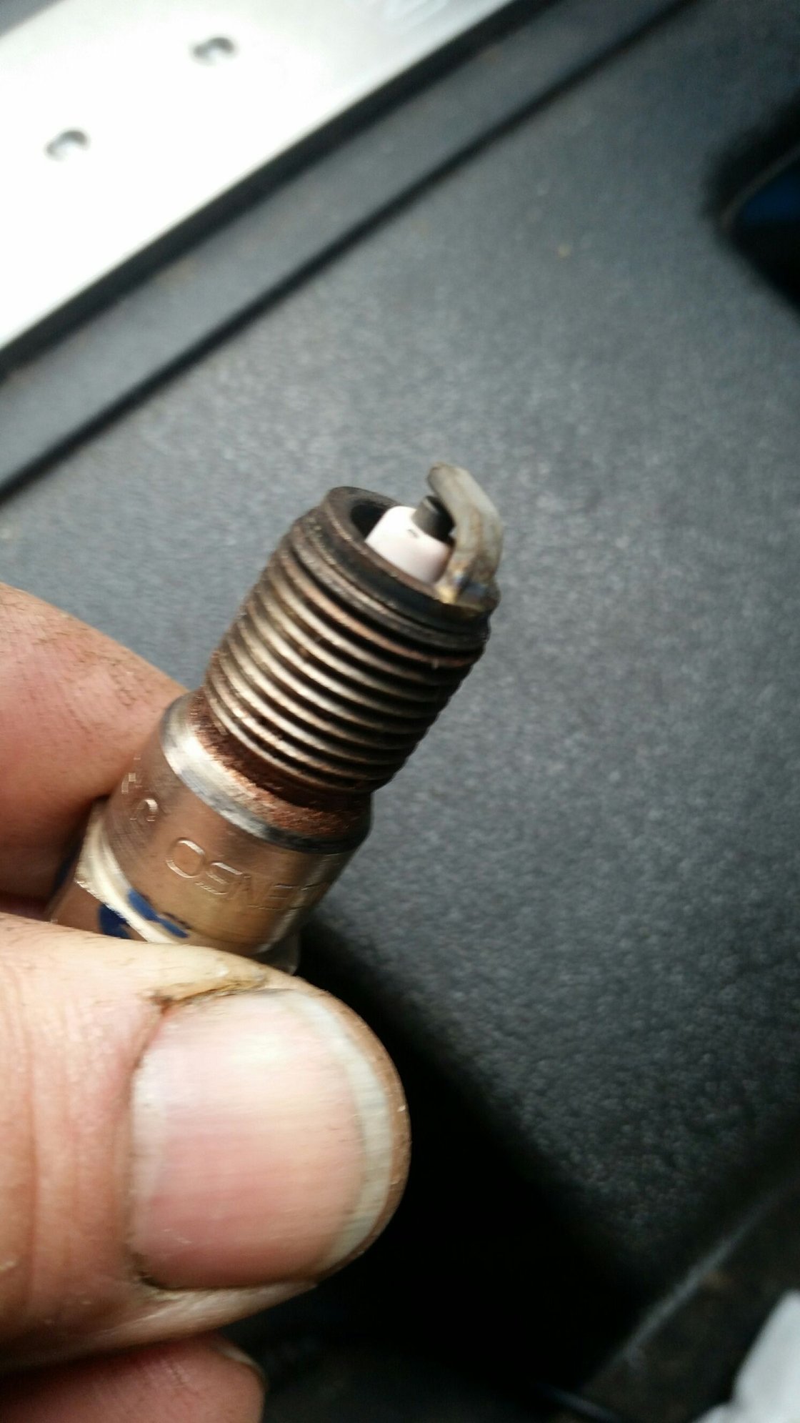

Sure sounds like something is off. 1900* temps would read extremely hot in the plug. That one hasn’t even blistered the cad near as I can tell. Which makes me think it’s likely fine with a false hot EGT reading. You’ll have a clear marking where the cad plating blisters off when it gets close to optimal on the tune. Don’t’ want it getting down past the 2nd thread or to the bend. Pic is about perfect, if slightly aggressive.
Then again I’ve never heard of cooking off heat wrap either. I run 16lbs or so non intercooled on E60 with 19* in my 5.3 and the heat wrap is perfectly fine.
Only time i’ve seen manifolds glowing at moderate loads like you are talking about is when a cam was installed a tooth retarded. Compression check might be a good indicator. The engine was just down on power... it idled and drove fine (aside from glowing manifolds). Might also verify timing as you raise the RPM and ensure it isn’t wandering.

To get a good WOT fuel reading might be impossible, but to get a good heat reading you should be ok. Just toss in a new plug and go WOT. (no anti-seize) Pull plug when you can. Having a bunch of idle/cruise time on it will just foul up the fueling marks, not so much the heat mark on the ground strap.

I'll get some DEI Titainium wrap as the chinese stuff on it obviously cant cope

Looks like fun! FWIW I use the cheap lava rock china stuff on mine. Secure it super snug with .040 SS wire and hose it down good with BBQ grill paint to help seal it so it wont soak up moisture or oil. Has worked really well for me. Stays on for years.
