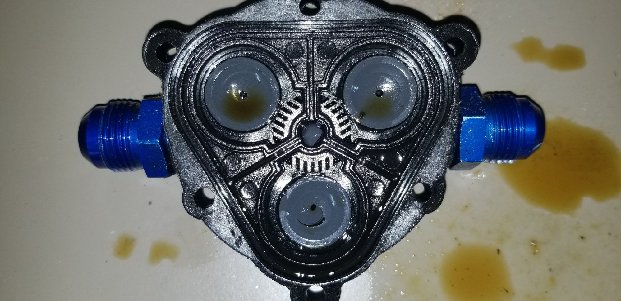

So I thought my turbo laid down on me a couple weeks ago, ordered a new CHRA, installed it..... and while heading to the track the car started smoking again. I thought the scavenge pump was just a simple direct drive with a gear that moved oil, so if the motor energizes... then it should pump, not so. When I disassembled the pump i noticed 3 drives that all had diaphrams, but one had a small tear. Anyone have any experience with this happening, and where can these diaphrams be bought? I googled, as well as went directly to turbowerx...... nothing.

A friends' customers car needed some warranty work and turbowerx had him go through Turbo Technology in tacoma, washington. called them up, told them the issue and they had him send it in, fixed it and sent it back in a week.

Yea, but for how much? One of my track buddies has a new on3 pump he's letting my have for $40 plus shipping. It looks to be a rebranded shurflo, only thing I'm worried about is the temp rating.

couldnt tell ya that but I can tell you the diaphragm design is pretty much identical in the shurflos vs the turbowerx

Turbowerx Exa is not like that.
That's a shitty diaphragm pump...doubt it would ever be a sensible idea for hot oil.
Same idea as most methanol pumps these days, you can buy replacement heads/parts for them ok....or any cheap water type pump.
Most methanol pumps these days are an Aquatec DDP5800 or derivative.

I know they're expensive...but the Exa just plain works.
I've had mine for around 3-4 years now with zero issues.
