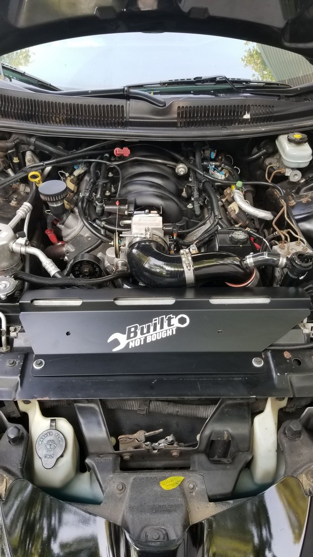

Always fought this on SD tunes. It’s to the point in my “race cars” where I basically eliminate the MAT correction table and tune a little each track visit. Usually temps aren’t massively different so it’s not an issue.
Now I have a “daily” and it’s kick’n my *** again. This car has no IC so it makes it a tad worse/more sensitive.
I’ve got the car tuned great when it’s 85-95* or so ambient. But when I cruise to work in the mornings it’s 55-60*. So I hit AFR safety cutoff (1 point variance from target) every morning. If I add fuel so it runs well in the morning, in the afternoon when it’s 85-95* it’s super rich.
The issue is my IAT is reporting 105* even when it’s 62* ambient. It’s the GM sensor and it’s mounted in the plastic intake right behind the TB and has decent air flow. The turbo air inlets are in the fender and blocked off from the engine bay heat as well. The sensor reads ambient before I start the car so It’s not a sensor issue.
With no intercooler I don’t want to eliminate the IAT in the intake... At the same time I’d like to move the thing to the turbo inlet so I could cruise without farting around with leaning out every morning.
Any ideas?

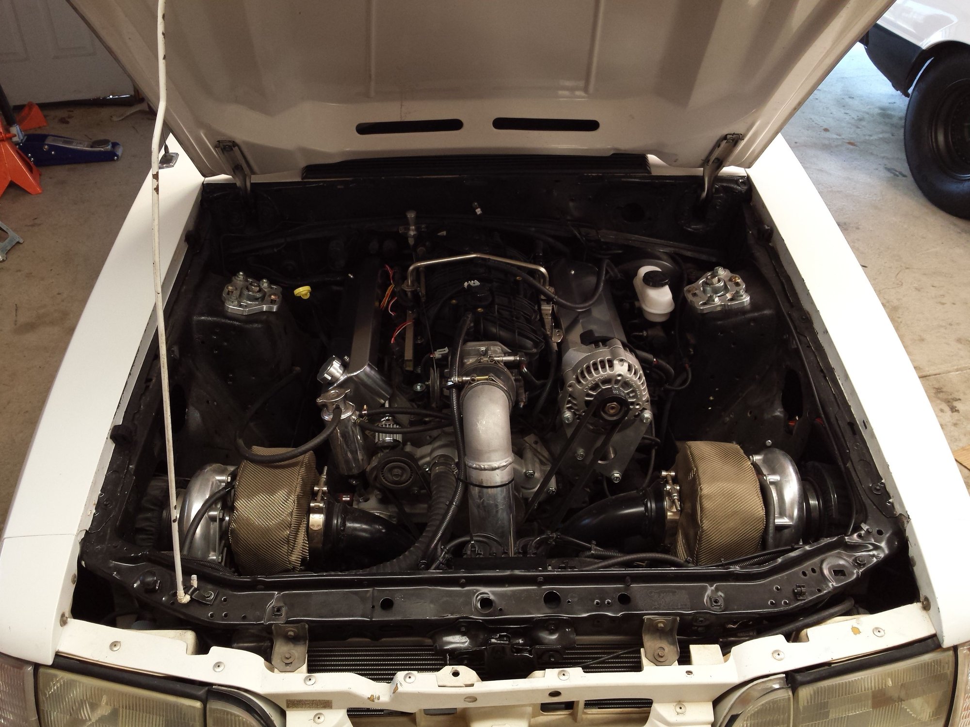

The way I understood it was the plastic intakes didn’t “heat soak” like the alum charge piping or turbo housings. The turbos are in the fenders and are a straight shot to the TB. So I don’t believe the sensor is soaking up any engine bay heat. I guess the turbos themselves have to be sucking in hot air. Just not sure how to isolate them anymore than they already are. Here’s the setup... I used some molded ABS plastic to block off the bay heat.
