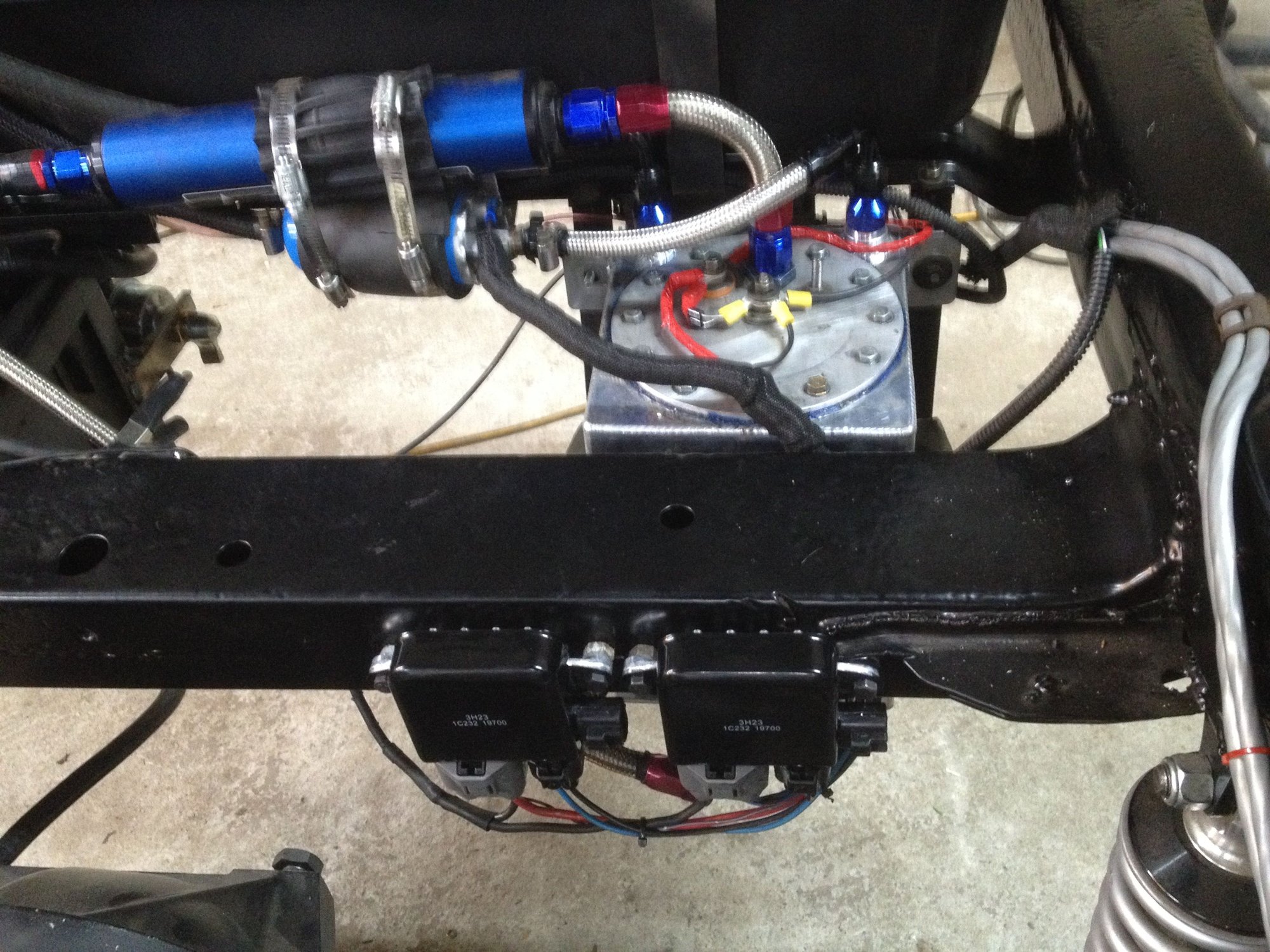

Stock pump external from BMW here. Since it's not doing much, I pwm it to run quieter and lower current.
Some older BMWs have split fuel tanks and have a very lightweight lift pump inside, but the one I use is a standard fuel injection version.

This is similar to the one I have. It can handle stock EFI fuel pressure, but it's coasting as a lifter pump.
