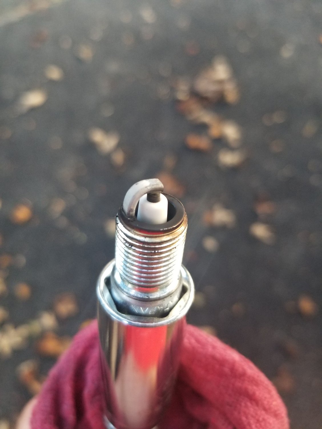

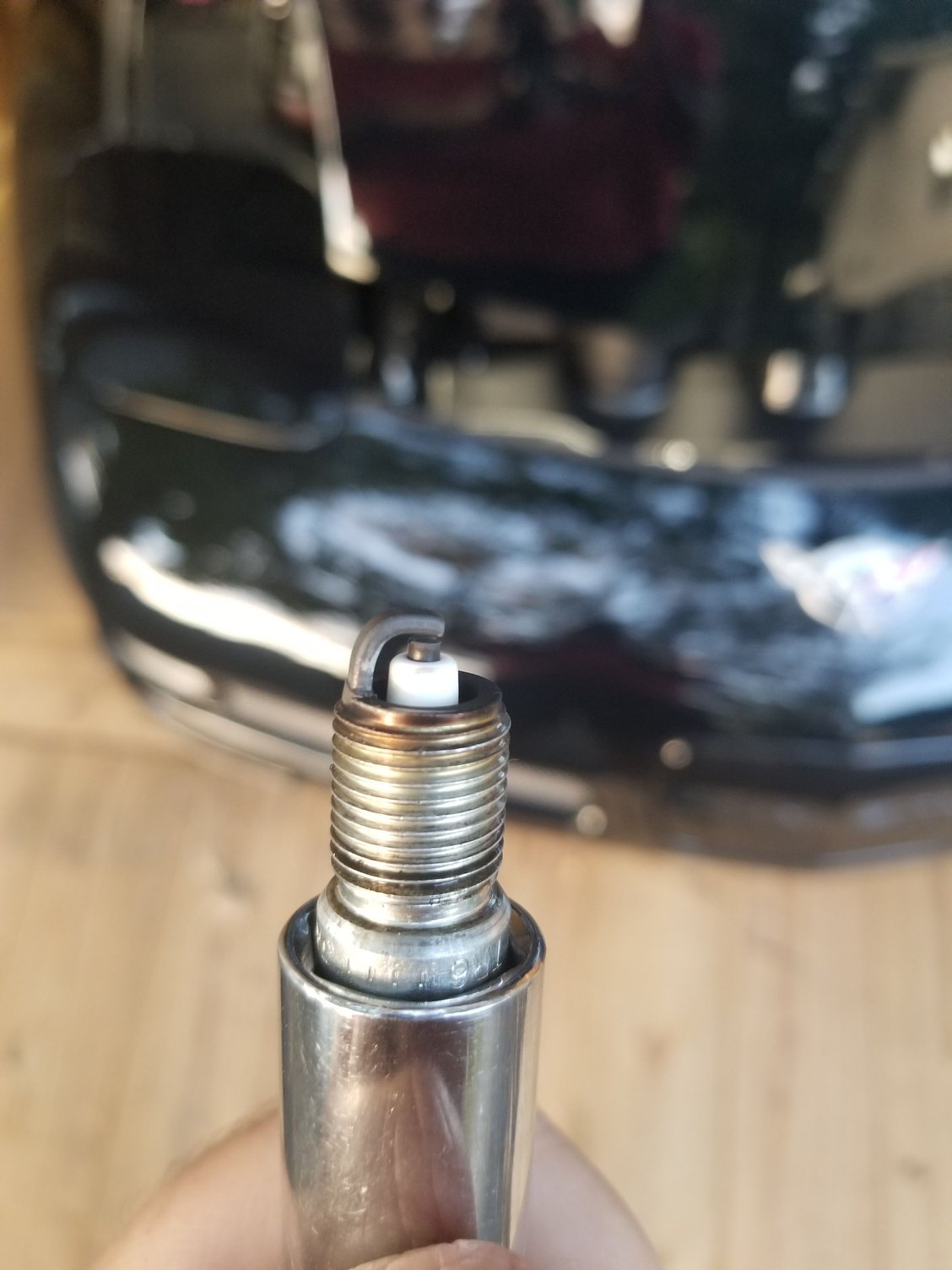

I pulled all of the plugs and they all looked fine to me. No signs of detonation. 2 of the wires didnt feel completely seated when I took it all apart. The MAP is screwed down and feels secure and I couldn't find any boost leaks. I snugged down a few of the intake manifold bolts that took about a half turn.
I fires it up and it seems to be completely back to normal. I will take it for a ride tomorrow and see how it is.
I had to start it for a minute to move it in the garage before I pulled the plugs but here are one from each side. The white on the tip wiped right off I'm guessing from open loop rich conditions

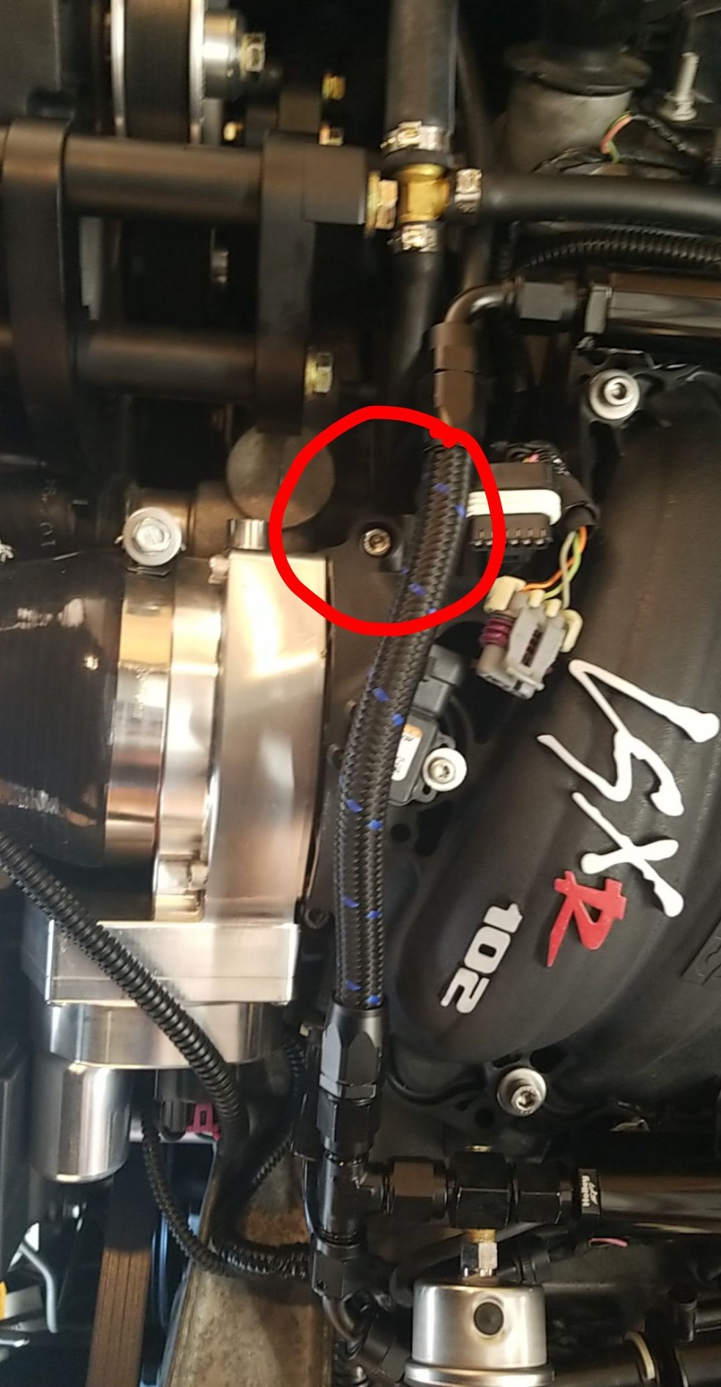

Just to follow up, found a bolt on the fast that was just sitting there. So as it heated up and air was forced in a vacuum leak was created. Tightened it down and the issue is gone. Easy fix for once in my life.

The FAST bolts can back out. Might be worth throwing a little RTV sealant on them or blue loctite. Nothing too crazy since they don't require much torque and are pretty small.

Yup...keep an eye on those fast bolts.
