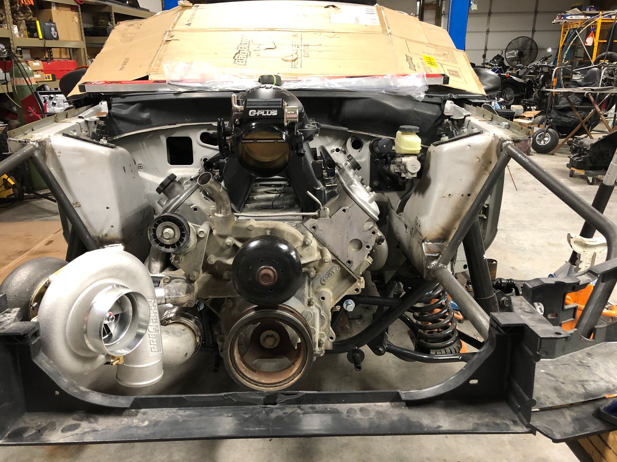

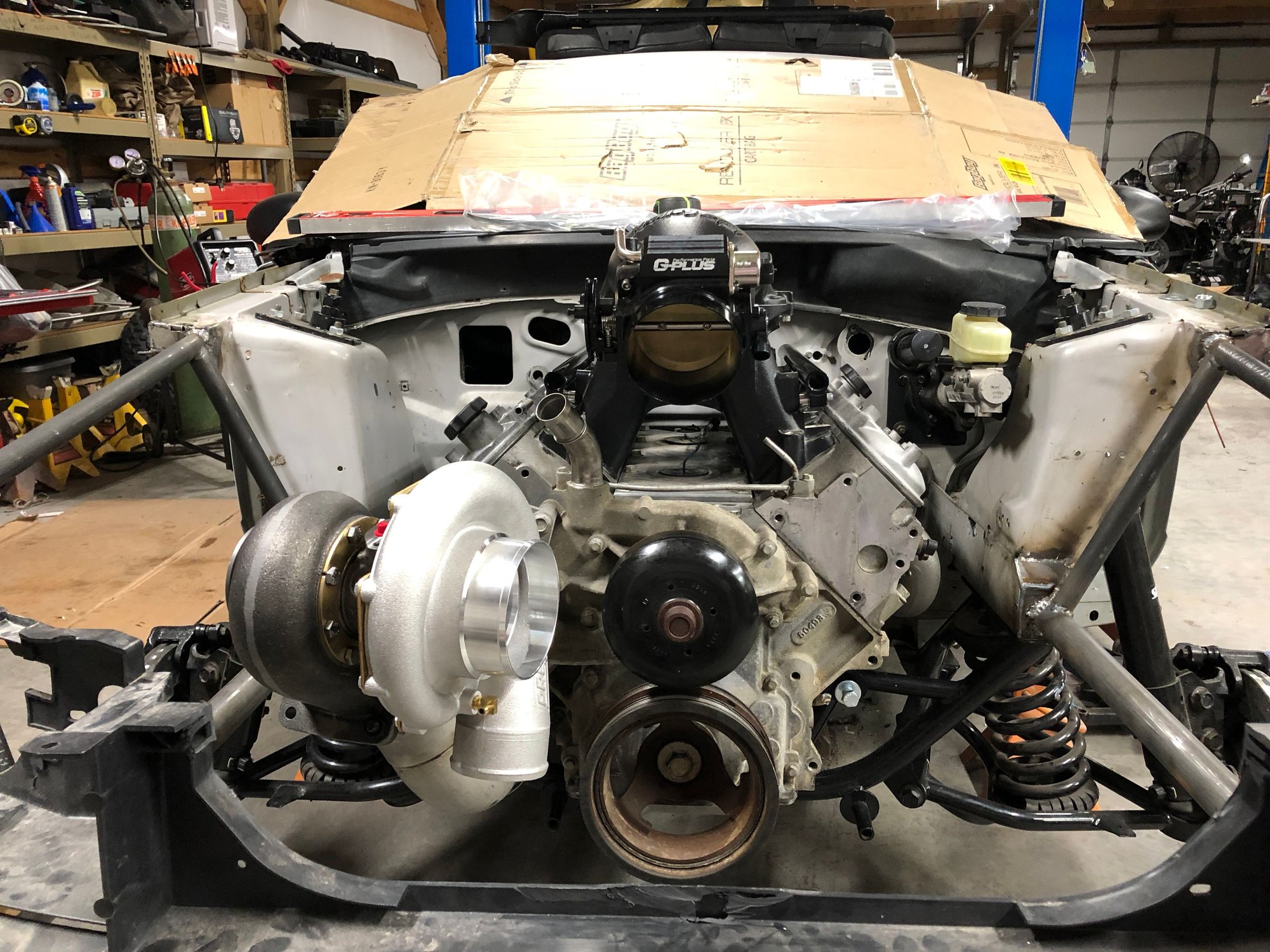

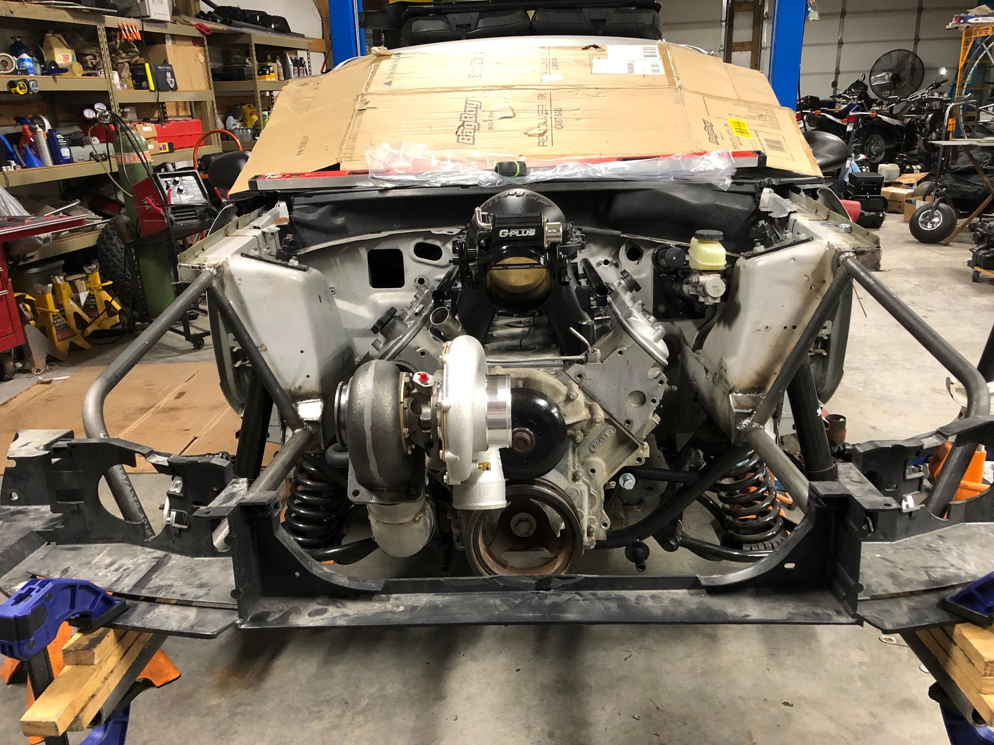

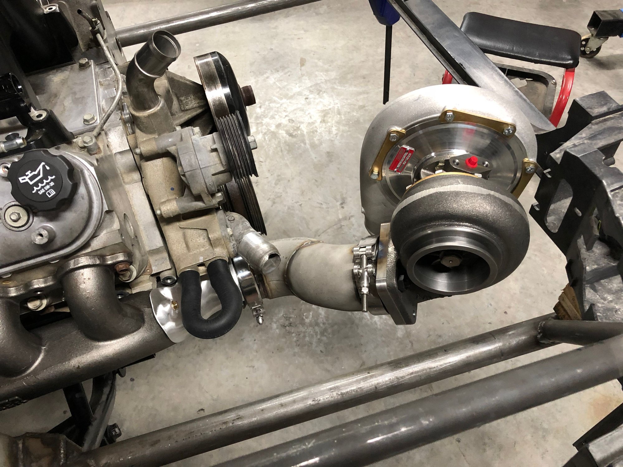

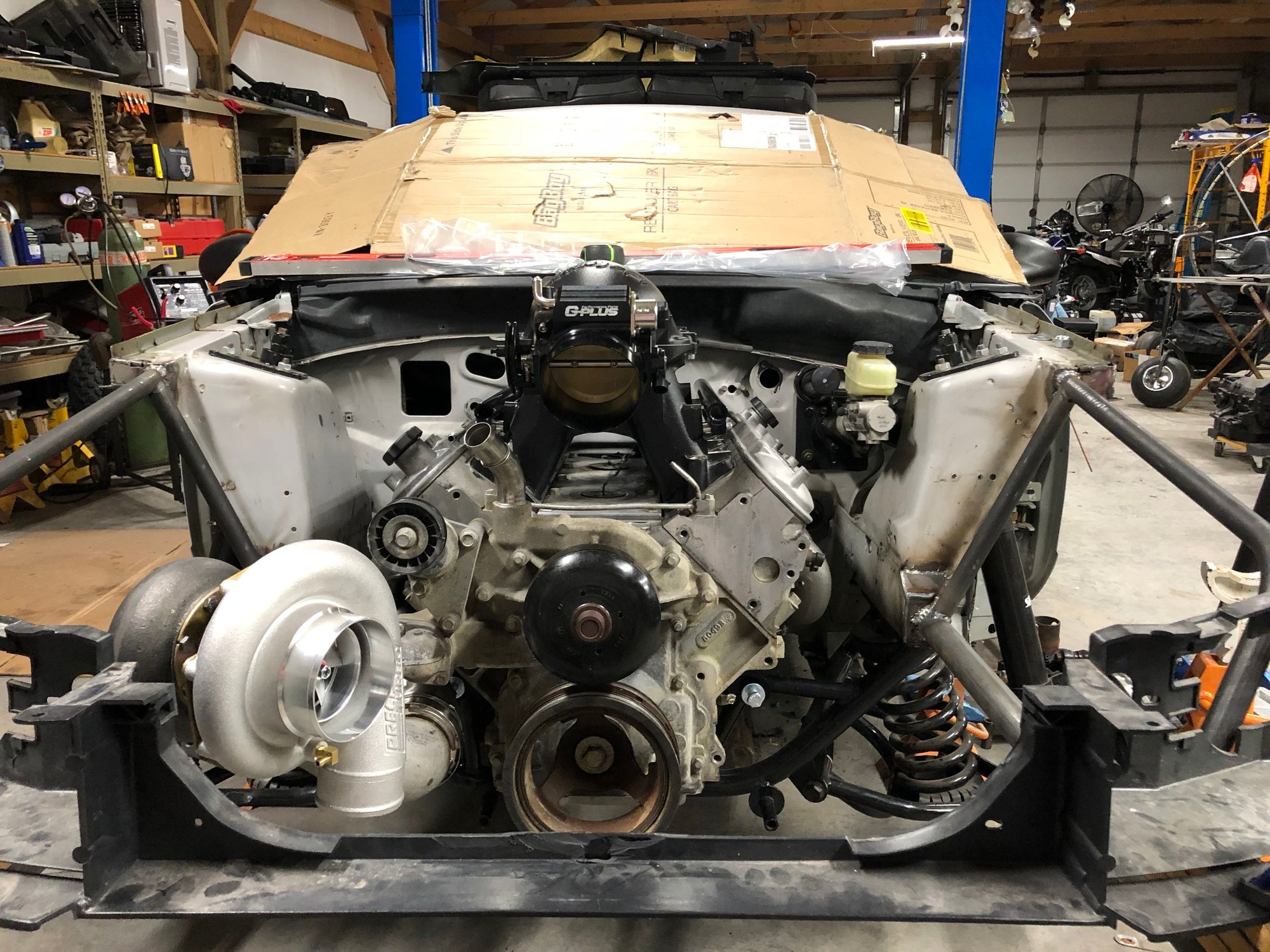

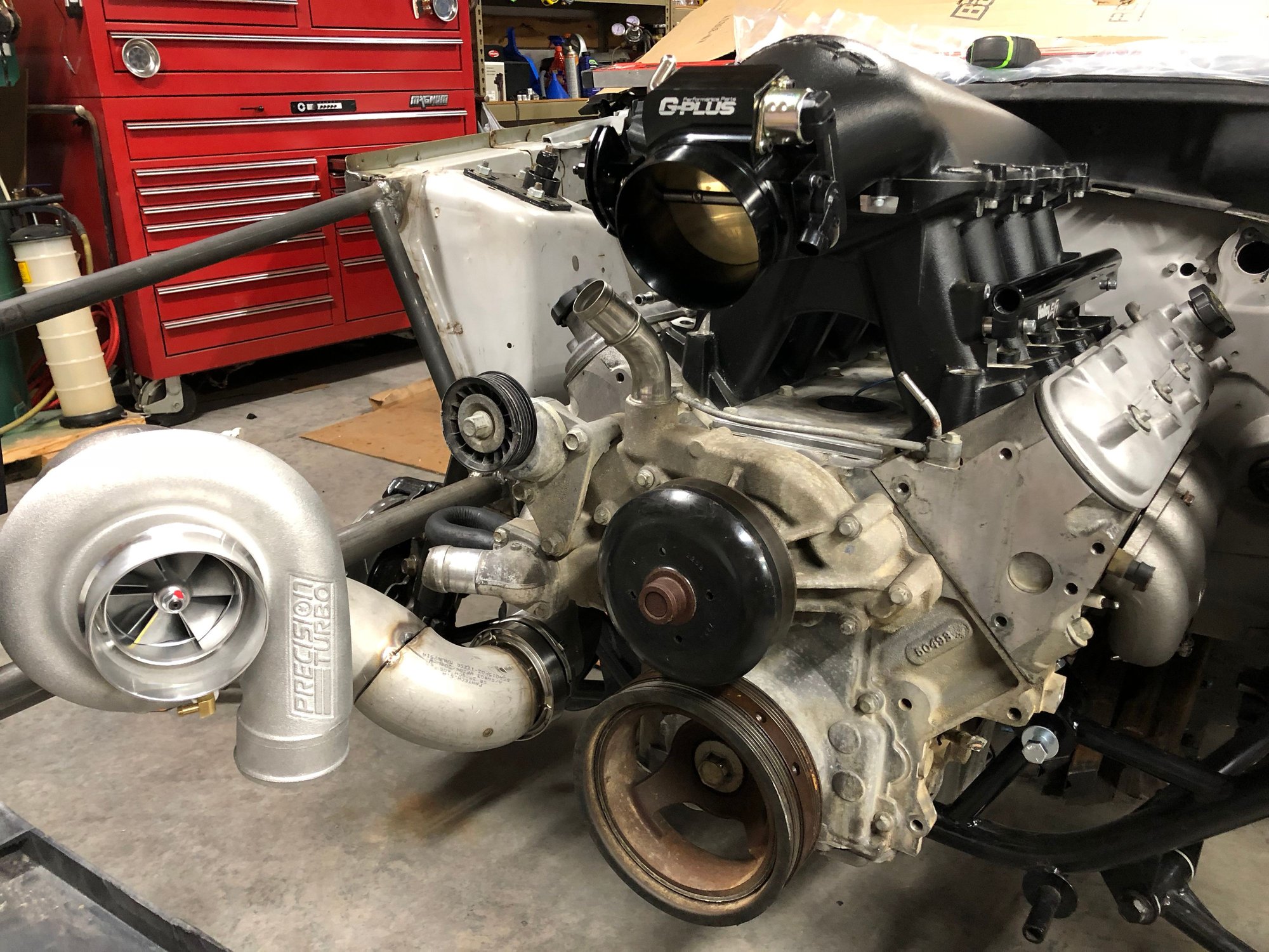

Working through my build, and I stumbled on a neat option that was an unintended deal. I Am using the hooker ls turbo manifolds on my 99 mustang build and I made the stainless go between for the manifold v-band to the turbo T4/v band adapter I ended up with a wide range of positioning options once it was test fit in the car. Just loosening the v-bands and rolling things around give me this range of adjustability and since I had not seem that much on the Hooker manifolds i thought I would share it. No build thread here, just making something searchable about the Manifolds and this mounting technique.

Are you planning to brace the turbo at all?
Old Oct 2, 2018 | 01:12 PM
RIDETOEAT's Avatar
Joined: Apr 2014
Posts: 192
Figuring to come off the passanger cylinder head with a brace to the flange but I doubt this is necessary since this is all schedule 10 1/8" stainless. Hard to see what the difference is in supporting off the flange or the 1/2" stainless plate the flange bolts to, Just take some load off the v bands I am sure.
