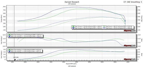

Here is a graph of a S363 on an LS1. 500 horsepower, mounds of torque. Even with the smaller S363, this wont be possible on your 4.8. Power will be shifted 1500 RPM higher and torque will suffer.
The S363 is the largest turbo you should be considering.

Ok the dyno the graph has me sold . It'll be the billet s363 , thats the kind of rod bending torque I'm looking for .

You must've ignored the part where I said a 4.8 won't make a graph anything like that. You cant run a low compression 4.8 and expect it to spool like an LS1 can, especially when you want a stock 80e converter.
