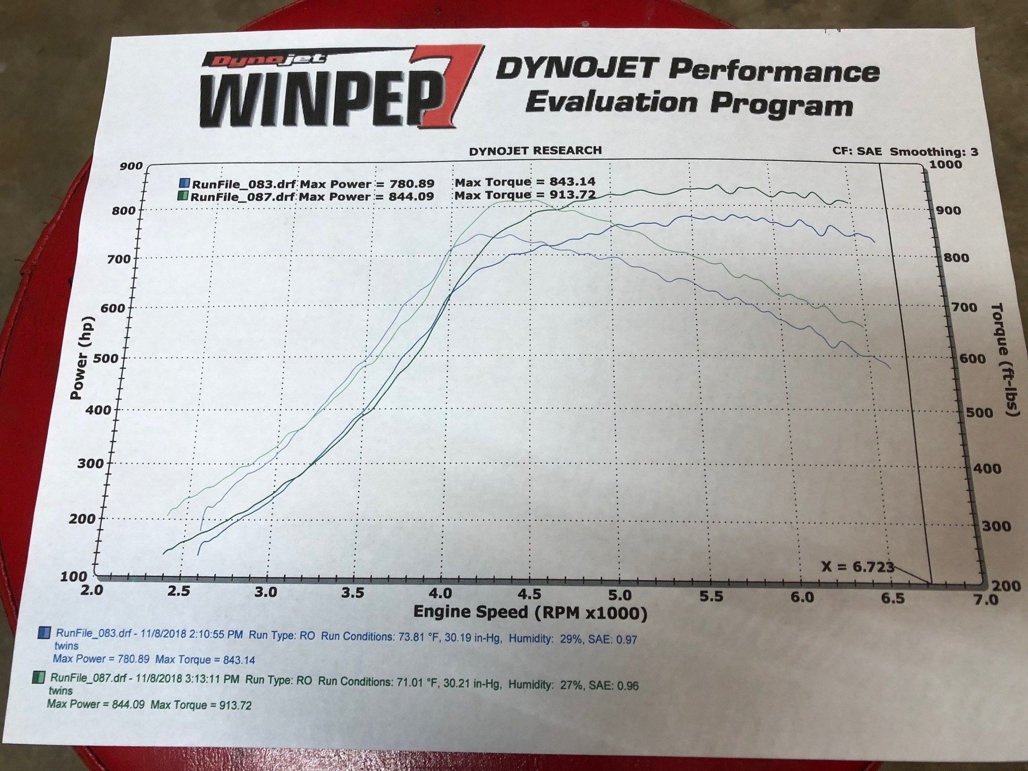

Went to the dyno yesterday and found the limits of the Street Slayer Carbon Billet Twin clutch, but didn’t reach the limits of the single ZL1 fuel pump lol.
Clutch decided that 900rwtq was all it would take lol. I didn’t get to push the car to 18psi like I wanted (I didn’t even play with the timing either). Good results though. Full boost at peak tq and then it fell off a couple lbs by peak power. Timing and fuel was as follows13 deg pk tq 15 deg pk hp) and (11.0 AF @ pk tq and 11.5 AF @ pk hp). So alot left in it from a tuning perspective.
10psi - 780rwhp (10psi) / 843rwtq (13psi)
13psi - 844rwhp (13psi) / 913rwtq (15.5psi)
ZL1 pump @61% DC
Overall, car ran good. Drove home nice, no known issues. Breaks the tires loose from a 3rd gear hit at 60mph!

graph's attached

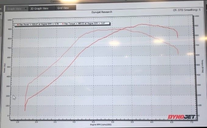

Pulled the Billet Twin and went with the Monster Triple. Got it back on the dyno yesterday and with 6psi springs in the gate, I was only able to pull the boost to 15psi with EBC.
Car ran well... made 926rwhp/883rwtq @ 15psi.
Injector DC was 70% @ 6k rpm (peak power was 5700rpm).
I believe the intake/filters is choking the setup up top... but its fine for now.
These are STD numbers... I'll update once I have the SAE numbers.
Next steps is increasing the WG springs so I can pull the boost to 20psi with the EBC.

Why does it peak so early then fall off a cliff?
Old Aug 1, 2021 | 09:10 PM
RealQuick's Avatar
Joined: Feb 2004
Posts: 3,970
Likes: 15
From: MA
i am thinking it’s the small intake tubes and air filter pre turbo.

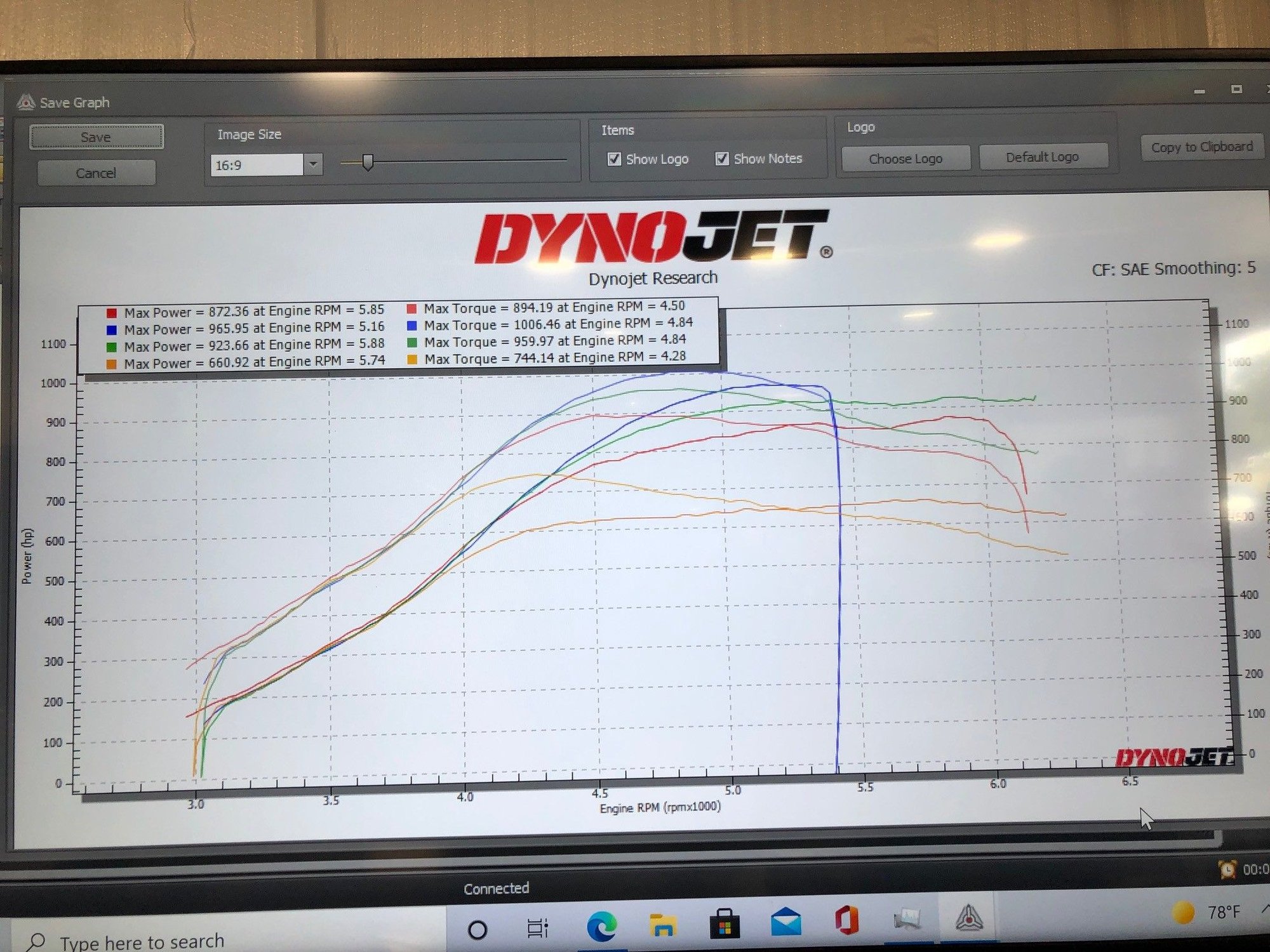

Timing was being pulled due to the temps in the shop... at 15psi I was getting 13.5 degrees timing vs 15 degrees last time. We didnt want to start modifying the timing tables for coolant temp.
Raw numbers weren't bad...

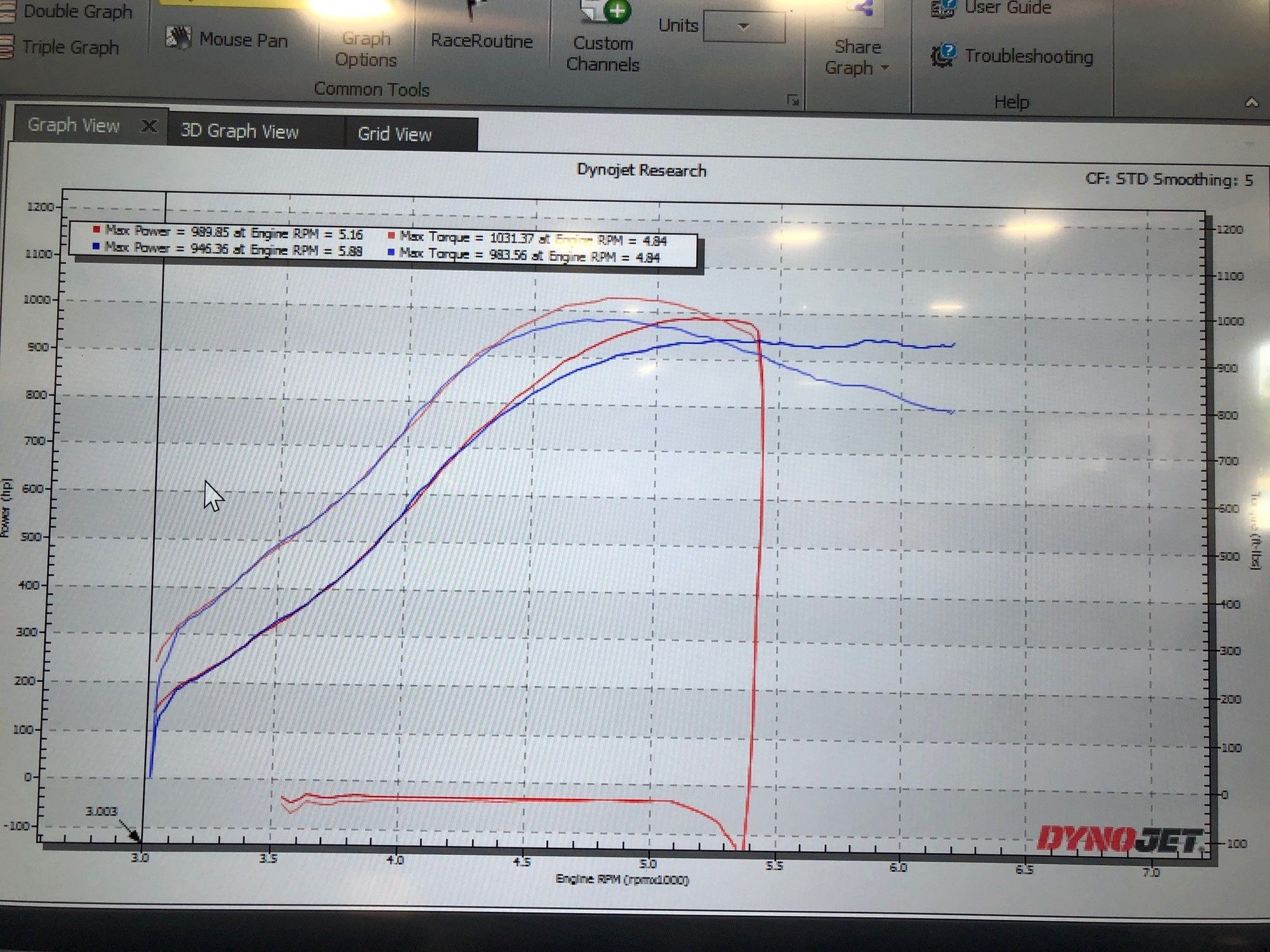

18psi - STD 945rwhp/983rwtq timing at pk tq 12 deg, 13.5 deg pk hp, 11.5-11.8 A/F
20psi - STD 990rwhp/1031rwtq.... but stopped the run at 5400rpm because it was leaning out... timing at pk tq 12 deg, 13.5 deg pk hp, 11.7-12.0 A/F. Injector DC over 80% and fuel pressure was dropping off to 45psi during the run. It wasnt happy as hp peaked at 5100rpm as seen in the graph.
I called it quits at that point as I'll need to address the fuel system... Not bad for 1000cc injectors, FPCM and ZL1 pump. Meth really let me stretch this fuel system.
FYI... we were very conservative on the tune thru all boost levels as well were trying to get to the high boost. So we were high 10.8-11.2 thru the lower boost runs.
Here were the SAE numbers with the conservative tune:
8psi - 660rwhp/744rwtq (wastegate) 12deg/15 deg and 10.8-11.2 A/F
15psi - 872rwhp/894rwtq 12deg/13.5 deg 11.0-11.4 A/F
18psi - 923rwhp/960rwtq 12deg/13.5 deg 11.5-11.8 A/F
20psi - 966rwhp/1006rwtq (partial run) 12deg/13.5 deg 11.7-12.0 A/F
Conservative timing... need more fuel... made about 15 pulls... will go back after I address the fueling. She will absolutely do 1050rwhp @ 20psi for sure.
