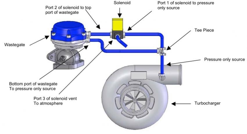

can you link a diagram of the way you have your boost controller routed? This is how I have had the best results with a couple different EBC's

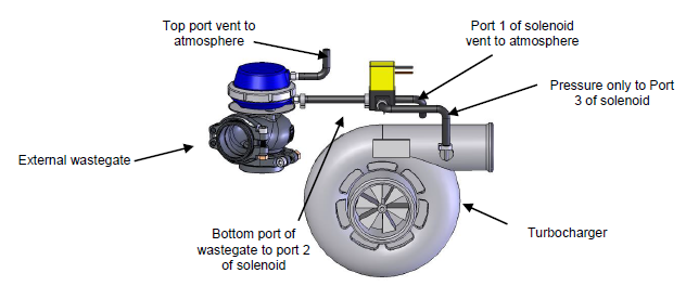

I have been running the basic single port config so far. I was going to change the noid config to the same as the image that you posted above. I have never really wound this combo up before so the control issue hasn't been evident at lower boost levels.

you'll probably have to reestablish your gate opening psi when you change the plumbing, so turn your duty cycle down by half or more until you figure out where full boost is.

Thanks for the advice. I will make sure I back the e-boost off so I can creep up on the boost again once changed the plumbing. I am pretty optimistic that this is my problem so I will report back once I get the results.

Ok, Bit of an update on my Combo, Finally got some time to play with the setup, Re-plumbed the Boost controller hosing as discussed above, reset e-boost to zero and crept up on boost while cleaning up my tune as I went.
Got up to the 17- 18psi boost without the big swings I witnessed last time which is a big win. Timing up top was around the 13 or 14 still, Target AFR is set at 11.5 but still quite rich up the top end of the run with a bit of boost drop off which I'm thinking is the pod filter and the full exhaust that may be killing the top end a bit.
