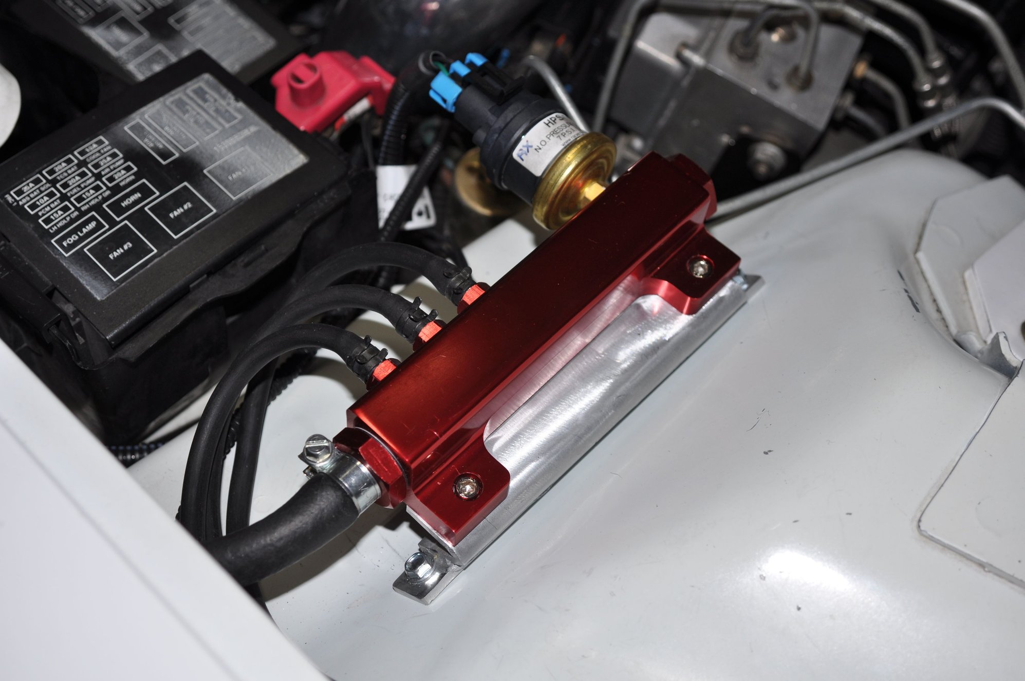

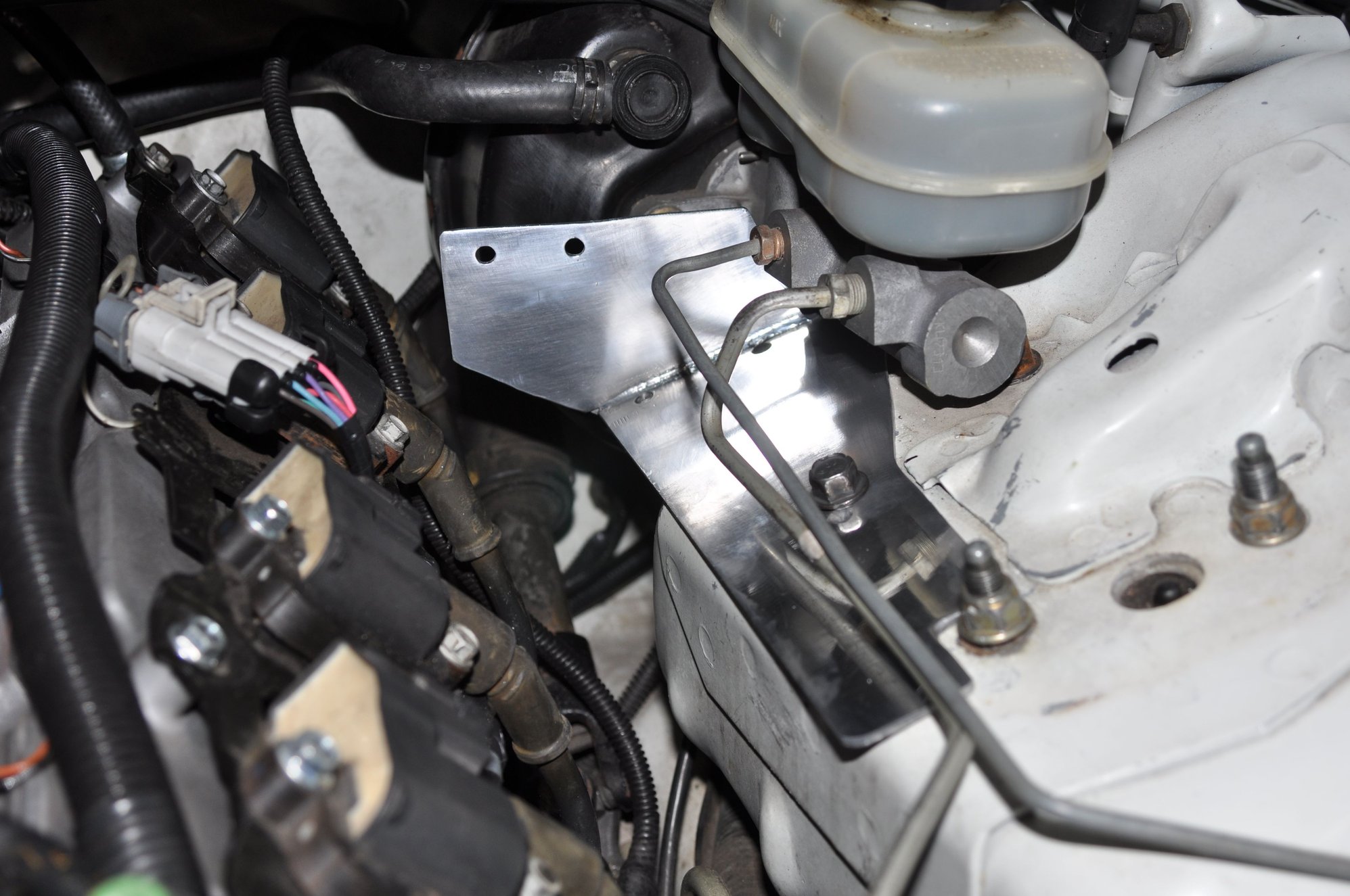

I made my own compounded angle bracket for the FPR and gauge and also for my vacuum block. Gonna tackle welding some charge pipe ends next. The inner sleeve will be far less restrictive than the silicone joints. Great idea.
I used Harbor freight aluminum rods with Map gas. You must use Map gas (yellow bottle) to get the material hot enough to flow. Cleanliness is crucial for a good weld. Use a stainless wire brush to clean the surfaces to be joined for good flow. Don't use the brush for anything else. Else you will just contaminate the surface when you reuse the brush to clean the aluminum.
See pics.
