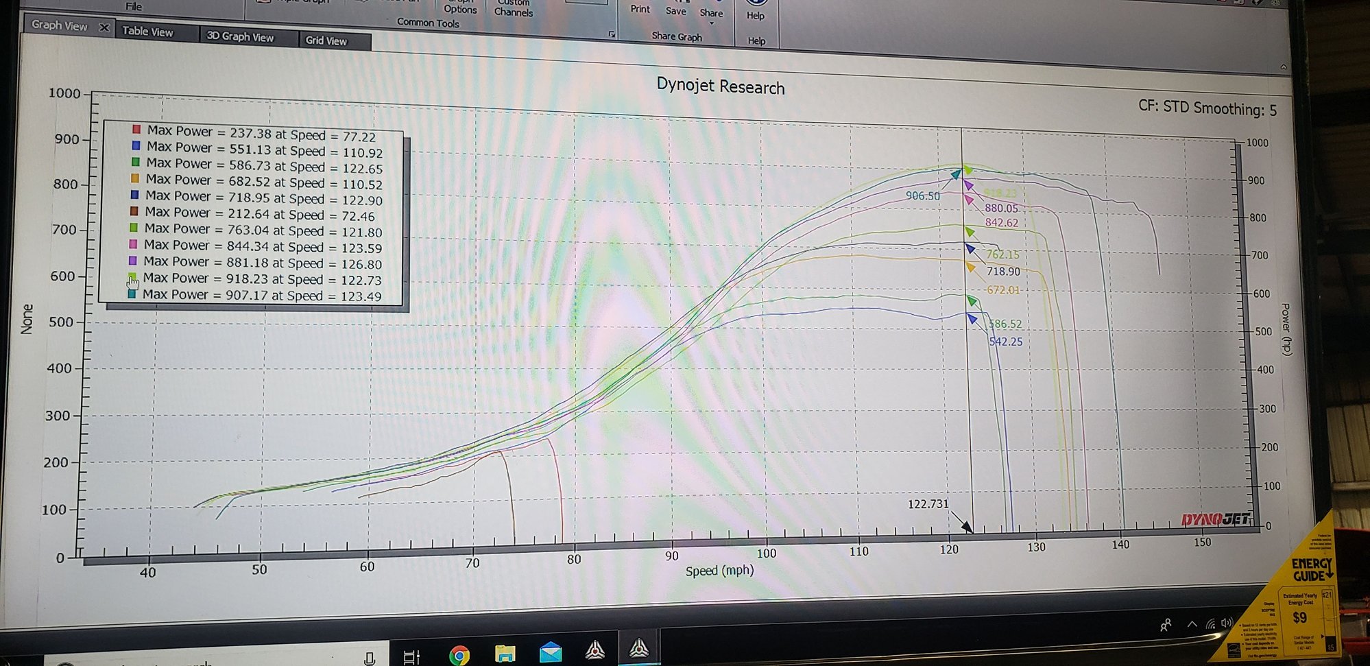

SUM-8715 stage 1 ghost cam works pretty damn good . Look at that curve 🤗

I haven't seen him post a video where he compares a turbo cam, a hi po NA cam, and a blower cam.
Because all this cam naming...is bullshit. Which was his point.
