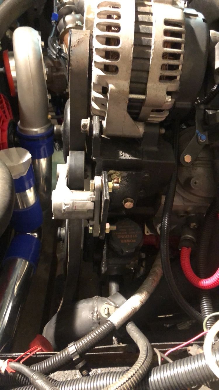

Posting to help give someone an idea if they was stuck like me .

Let us know how it works. The tensioner typically is on the slack side of crank pulley. i.e. not before it drives (pulls on) any load/accessory. Also, spring tension should be strong enough to provide solid belt contact with sufficient travel.
