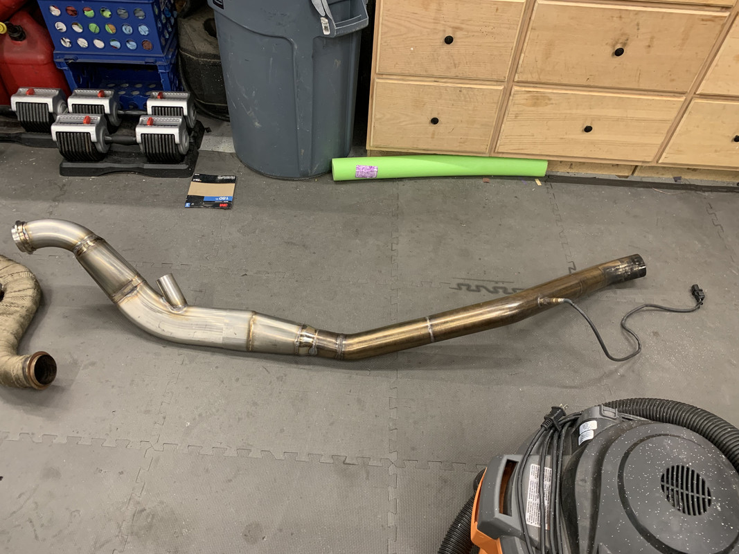

When I built my turbo setup I had to cheap out on some stuff. One thing was the downpipe. I used a 3” pipe that I had to “massage” with a BFH (big frigging hammer) and smashed it to about 2”. Oval pipe was out of budget at the time. But since then I’ve been collecting parts to do a better downpipe. I ended up getting Cx racing stainless 3.5” oval. Do you guys think I’ll pick up and power or spool faster after I build this downpipe? I need so motivation lol.
Heres what I have:
and here’s what I’m gonna use

well I answered my own question. I build the pipe a couple weekends ago. Post pics shortly.
Yes It feels like it picked up power, I even had to retune for it.

I posted this in my build thread too. Pics.

Did you tig all this? Welds look a lot better than the first pipe . I bought a tig welder but haven’t welded anything but thin sheet metal . Dying to try some stainless
Thx. Yes I tigged it. I’m getting better and they looked really good in some spots. Some spots didn’t look as good because I blew threw due to small gaps in the fitment or I veered a little off course. I really need a better hood but can’t really afford what I need to get, I don’t weld quite enough to justify it.
Btw, after I got this tig machine, I sold my Lincoln mig and Lincoln stick welders. Cheap. $100 each. Lol. I’m dumb.

stainless is really easy. I usually fuse it together so i try to make everything fit nice and flush with each other. some people will disagree with the fusing, but I dont care.
1) Ive never had a weld fail because of it
2) I have a welder....so if it does fail...you guessed it....I'll weld it back up!
