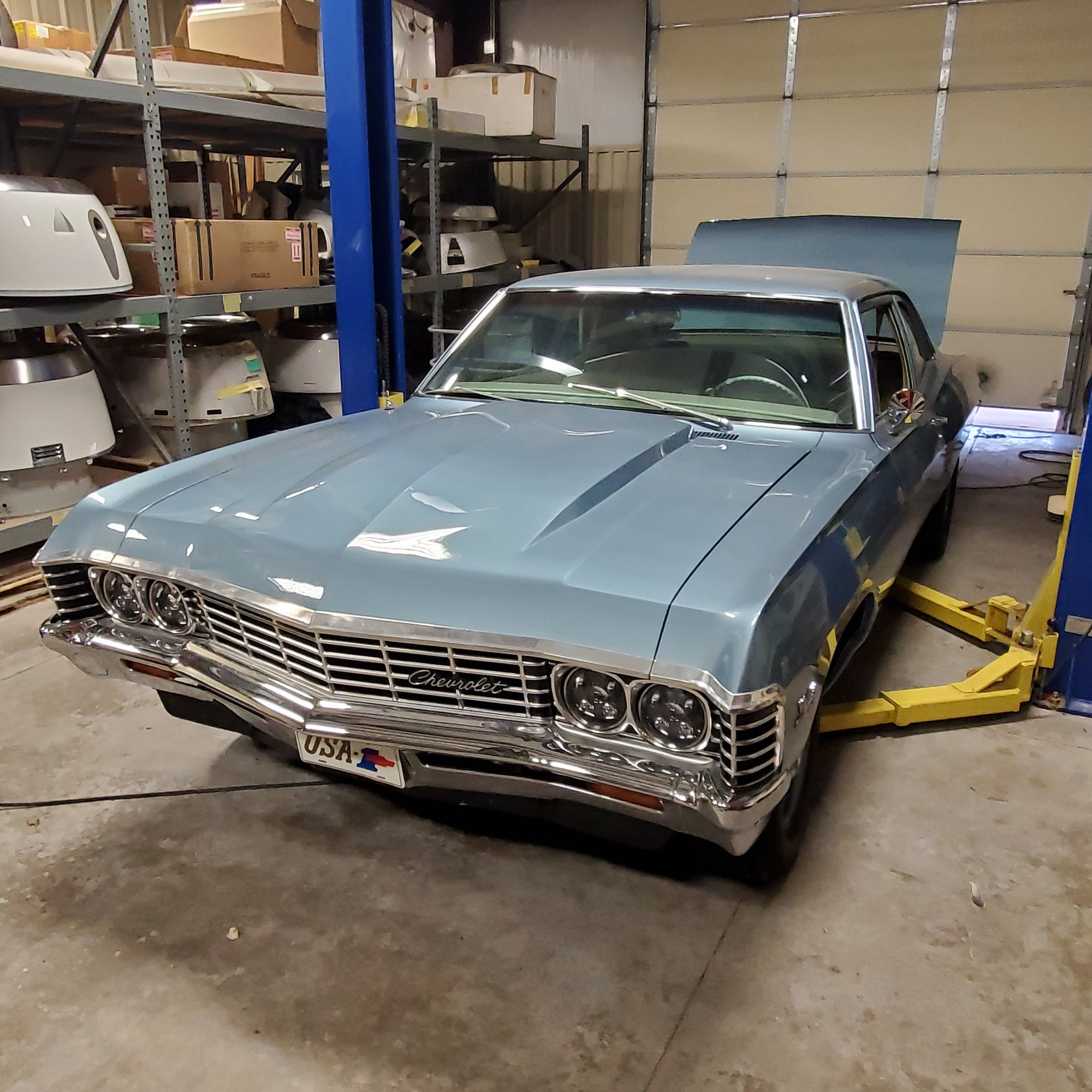

anyone have any ideas on a TV cable/throttle setup for this... LOKAR most likely but is it TPI style? looking for right mount for the cables... thinkinh the 3 holes on the plenum are the bracket mounts but can't get info on what to use - I am running a 200 4R so that makes things trickier with a non computer trans behind an LS and sourcing stuff...

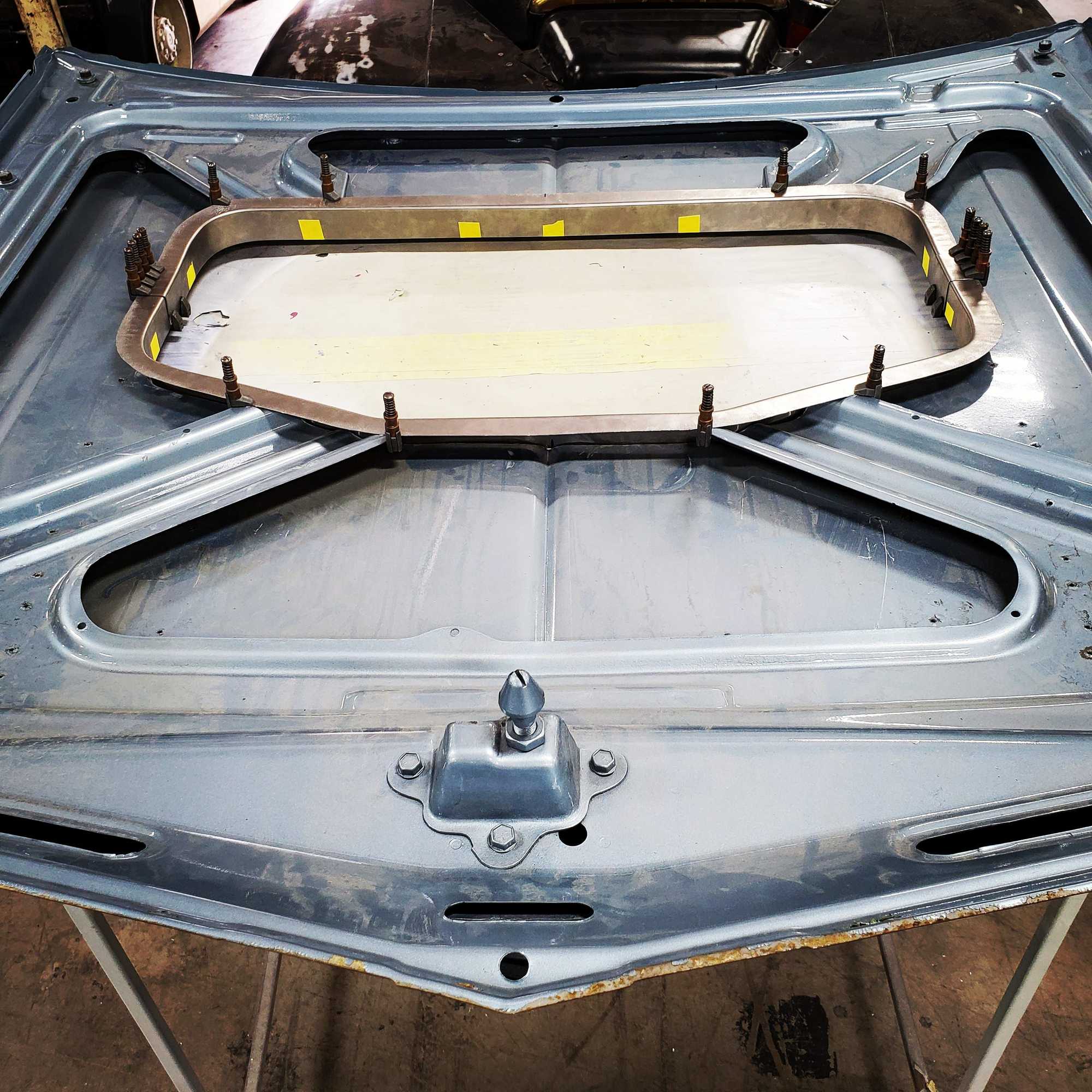

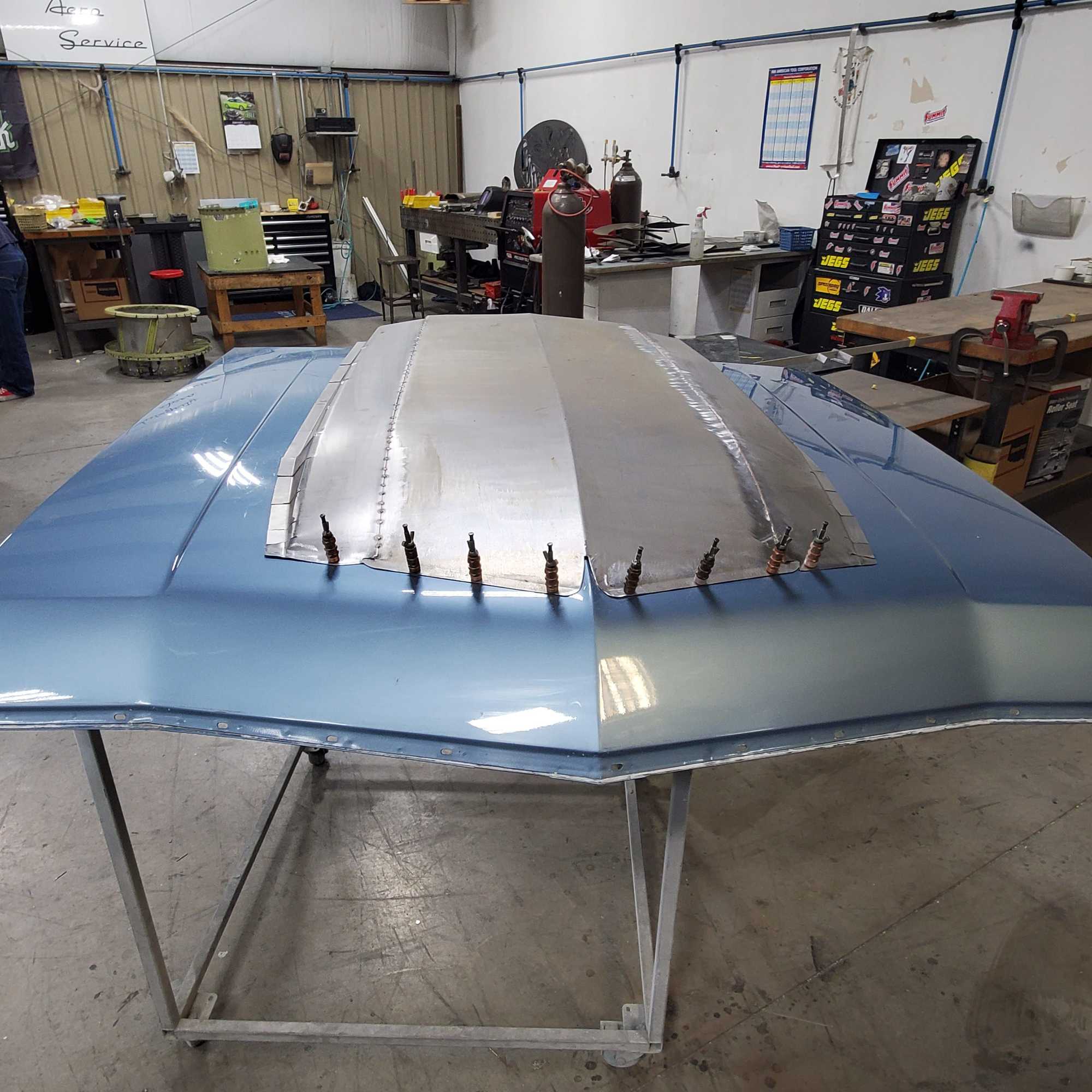

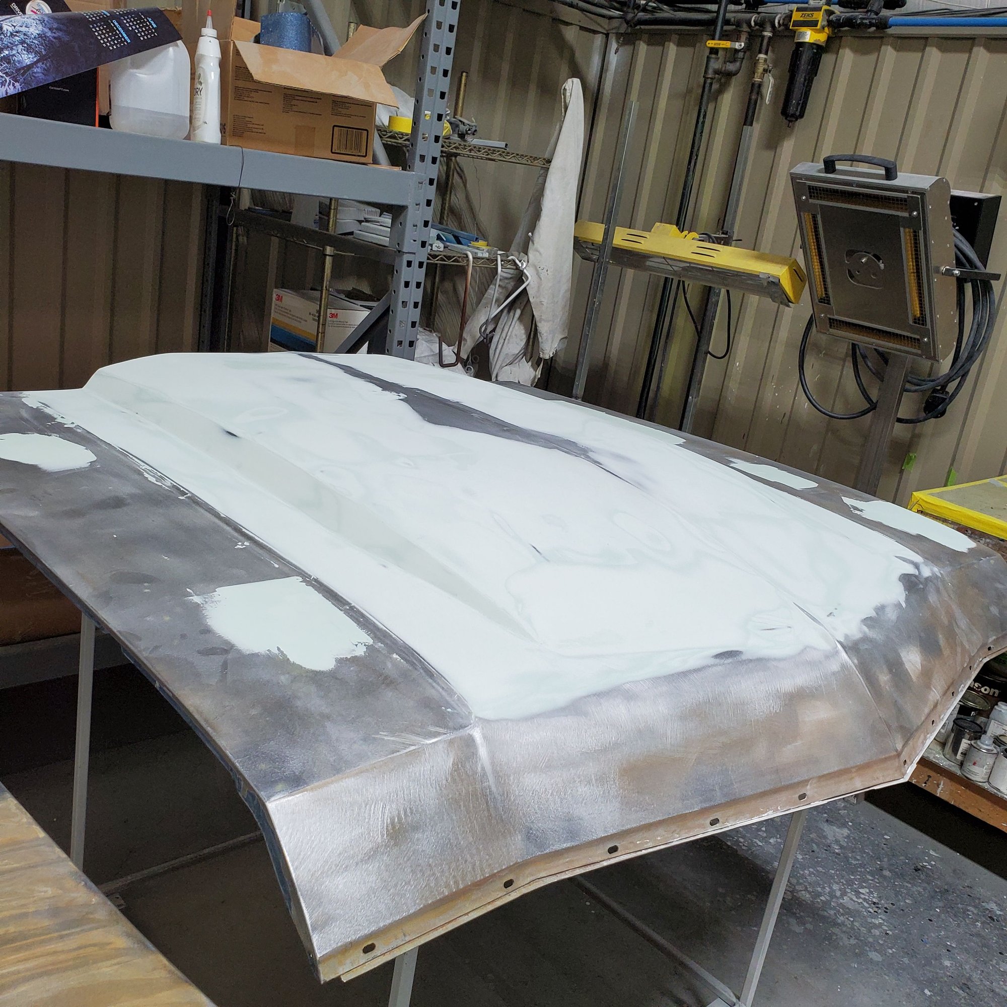

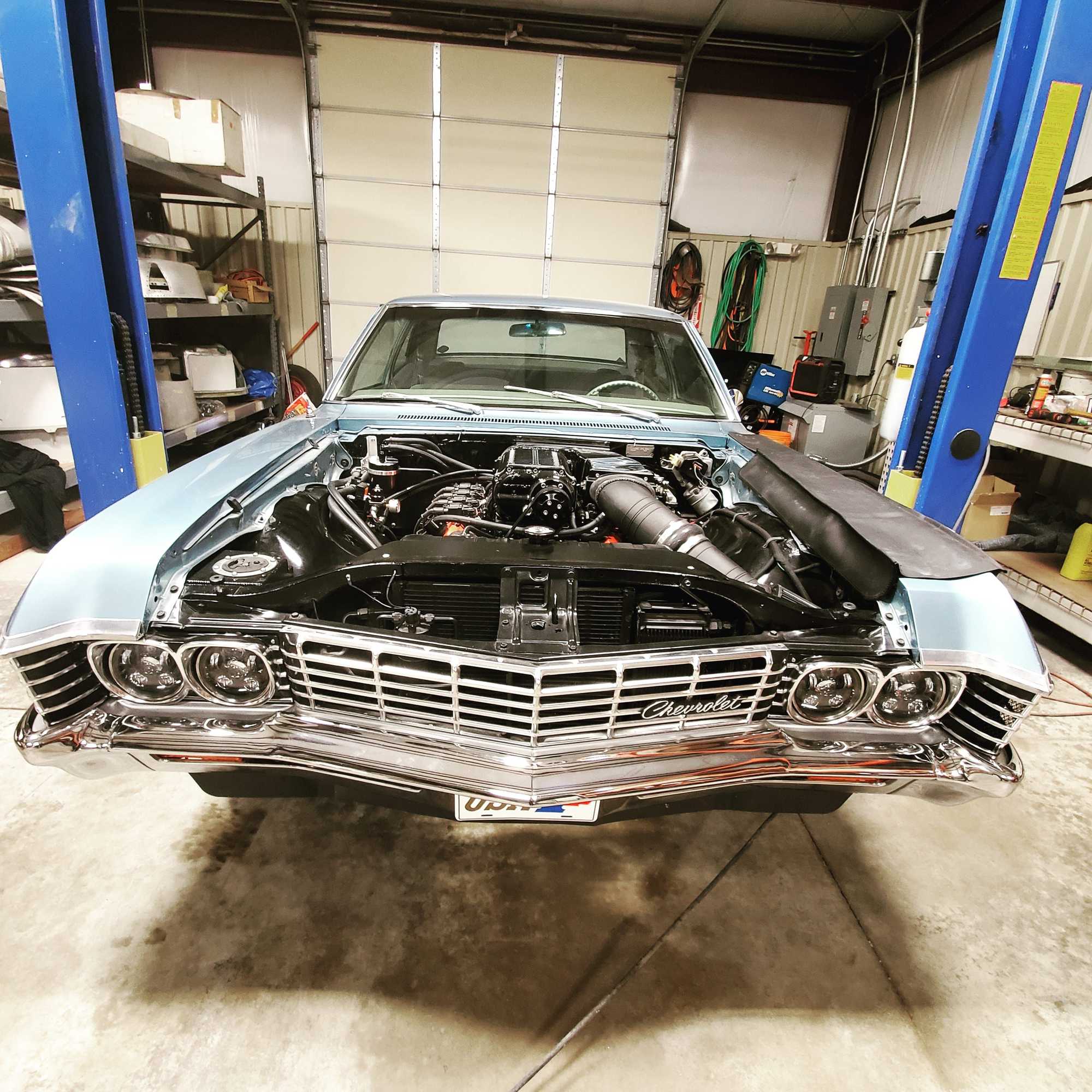

been doing hood fitments - have 2 now - one stock hood ( relieved underneath - and another with a double width steel cowl I made ) - they're in paint waiting on me to get em done - have yet to do minor stuff like a few hoses for the cooling system and the intercooler pump and tank - and a few little electrical hookups and we are done. If I didn't have so much aircraft work in house I'd have been done - but since that's how I pay for it all - I'm not complaining too too much.
It'd take realistically about a weekends worth of work to get it going now - but i'm just doing it at lunch etc a little at a time. have the 4.5 in pulley on for the initial break in/shakedown - going to be methodical and conservative with the setup/tune until I'm comfortable we aren't going to break anything.
scooped hood bracing

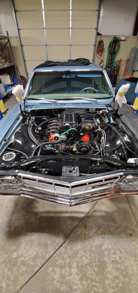

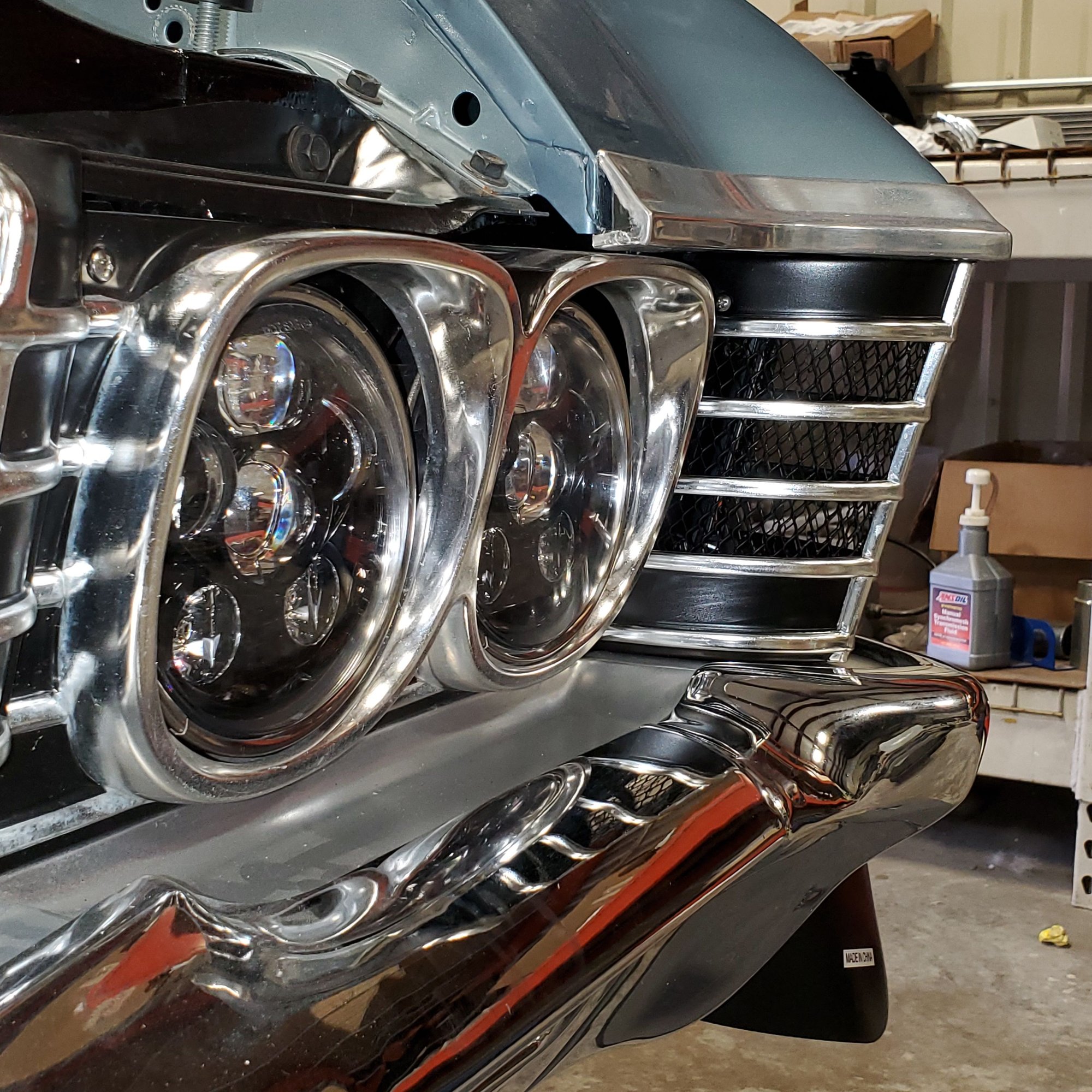

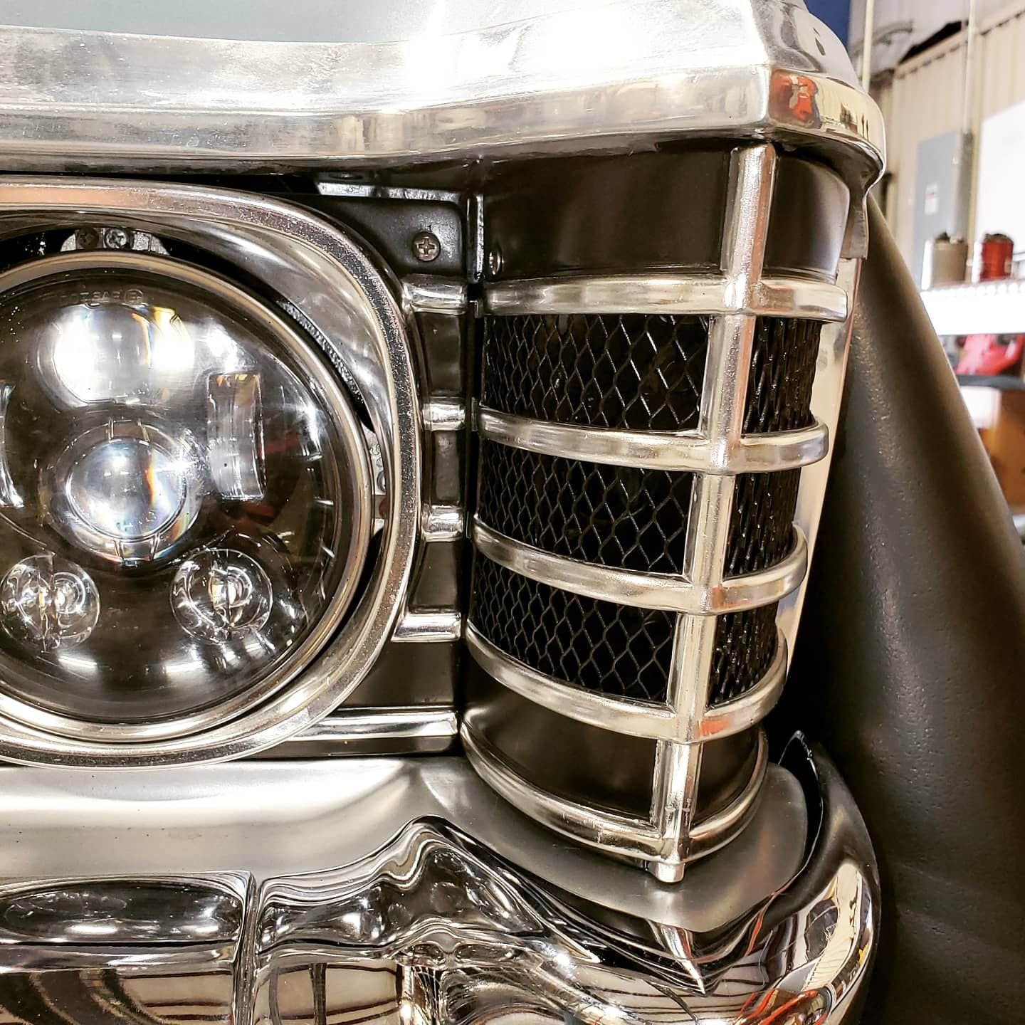

had a small setback - was all fueled/fluids in everything and ready to fire - small issue w the serp. drive - got that cleared up and now going back together - decided to take the corner trim and make it functional as somewhere to get a little air...

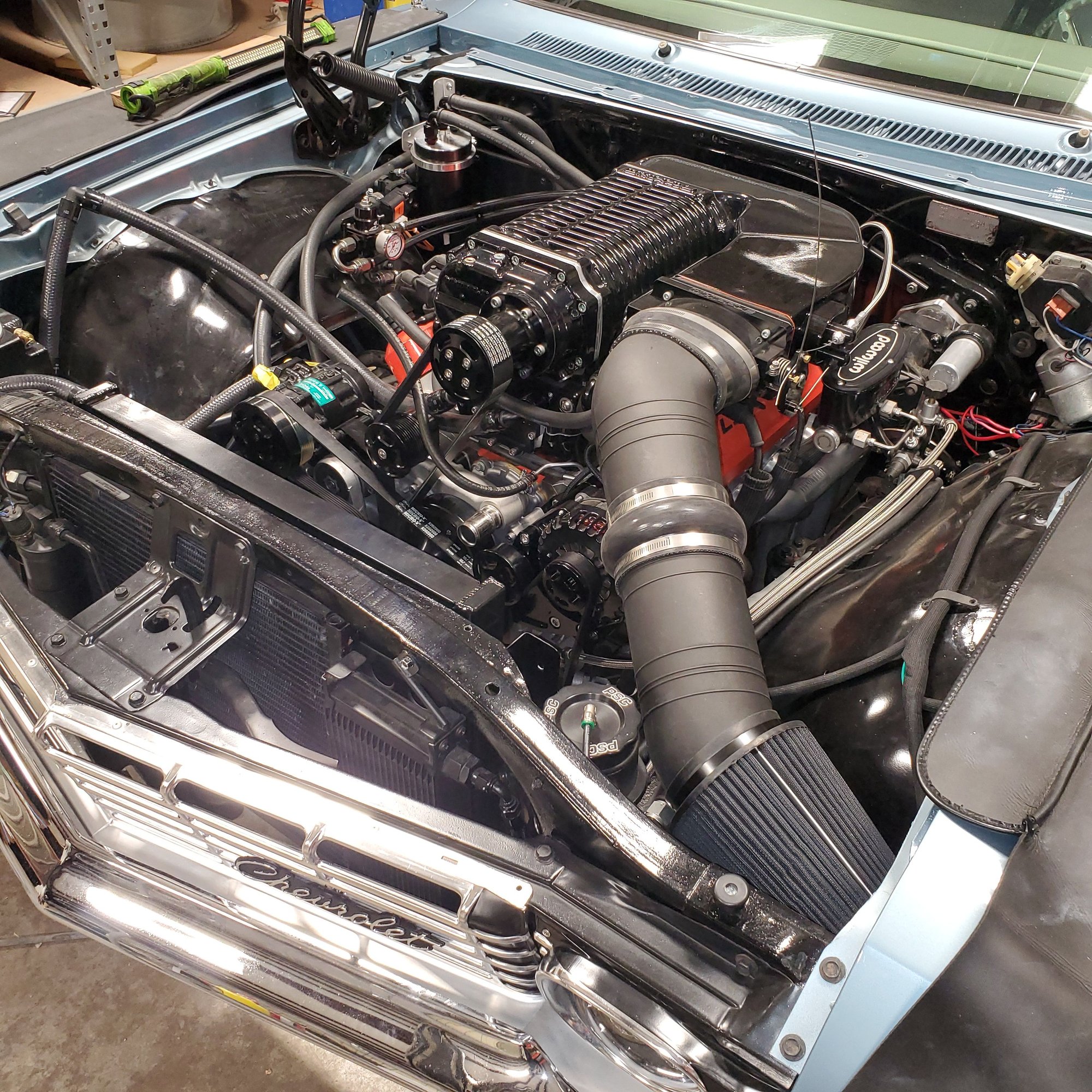

The answer to your question involves probably the most fun hour and a half of my life punctuated by the twisting and cleanly shearing the O/D shaft on the trans. It was built for 1200plus HP - my guy warrantied it - it should be back next week and I'll stab it back in. ( in the meantime - been looking at TH400/gear vendors OD setups - still may do that, I have a cpl other project cars I could put the 2004R into. Back to the details - spent a lot of time learning the tuning aspect - was extra careful and conservative with it before we drove. went for a shakedown drive with the laptop hooked up for datalogging - at times she made 18.5 lbs of boost and it took off as hard from 80 mph as it did from a stop... don't think I can get a tire that small to hold it back from spinning at any speed... ( P295/65/15 MT SS Radials) Never took it over 6k RPM - on the run where she broke, I just hit the rev limiter coming up on a light that turned green before I had to stop, mashed the foot feed, hit rev limiter, went to go again and had nothing but neutrals...!!! but - sitting at the side of the road I made like 4 new friends from folks stopping to look at the car or see if I needed help... there's a plus.
It is much more refined in traffic as compared to the carbed LS3 it replaced - very drive-able - sounds like a stock corvette until you tip in the throttle and the supercharger wails....you immediately become Neil Armstrong on a Saturn V rocket. anyway - I'll be sure and video it - probably once it's back together I will take it to Thunder Valley for test and tune Friday nite and video it there... in a "safer' environment ( safer meaning I'll have my truck and trailer with me! )

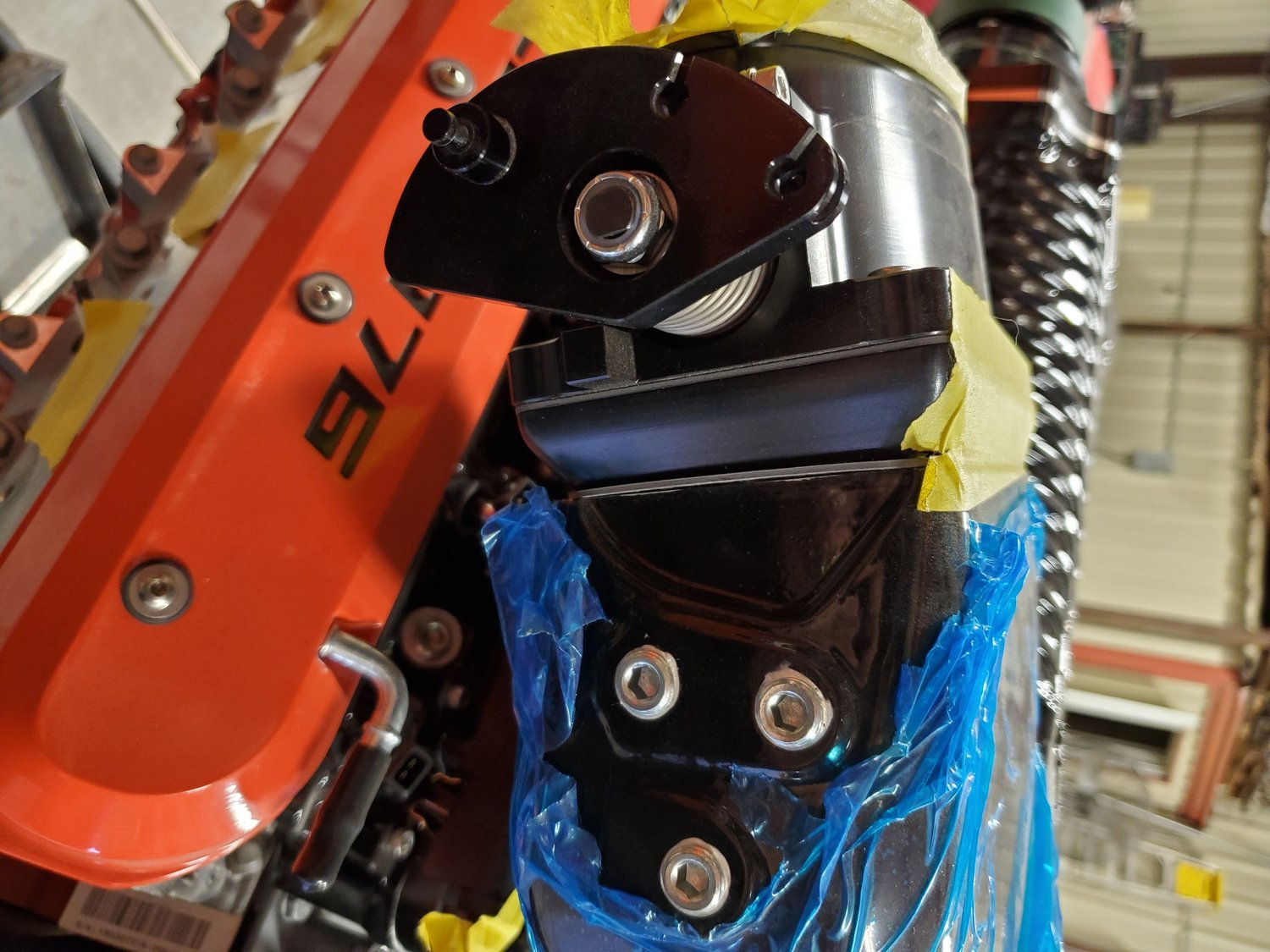

Cool build. In the first few pictures the belt wrap/tensioner setup doesn't look ideal but I could be wrong.
